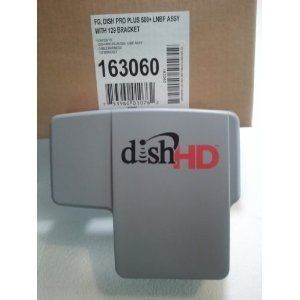

you can now buy a new lnb for 1000+ that requires no switch.
This lnb will fit on a 1000+ dish and you can connect up to 3 receivers.
it has 4 ports but 1 is the input for the external 129 lnb to plug into.
