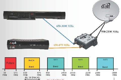

Any idea if an isolator will prevent the isolated receivers from sharing connectivity with the other half of a duo which has IP by HIC or directly to the Hopper on the other side.

I claim those MoCA isolators don't pass anything other than the antenna signals: not Internet nor Hopper nor Joey video connections.

My FSM absolutely argues the contrary on it passing connectivity... I just feel if the IP conn is in MoCA then it will just block all cross node hopper to hopper chatter including conn. He thinks it discriminates. But it's too damn small to do all that....

I'm with TheKrell. I'd put money (but not a lot until we see it in the wild) the isolator is just blocking the sub-950 frequencies from making it back to the node.
Unless Dish is restricing whatever they are bridging from ethernet to certain Moca "channels" there isn't any way to discriminate unless you had a processor to parse the traffic.
I think the isolator will be a band pass filter blocking the 650-875 MHz spectrum.

Then how is the ip conn communicated to the other recs? In what frequencies even?

I think CAT5 is probably the standard networking cable which is rated for 100MHz. The blocked frequencies of the MOCA are well above that.
harshness said:
Has it been determined what MoCA channel/frequency DISH is using?
650 to 875 MHz
Sent from my fingers.
According to the training document I have linked to below on page 12:
You will see that the setup is using isolators. When it comes to having a duo node and two hoppers with no isolators as seen on page 11 you only need one internet source and the Hopper that is connected is sending the internet connection over the MoCA frequencies to the other Hopper, since on page 12 it has a separate internet connection on Hopper two we can deduce that the internet connection is not shared if there are isolators in the mix cause again it uses MoCA to communicate with the Hoppers/Joeys and since that range is getting blocked the internet connection is also getting blocked.
