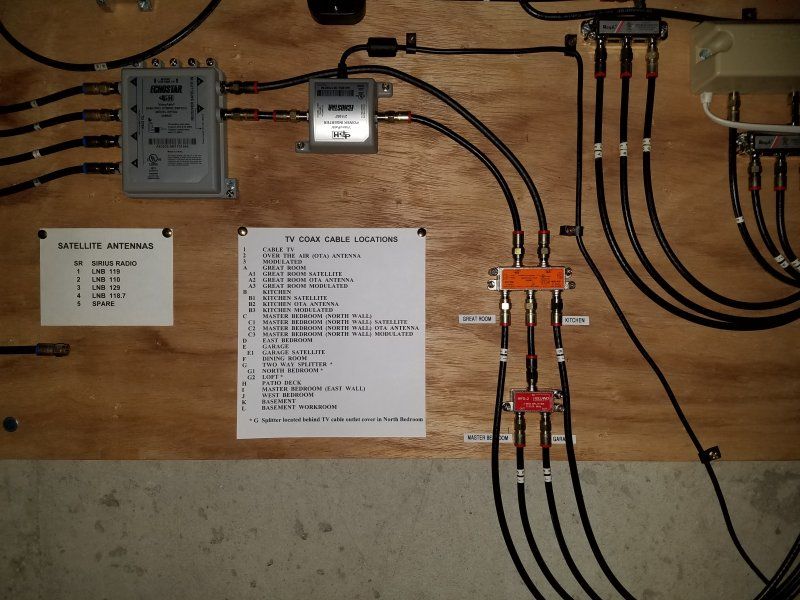

Sorry, I can not find the thread I had started about two Hopper 3 install with post #255. There is something wrong in the history section of this forum right now for some reason. Anyway, attached is my setup with two H3s, two 4K Joeys, and two WJs all on one account. See if you can find a local retailer for your install.

I have the answer. Skimmed the other posts - but I'm a nerdy technician so here it goes.
Then joey 1.0 is not compatible with the hopper 3 - don't even try it. Sorry you own a joey, there aren't many benefits of doing so anyway. At minimum you need joey 2/3, 4k joey, or wifi joey. Google the difference between them.
You absolutely can have two hopper 3s with separate DVRs and moca clients. You just need a dp42 switch and two separate solo hubs. This is potentially a beast of an install so I hope you get a prepared technician - be nice give the man a water or a soft drink while he works.
You will most likely have to purchase the second Hopper 3...because reasons. Expect at least a couple hundred dollars for that second receiver.
gQBHV
Linked is the wiring diagram for two hopper 3 and a dp42 switch. Hope that makes things clear.
Armed with this knowledge, you should be able to manhandle DISH into getting what you want. Just stop trying to activate that joey 1.0, I guarantee that's what's holding up the process - every CSRs system is freaking out when they try to input that - because it's not compatible. Besides, that's like putting diesel in a Lamborghini - don't do that to your hopper 3 ;)
