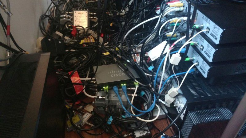

I've got 3 Hopper 3's that all see each other. The client ports on the solo hubs are all connected.
Can you post some pictures, if you dont mind?
The wiring picture is my office. We do the wiring at customer's houses much, much neater. :)

Besides the three Hopper 3's all that wiring also supports three Hopper 2's, a Super Joey, 2 Joeys, 2 Genies and a few HR24's. There's about 20 or more TV's in the house, shop and offices.
Two of the Hopper 3's have their own internet connections to the main DSL router and one is connected to a Viasat network. The Hopper 2's are all connected to a different network and a different DSL connection. I have one Hopper 2 and Super Joey and the other two Hopper 2's and the Hopper 3's on all separate MoCA networks so they don't see each other. The Super Joey can't be on any kind of network with more than one Hopper 2 as it gets confused. :)
