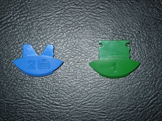

You really shouldn't remove that little white tab that "blocks the tab from going in." That white piece (in the TV2/UHF remote) is like a switch. It swings to the left or right and determines if the remote operates in UHF or IR mode. If you look at the attached picture, you'll see that the blue tab (that came from the UHF remote) has a V-shaped notch in it that the green tab (from the IR remote) doesn't have. That white piece you're talking about removing fits into that V-shaped notch and tells the remote which mode to operate in. And please don't forget, those remotes don't belong to you and if you break them Dish is going to charge you for it. Also, there's no way to get TV2 to operate off of an IR remote. Sorry.

Because it's now "stuck" on whatever mode you last had it on before you removed the white piece. If it's stuck on IR, it will only control TV1, and not TV2. If it's stuck on UHF, it will control either TV as long as you have UHF Pro enabled for TV1 - if you ever want to make the remote control TV1 via IR, you won't be able to.
bas_java said:
I have had the little tabs switched for about 2 months now, and I have been fooling around the different addresses for a while now and without that "little switch" I have successfully controlled TV1 (IR) and TV2 (UHF) with the same remote. (Emphasis added)
No you haven't. There's no way to switch between IR and UHF without that white piece. My guess is that you have the remote "stuck" in UHF mode and have UHF Pro enabled on TV1. Change TV1 to IR only in the system info screen and then tell me if the remote still works (on TV1, of course).
