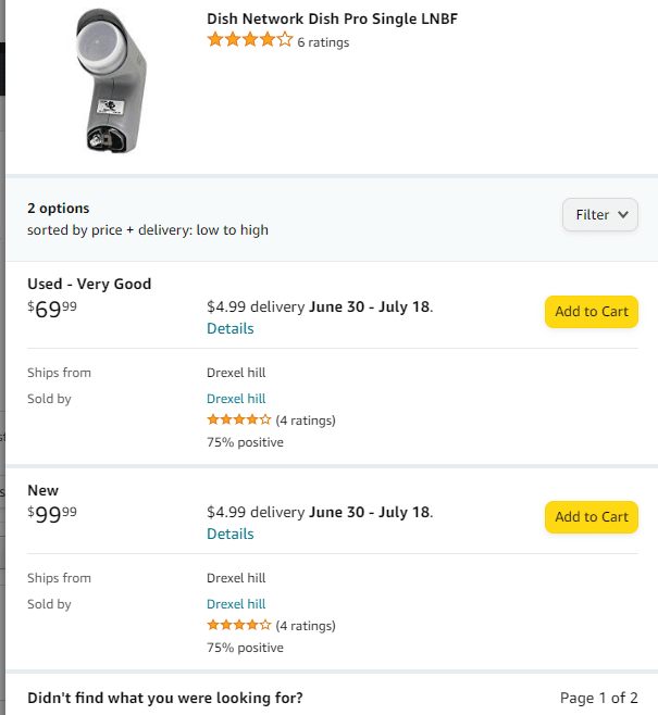

You need something like this (amazon). you will see models with either 1 or two cable connectors - either model works. Be sure it is DishPro - not Legacy.
You can strip the outer plastic housing cover off if needed to make it fit.

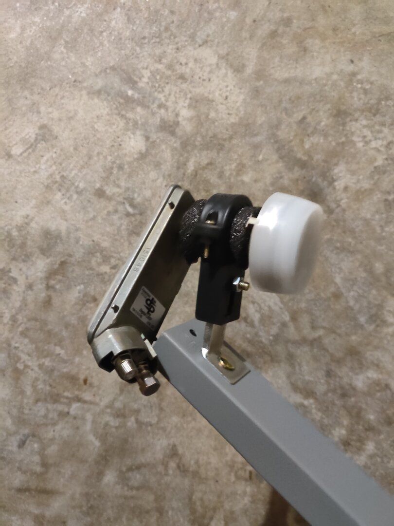

OK, thanks for all that. Here's the existing setup:
It doesn't use the yoke for mounting, so D vs rectangular won't matter. But can a Dish LNB be mounted as shown? Maybe by cutting away the housing?
Or is the consensus that an old DirecTV LNB will work with the Wally as long as I'm not doing a two tuner setup? Maybe Dish uses different switching voltages or something to get odd/even transponders?

Here is what those DP Dual's look like without their enclosure, so it should work as HIFI says. I would definitely try the LNB you have first though, DP Dual/singles are becoming pretty rare and therefore stupid expensive (got a few for $15 a pop only a few years ago)

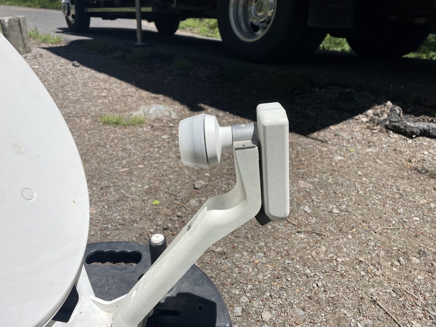

I wouldn't say there is consensus. But I believe it will work, and chainblu said it did work for his test. Do you want a neat installation like your photo above, or the kluged installation like ethanlerma shows in his post above mine? The latter appears to have a two-piece adapter which you may or may not want to fiddle with.
