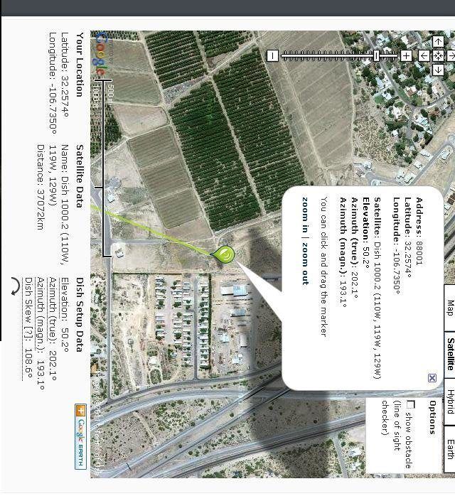

I am having a problem with correct dish setup data. I have a NEW VIP211K--1000.2.
The 1000.2 manual says the setup Data is: Az:189, El:49, Sk:107 for 88001 zip code
but WWW.dishpointer.com says: Az:210.1, El:48.0, Sk:64.9 for 119W & 129W at 88001 Zip Code.
Which is right? Does someone know what the actual correct data is?
Thanks
This is what I show for zip code 88001, which is a lot closer to what the OP had.
