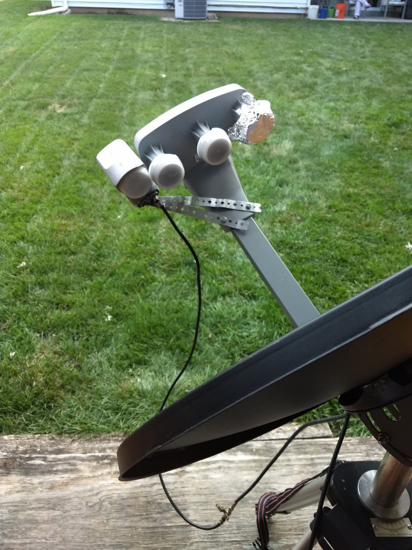

I got tired of changing my lnb out when camping so I played with the western arc on eastern sats.Had to set skew farther than suppose to be but it works.Using center for 61° came up with about signal of 60 on 61.5°...45 on the 72° and 40 on the 77sat..Got alot of extra time on my hands

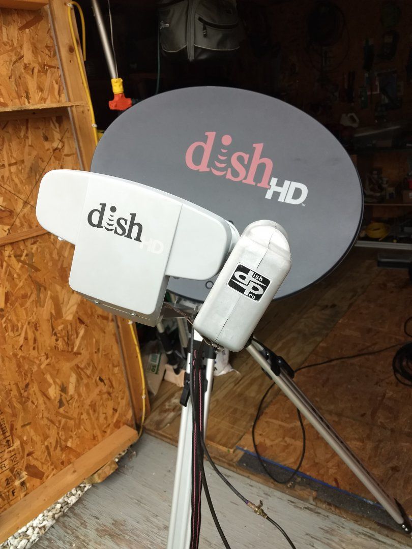

Since I took the pics I replaced the straps with 2 steel straps and drilled a hole in the plastic lnb holder to run a short cable from the 77°lnb to the LNB input..I know it's not going to get the proper signal that you would with the 1000.4 but it does work
