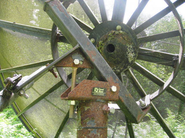

I live in the country and with the death of analog over the air TV, I have lost every channel but one. I just bought my house and the old owners had trash and stuff laying everywhere. One of those things is a ten foot Channel Master dish. It is still set up and with a little brush clearing it would seem to be my only viable option. I don't watch a lot of TV but I do live in Western Washington and it rains...a lot. My wife would like ABC and I would like to let her have it so that I don't have to get flak for moving us to the sticks. Heaven forbid she miss a season of Dancing with the Stars. ;-)

A ten foot dish with whatever is on it. the mount has some corrosion but I can fix that. I will attach pics. The in house components were taken by the very elderly former owners.

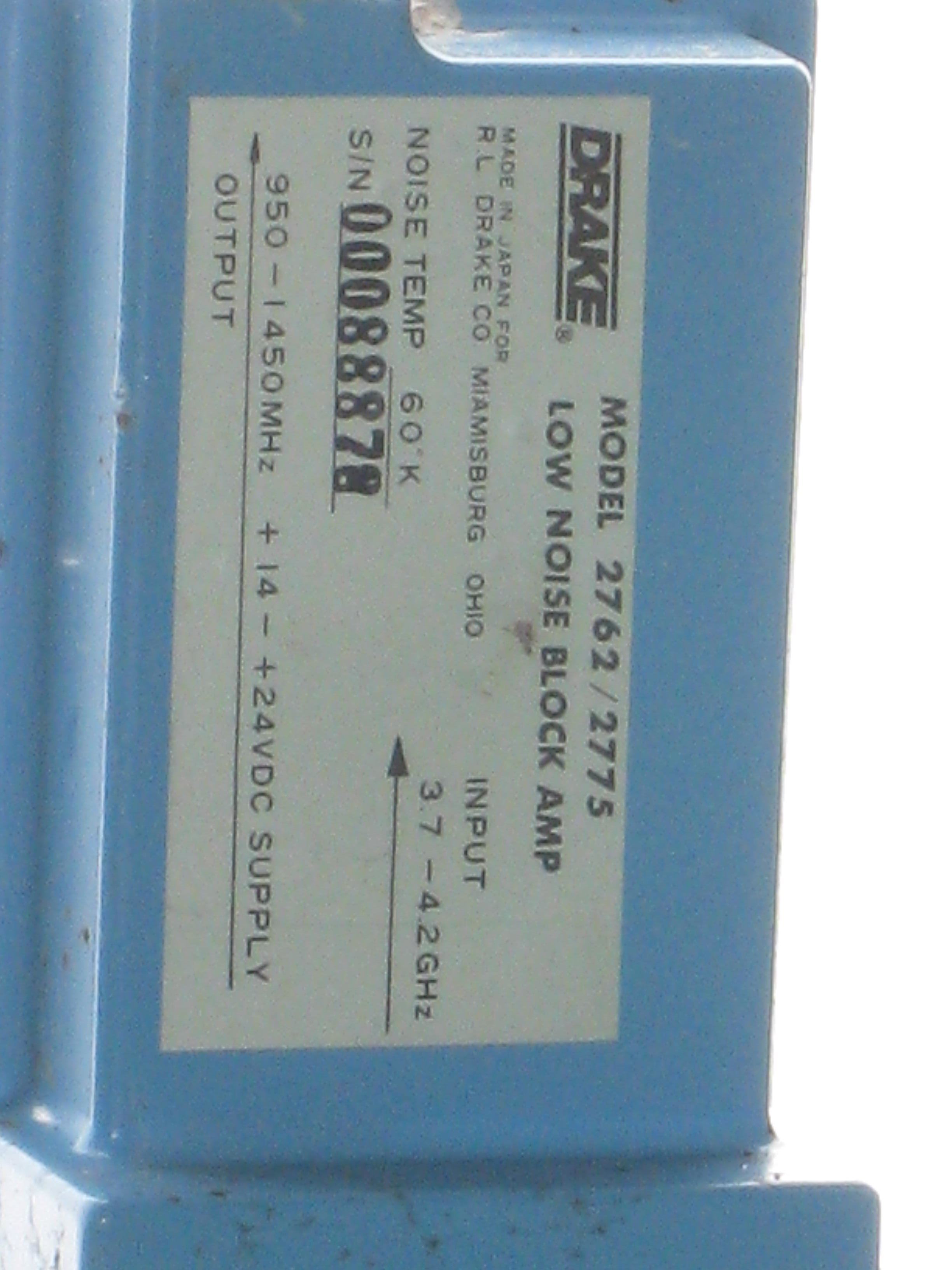

How do I tell more about my LNB? I have no idea how old this equipment is...

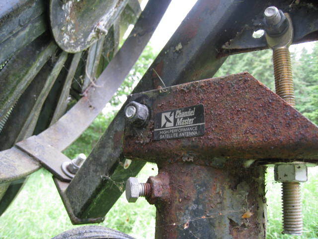

real nice find, that dish is a carbon copy of mine, if you would, could you PLEASE take a close up picture of the label? Im trying to get one made up for mine.

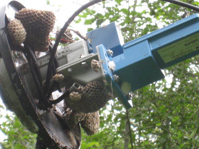

For Starters i have no idead what kind of lnb you have, unless you take off that black cover on the feedhorn (eye of the dish) and post some pics of it.

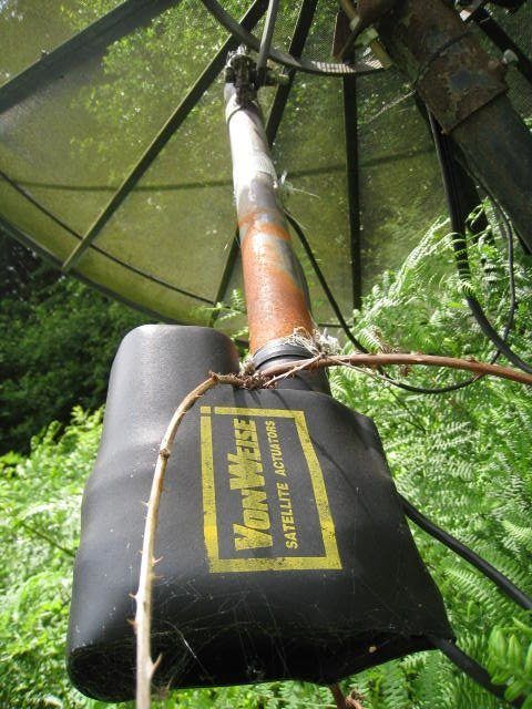

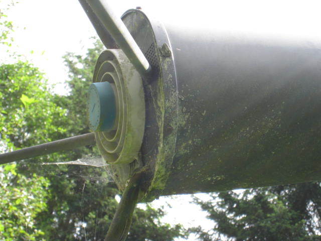

Nice dish, at least they had the weather cover on it, and on the actuator. Turn those 4 little plastic locknuts on the big end of your lnb cover and shoot a pic of your electronics. Those plastic things are a bitch to find in high grass too, just turn about 1/2turn and pull straight out on them to release the cover, and watch for spiders, wasps inside. You can prob get that one up and running again without too much work--is the cable still run out to the dish?
Techfizzle - The only tag I see is a generic Channel Master one on the mount...is there somewhere specific I should look?

You weren't kidding! My LNB pics...
Techfizzle - Here are the tags. It looks like there was a paper/plastic tag stuck to the back of the dish but it's totally faded out.
Oh....I just realized why you wanted the pic. I'll get a new one shortly that is a "real" close up.

My reply got lost, so I'm posting again:
Looks like the wasps had been working in there for years. They can get into the smallest places.
Prob still good lnb, late80's most likely. They have them with noise ratings down in the 20's and teens now but that one will prob still work ok on a dish that big. You can have that looking new with a little work, detergent and clorox and a brush on the mesh, wire brush the rust, etc.
that lnb was a brick house.... back in its day
hook it up to analog receiver, but if your getting alot of sparkies on cspan, then its time for a replacement

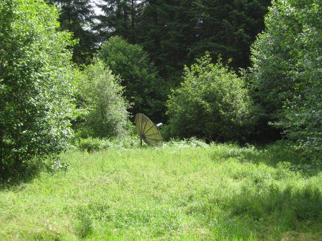

From the pics it looks to me like the "tree's" are in the way. Gonna have to chop them all down or move the dish for a clear "line of sight"
Chopping and scrubbing will be easy enough. The trees that you see are just the tip of the iceberg. I have about 10-15 years of alder to cut but at least all of my big fir trees should be out of the way. Since it's kind of an old alley cut for the dish the trick will be taking the first few down without smooshing the dish.

Looks like the actuator wire is still there. Try following and finding the other end of that conduit around your house. Should save you a lot of time and headache.
