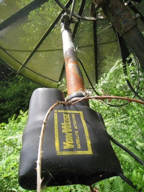

You might post a photo or describe your actuator (brand name, name plate info).
Some really, really old actuators use potentiometers to measure distance or rotation instead of with pulses like current technology does.
The GBox and VBox units are pulse counters.

It's an old Von Weise. It should be a pulse right???:confused:

Can't say for sure until you take that back plate off.
Be careful to catch the 2 nuts on the lower screws. They are needed.
I have 2 Von Weiss actuators.
One was installed in 1985, which requires +5V, Pulse, and GND wires
Uses a light over a disc-wheel with 6 notches in it to count distance
Has 5 screw posts to connect the wires.
The other was installed around 2000 and it needs only Pulse and GND connected.
It uses a wheel with 8 magnets
Has 4 screw posts to connect the wires.

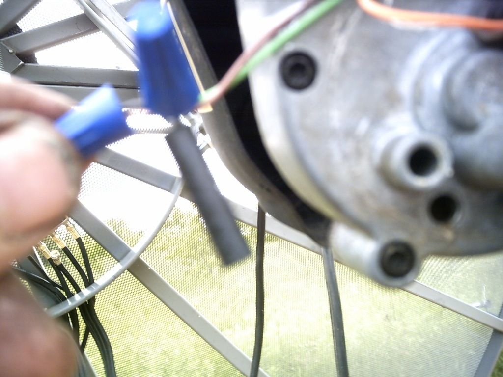

I'd bet it's the older style but I'll check to make sure. The old lady I bought my house from was super sweet but she could have been George Washington's secretary.:bounce
My VOn Wiese is even different yet. It is a small round rod with 2 wires hanging out of it. It was just siliconed into a round hole you see in the picture.

Looks like the newer style. There were kits you could get to convert the old style to the newer style. I didn't find the old optical style to be very reliable. In theory they should be more accurate but I think static/lightning would get them more easily than the reed sensors.
If it were me I'd get rid of the wire nuts in favor of crimp style connectors or there should have been a terminal block in there from the factory. The wire nuts can be quite cumbersome.
Does your camera have a "macro" setting? That would help you get a clearer closeup. On second look, that might not be a reed sensor.......need a clearer picture of the whole thing.

Yes I did away with the wire nuts, I soldered longer wires on the whatever it is. I have a older post about this unit it seems it has a name on it put can not read it all. I looked the company up and found them in Canada. I guess these types do not go bad but I do not know that. Any way I put longer wires on it and used the terminal strip to make connection. I have not tested it out yet as I had to send my gbox back on a rma. I got it back but work is getting in the way and have not had a chance to try it out. As I have to finish burying the cable and other things. Will follow up when I get finished.
