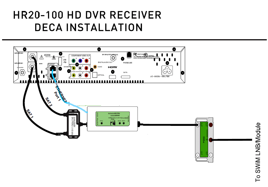

He did show up and an hour fifteen after he called but was still fifteen minutes inside the original window. He hit a snag on my HR20-100. Fortunately, I had been reading and told him I thought the HR20's couldn't power DECA off Sat1 but a kludge was developed to power it off Sat2 using a splitter. I showed him two options one with a BSF and one without. He opted for Option 2 which seems to work.
Do any of you pros have an opinion about whether or not a BSF should be present? All does seem well and working.

He did it this way. Is there a problem?
