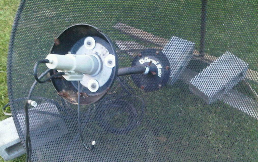

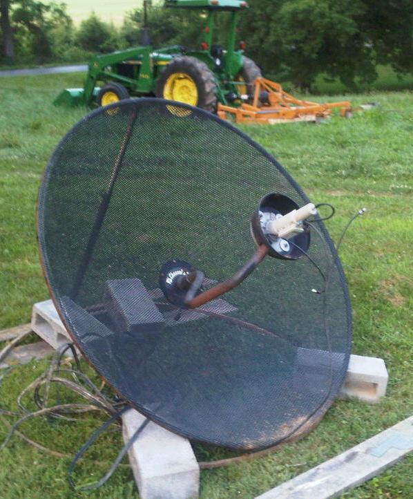

Picked up a 5 foot Channel Master from a lady up on the mountain.
I replaced the LNB with a DMX-741 because the one on it had to be powered and I didn't know how to do that.

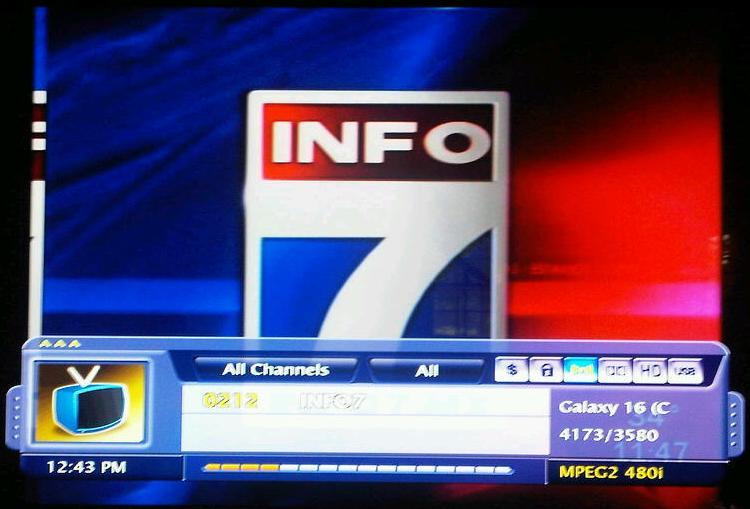

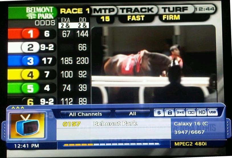

Pointed it at 99W just to try it out and got some usable channels. It finds many channels that come up 'SNG' but I can't seem to tune those in.
I would like to try it on 133W but might not have LOS.
I think it is a cool little BUD and it really easy to setup.
Here are some pix.

oh btw: you're aimed at 95W not 99W. Those "SNG" channels are the horse race channels (the actual feed from the track)...they are up 24/7 in a lot of cases but until an hour before the 1st race it will just be black screen
You should be able to tune in My Family TV (3744 V 2206) and the Univision/CBS feeds on 4166 too

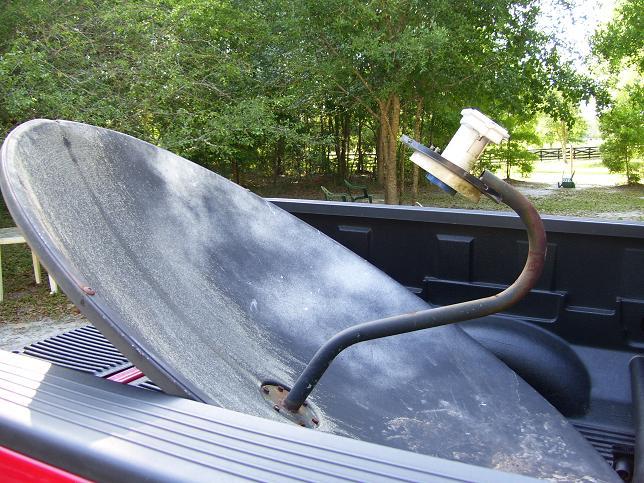

Cool dish, I have the solid version. Here's a pic of it still in the truck....

I'll come on down and do the south 40. But my favorite speed is 3 miles per hour!
Hey Chapel if I was using something like that>it'd be MY favorite speed too, lol.
Seriously, nice tractor but for what I got, I could make one pass with that mower and be finished!

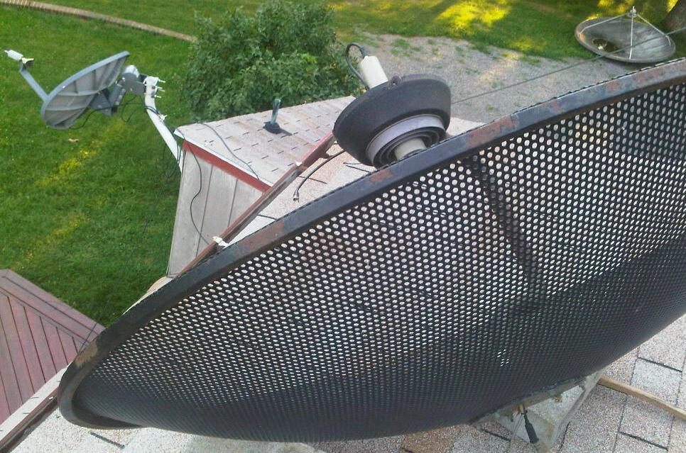

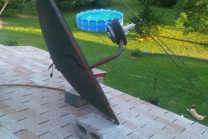

Yep that is the next project
Yep, I just got that one for free and is the next project. It is an 8 foot Channel Master that I want to fully restore.
Time - - - oh for some time.
