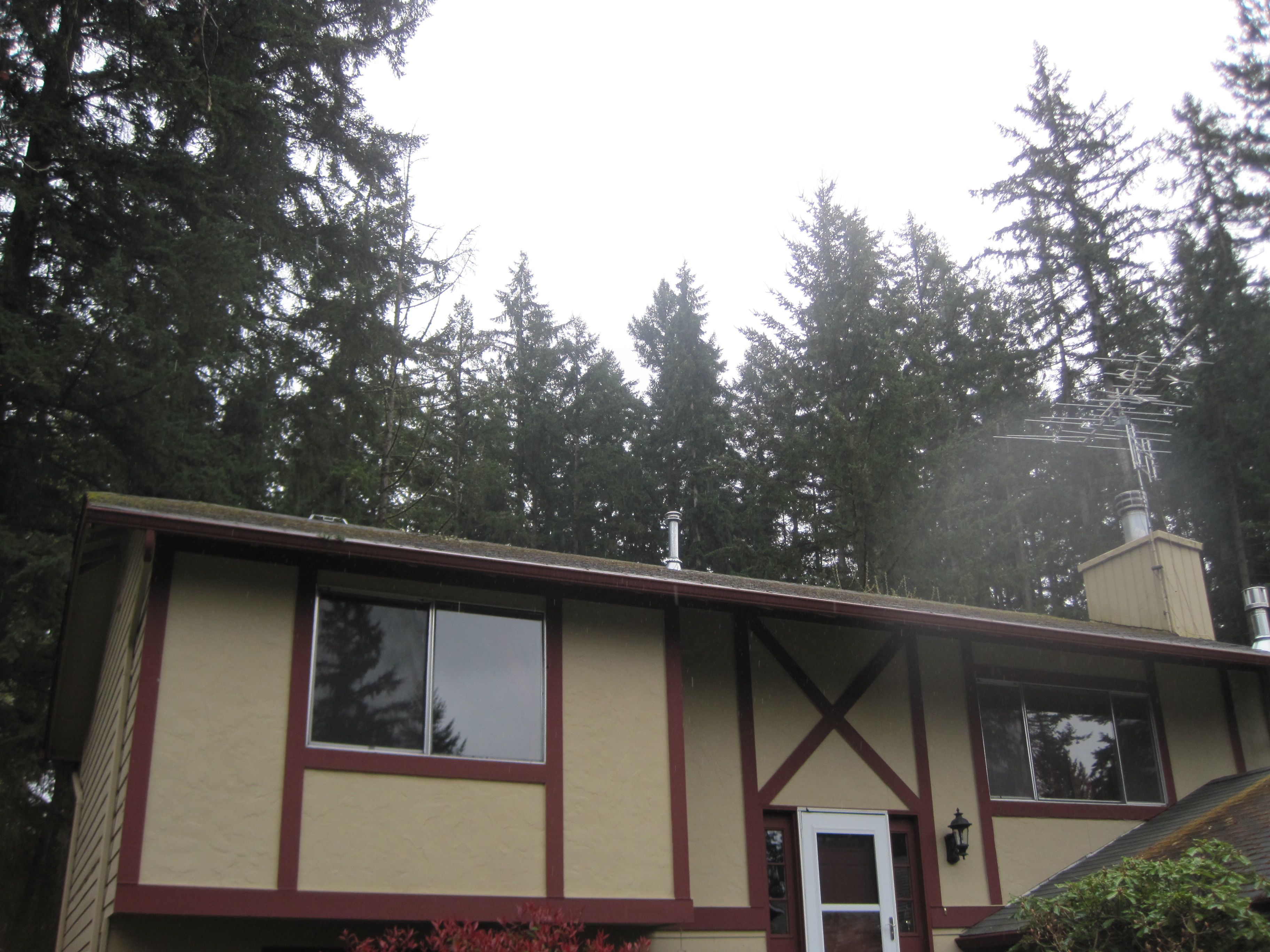

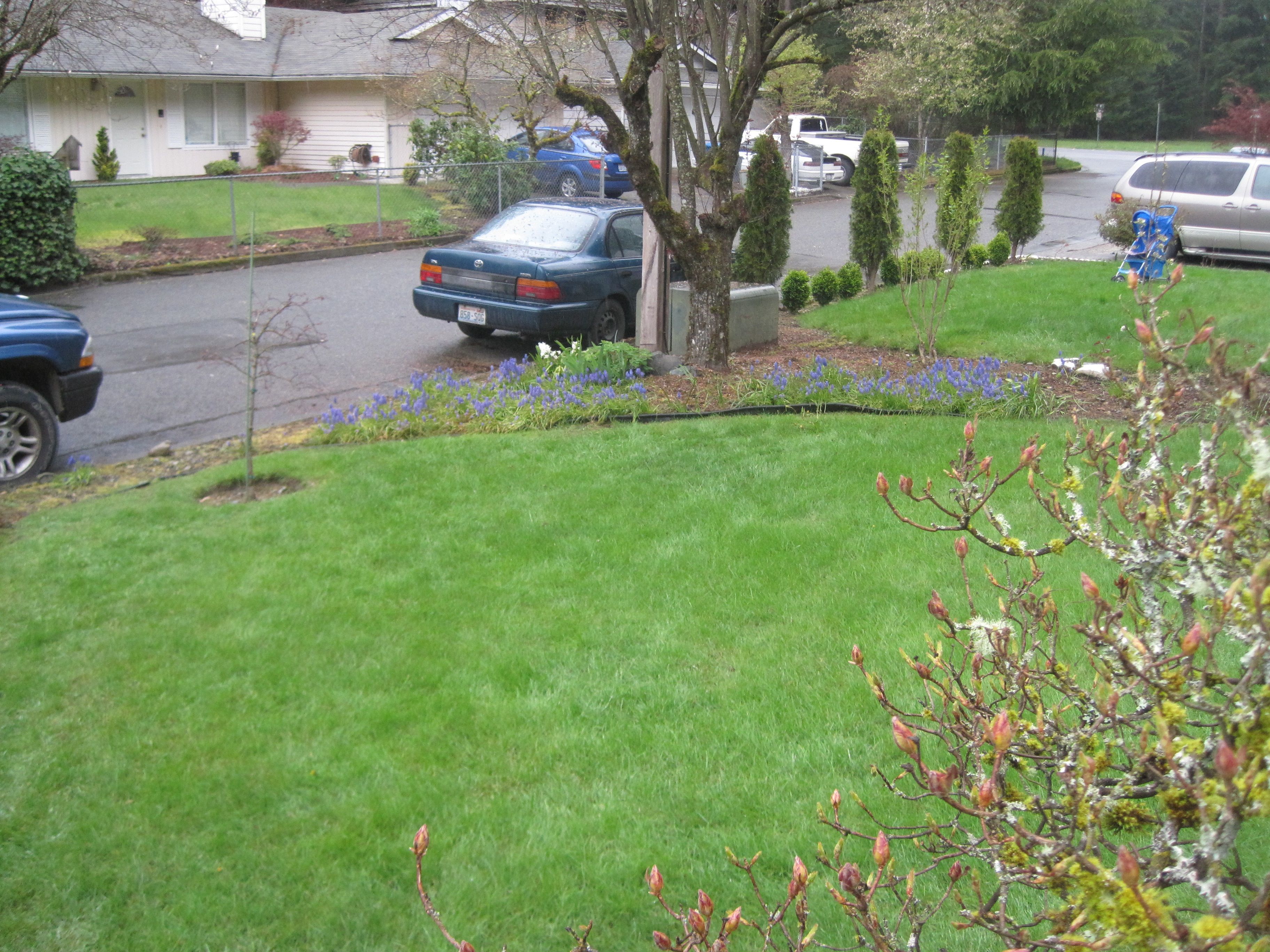

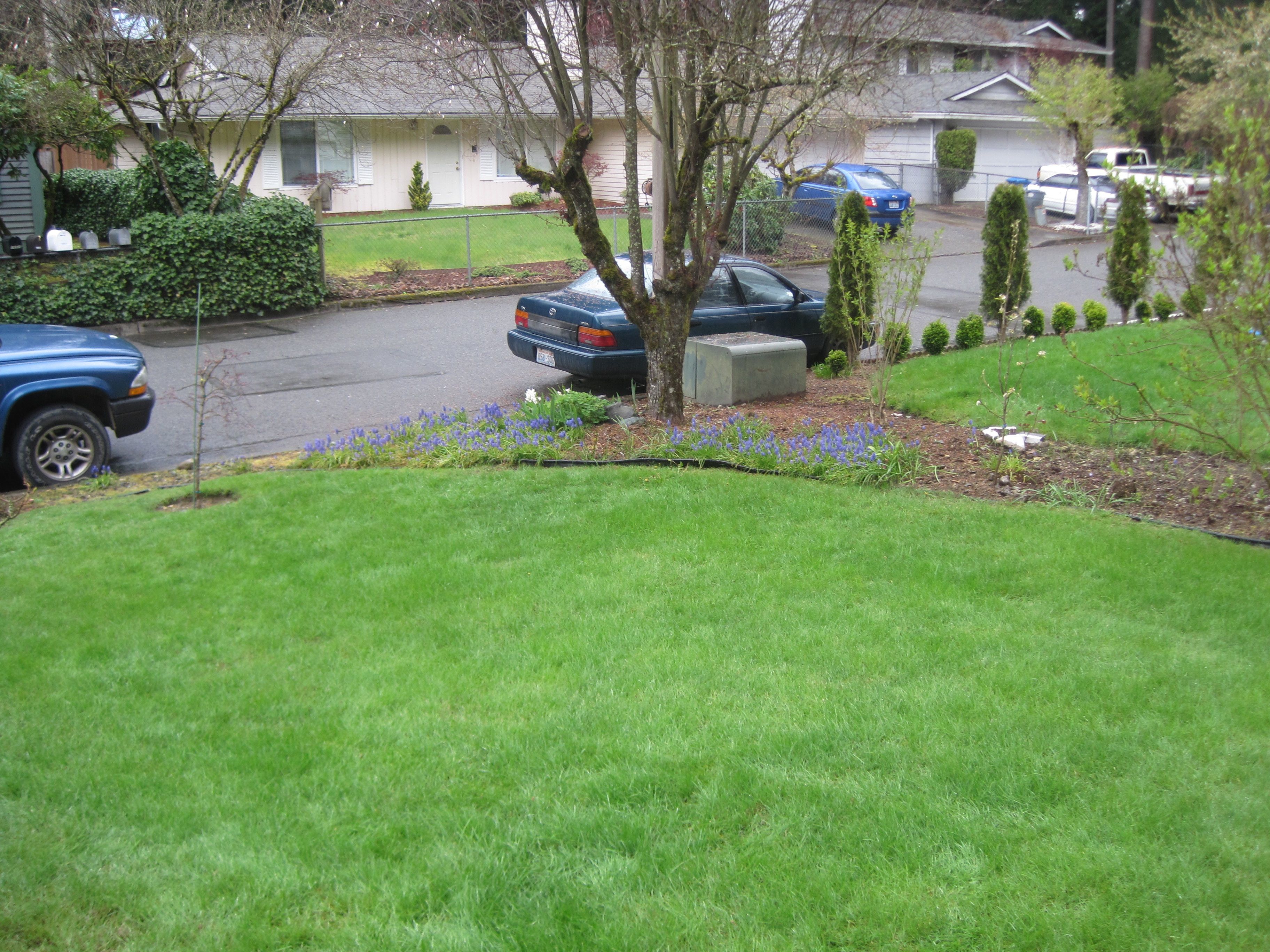

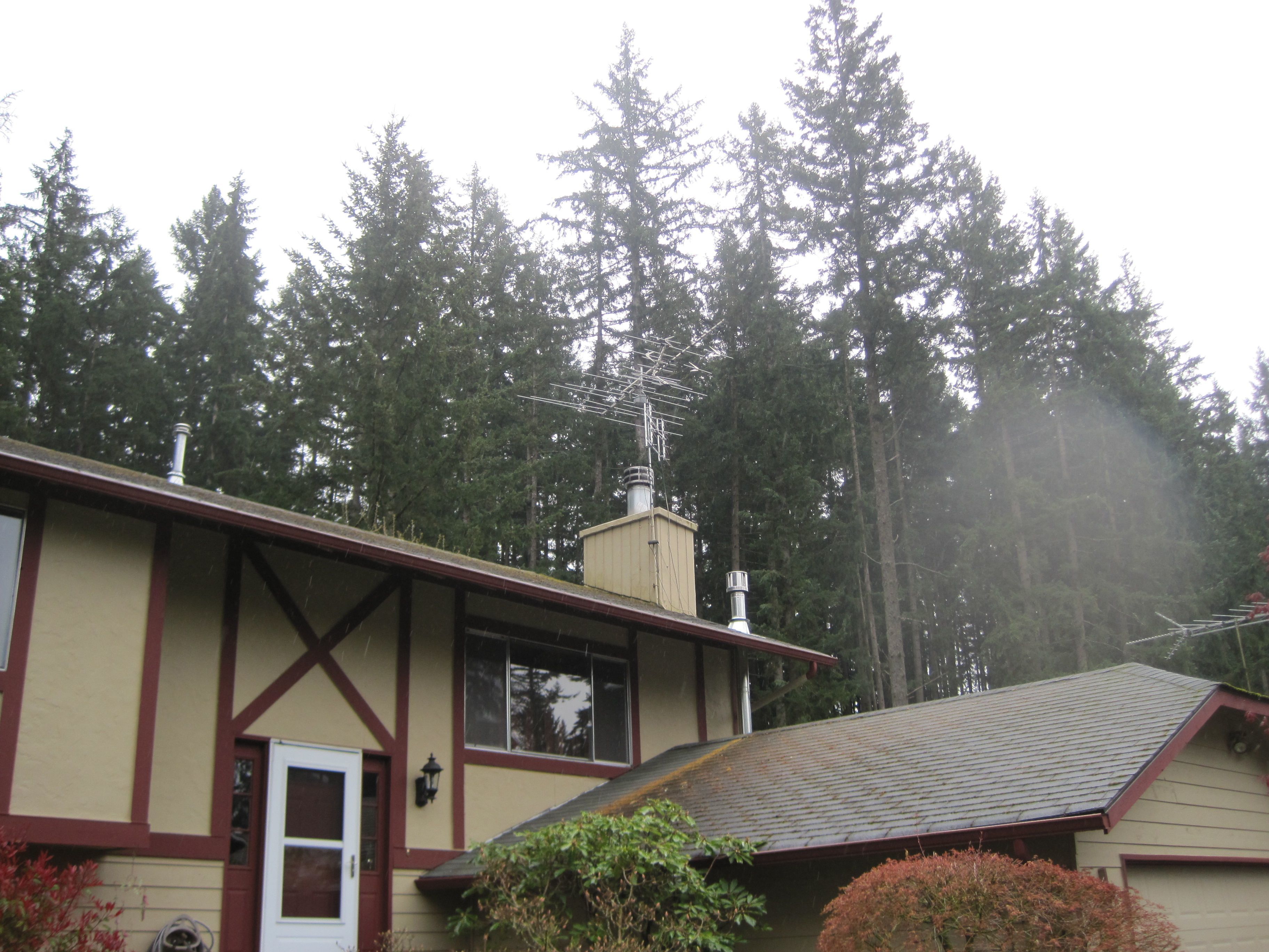

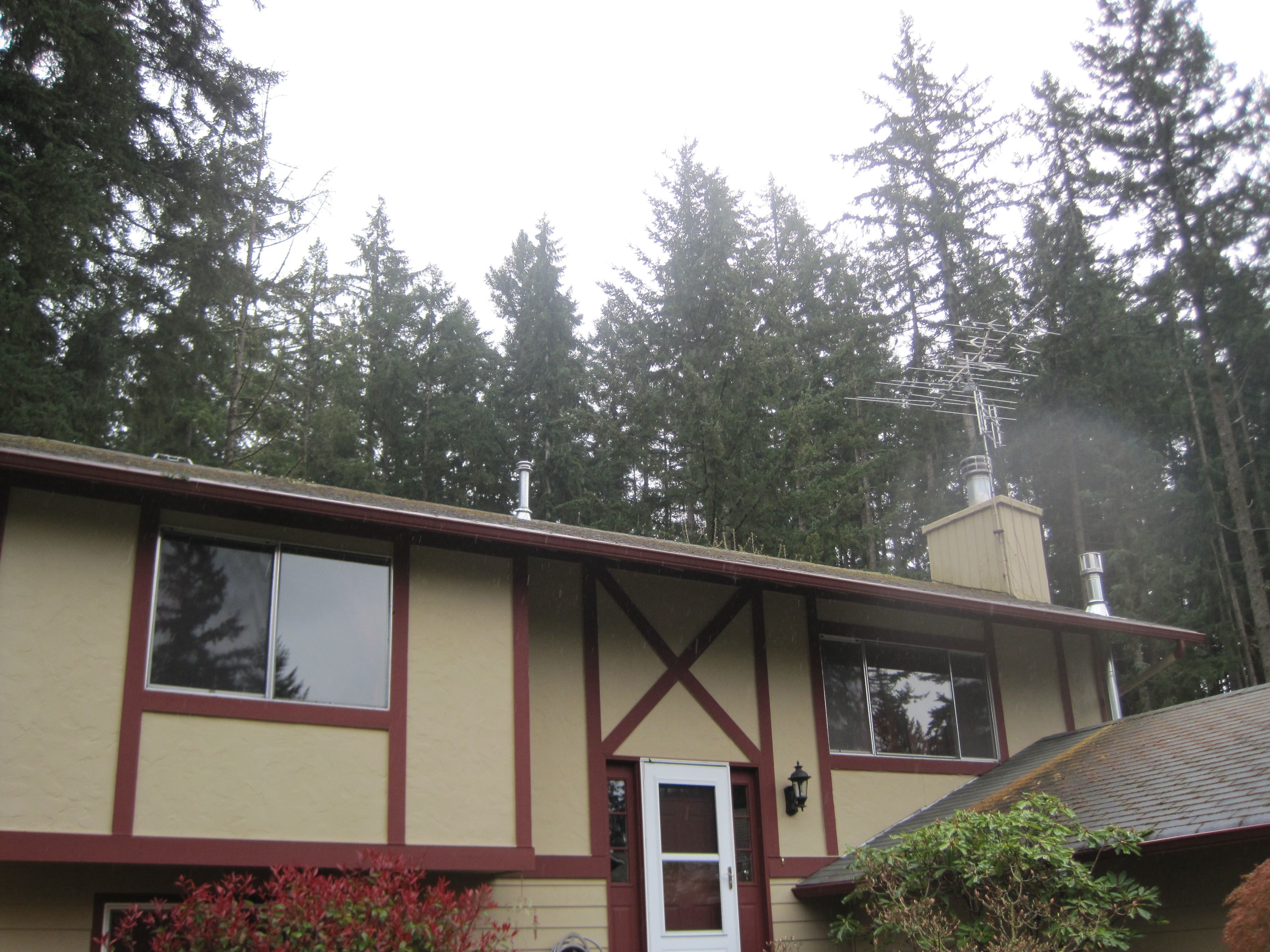

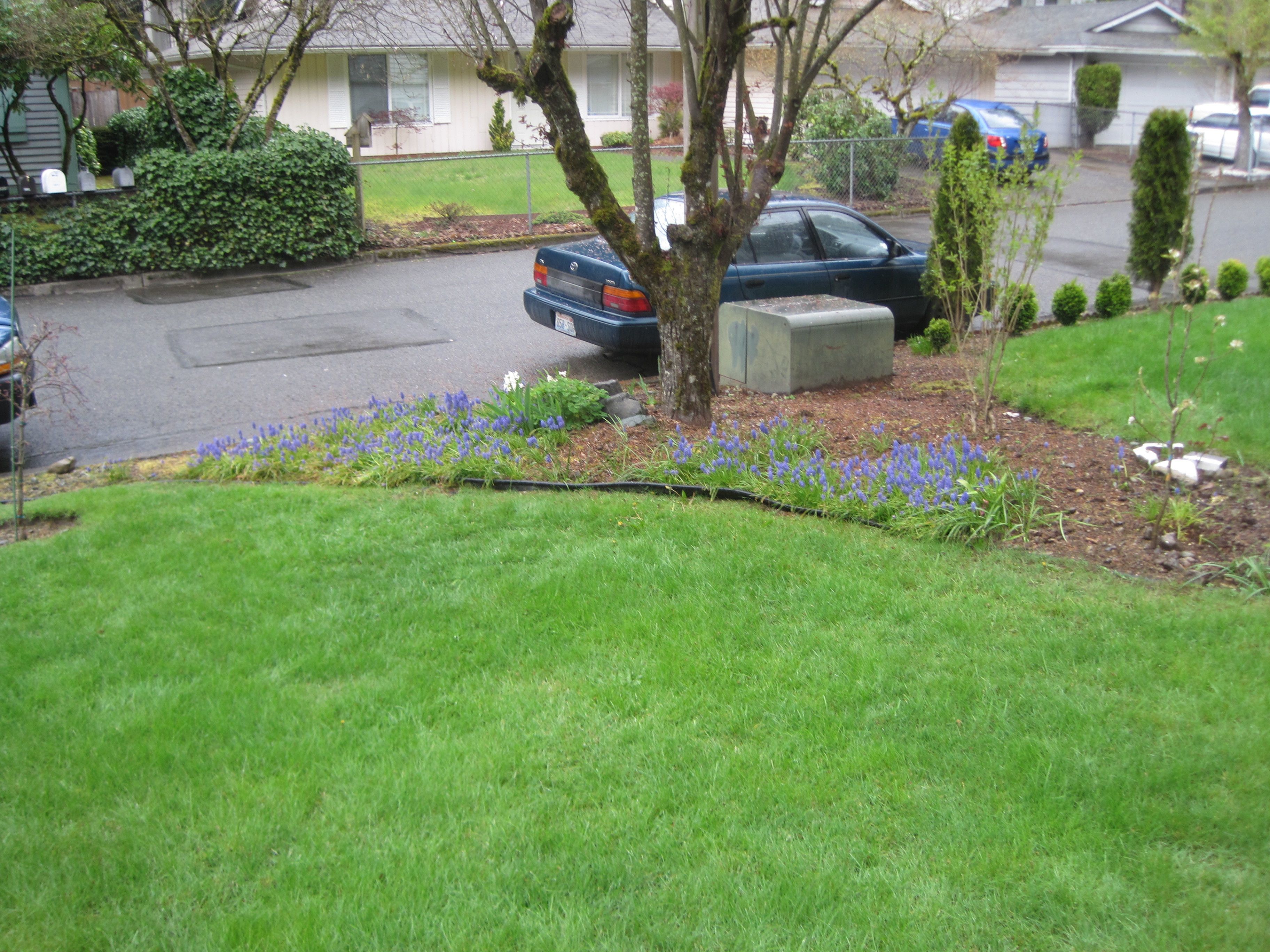

We've included pics of the proposed install site. The dish will be pointing at the house and those trees are a good 100 feet *edit* My husband says more than 100 feet away. and are a 30 degree angle up to where my husband was standing (he did some sore of voodoo math with a level)

You might try and visit Dishpointer.com This works in conjunction with google earth to show you the direction of sats and the elevation line so you can tell if you can see what you want from that point in your yard. If the photos of your area are high resolution this can be very helpful to determine the location of the dish. FTA programming comes and goes and travels the arc from end to end so it's always best to postion the dish with as much of the arc available as possible.
If those trees are due south then you may only be able to hit a few satellites. My guess is 121 west is your highest satellite in the sky and your dish would be about 35 degrees. From your pictures it doesn't look like the satellite clears that big tree in the middle but I could be wrong.

I am a lot south of you but near your longitude (117 w). There is really nothing above 139, so if your site survey gives you a choice between going a lot above 135w or a lot below 105w, pick a lot below.
