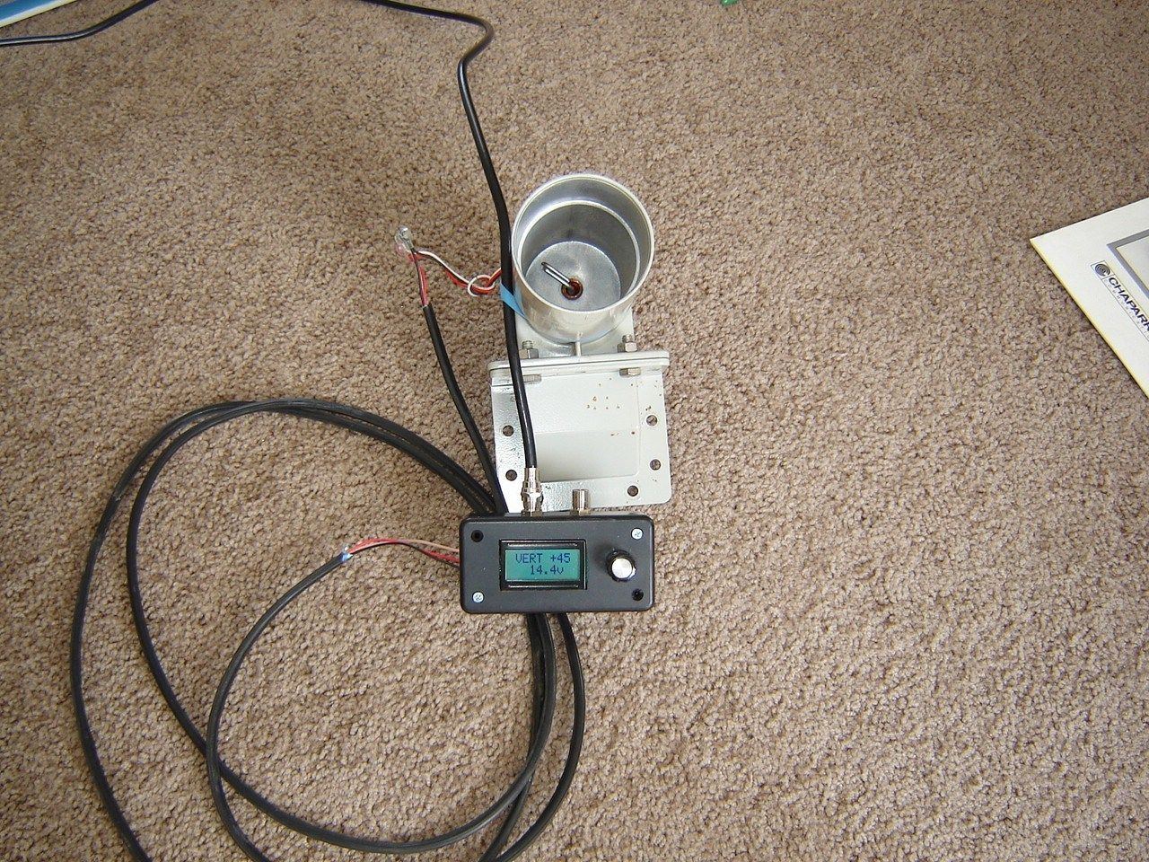

Here's a couple of pictures showing a Chaparral C band feed horn being operated by my own design servo controller.
The knob is to adjust the skew, if needed.
pretty cool. but do you have to change the knob when you switch polarities. seems like using an IrD would be less cumbersome
No, the knob is just for adjusting skew. The unit is in line to sense the DC voltage on the coax and switches polarity automatically.
I added the voltage display for troubleshooting. First time I used it, I found a loose coax because the voltage would jump around when a wind gust hit the dish. Turned out I'd forgotten to tighten a connector at the grounding block.
