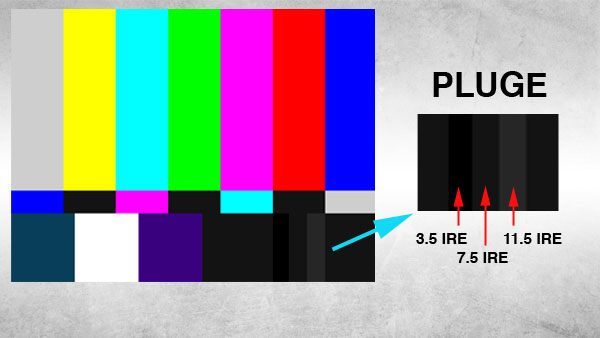

Maybe GAME and MOVIE has something to do with the reference black level that is output to the TV. In the past selecting a GAME video mode meant that black was set to 0 IRE and MOVIE was set to 7.5 IRE. This can be verified easily if your TV has a test pattern that includes a PLUGE pattern or SMPTE bars with PLUGE in 2nd box from the right on the bottom of the color bars. The block is divided into three little columns with 3.5 IRE on the left, 7.5 IRE in the middle, and 11.5 IRE on the right. Depending on how the Denon and your TV handle this you might either two small bars with the right one being greyer than the middle one or just a bar on the right side.
I'll see if I can find a picture of a PLUGE for reference.
Yeah, I can always pop in Spears and Munsil, DVE or WOW and see if changing from Movie to Game matters on a pattern. It just irritates the hell out of me when they put in features like this and dont explain them. If I have video conversion OFF, it should just be acting as a repeater, period.

Did you see any difference in black levels with your calibration discs when changing modes? I know those modes have different black levels on my TV, but I have everything running through my Denon AVR and only have a single connection to the TV. Simpler as far as switching goes but each device has to be calibrated using the TV's built-in reference bars so they all match. I simply use the AVS ITU-R BT.709 disc in the Oppo for setup these days since I care more about PQ when watching discs vs. just HD-Lite from satellite. I also have the DVE HD disc as well.
