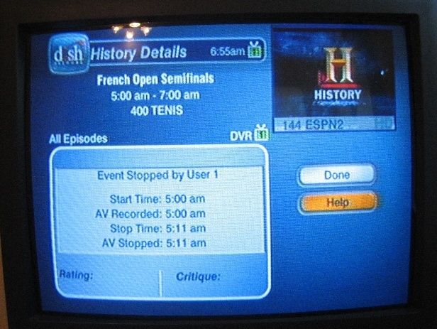

Several times, the VIP722 has stopped a recording shortly after it began, for no apparent reason.
The example I show below happened at 5:11 a.m. I assure you that no one in my family is up at 5:11 a.m. Still, the history claims that the "Event Stopped by User 1". Can anyone tell me what this is happening?

Could be a couple of things,
what time is your nightly update? This is not supposed to interfere with recordings, but it may from time to time. Try changing the time to when it shouldn't try to occur during recordings.
Does a close neighbor have Dish? His remote could be controlling your receiver. Change the remote address and see if that fixes it.
If not these then I am not sure, someone will chime in to help if that is the case or you could try tech support at Dish once you eliminate that these two things are not causing your problem.

I agree with garys. I had this same issue and once I changed the remote address it went away. I think one of your neighbors is probably changing it, or stopping the programming.
