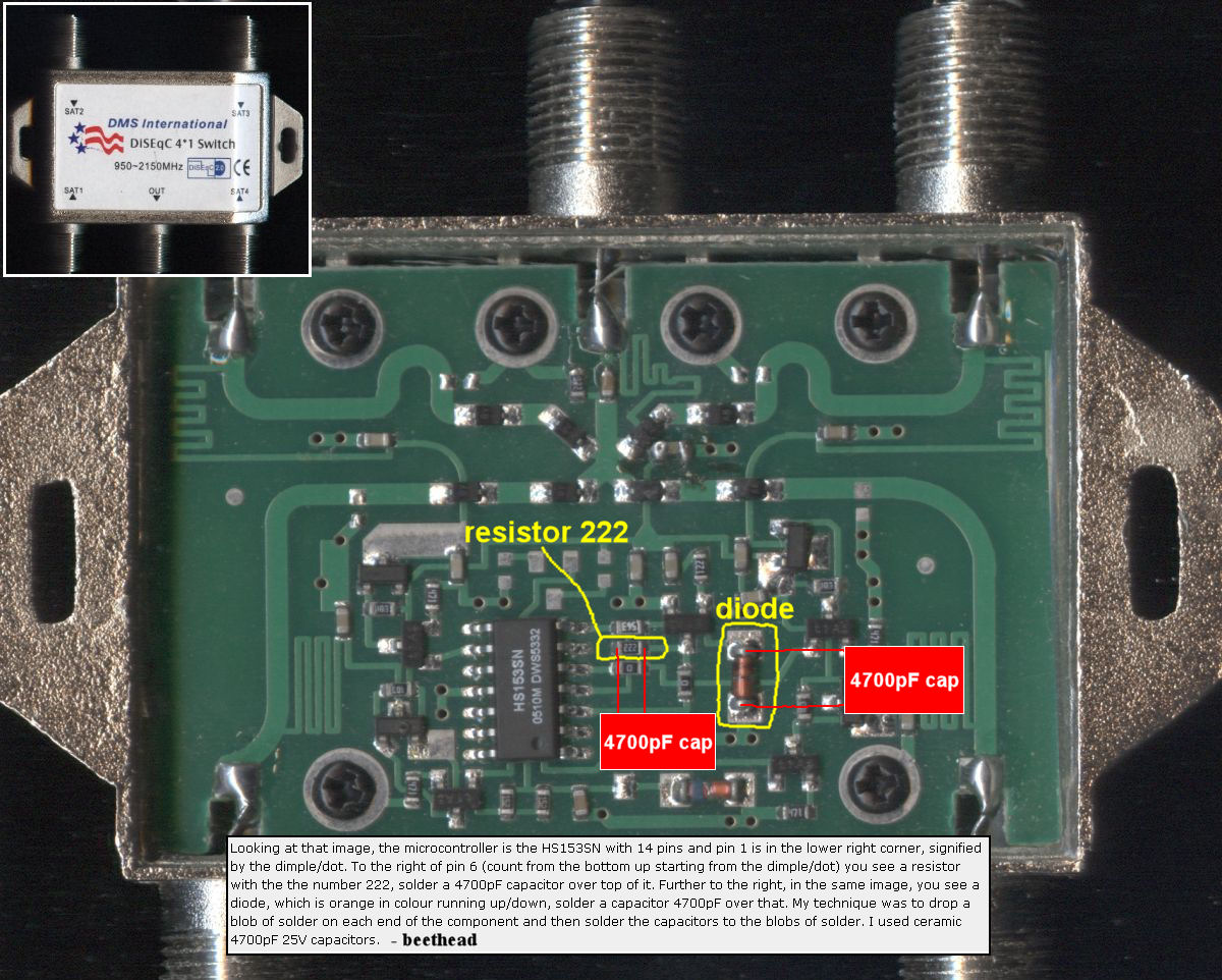

Some of the Twinhan cards are known for poor diseqc switching, and there is a modification to filter some of the noise. The modification was adding two capacitors to the diseqc switch. When using a diseqc switch with my Twinhan 1020A, I found the modification solved my switching problems. Some of your motor problems may be related to noise on the line causing the motor to interpret the commands inproperly. If you can add a modded diseqc switch between the motor and the LNBF it might help your motor positioning problems. I have not tried controlling my motor with my Twinhan card, but just thought this might help.

You may be on to something here. What specific switch do you think might help, I'll give it a try.

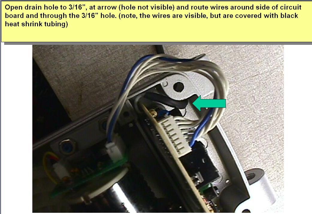

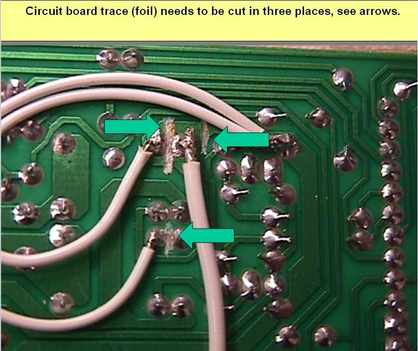

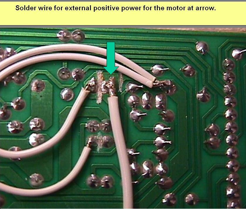

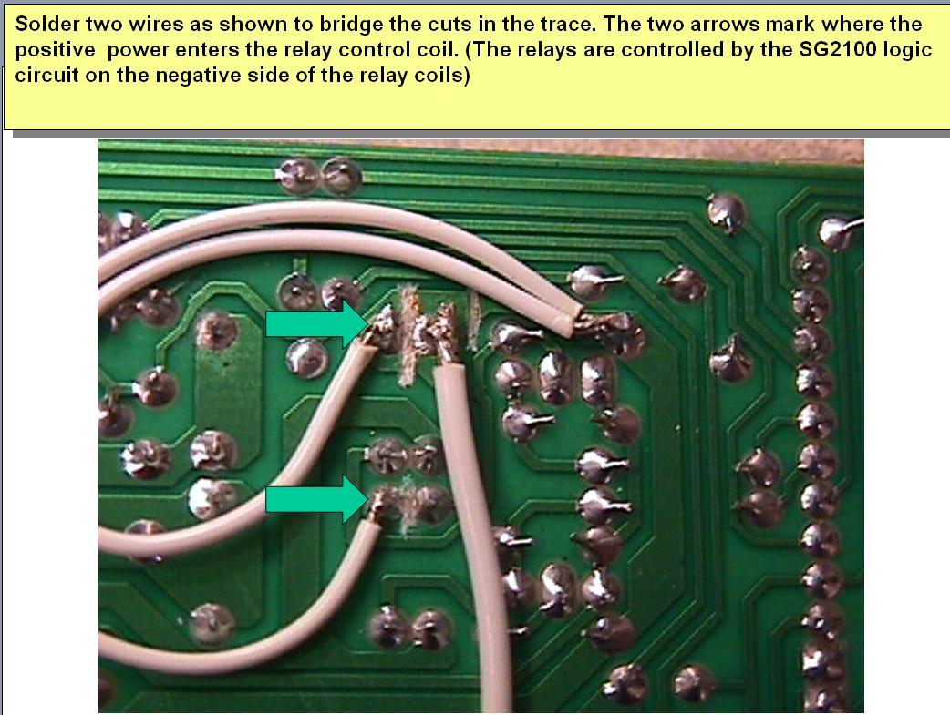

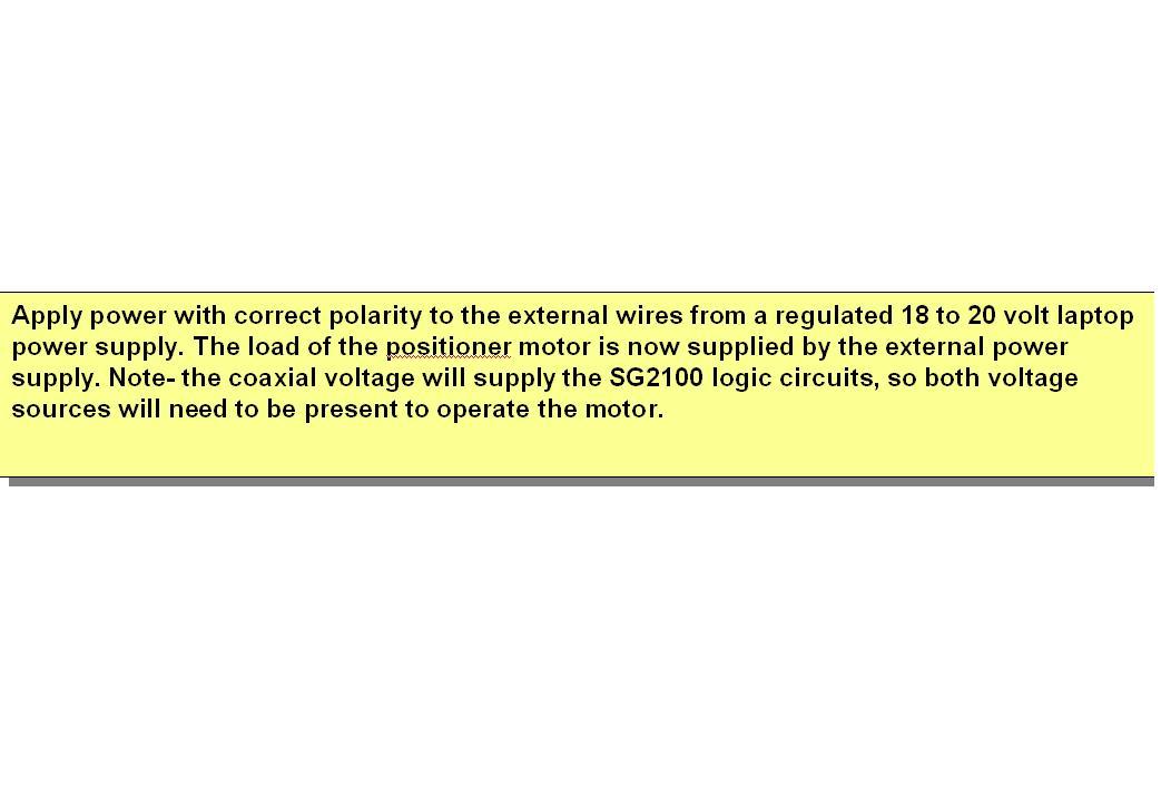

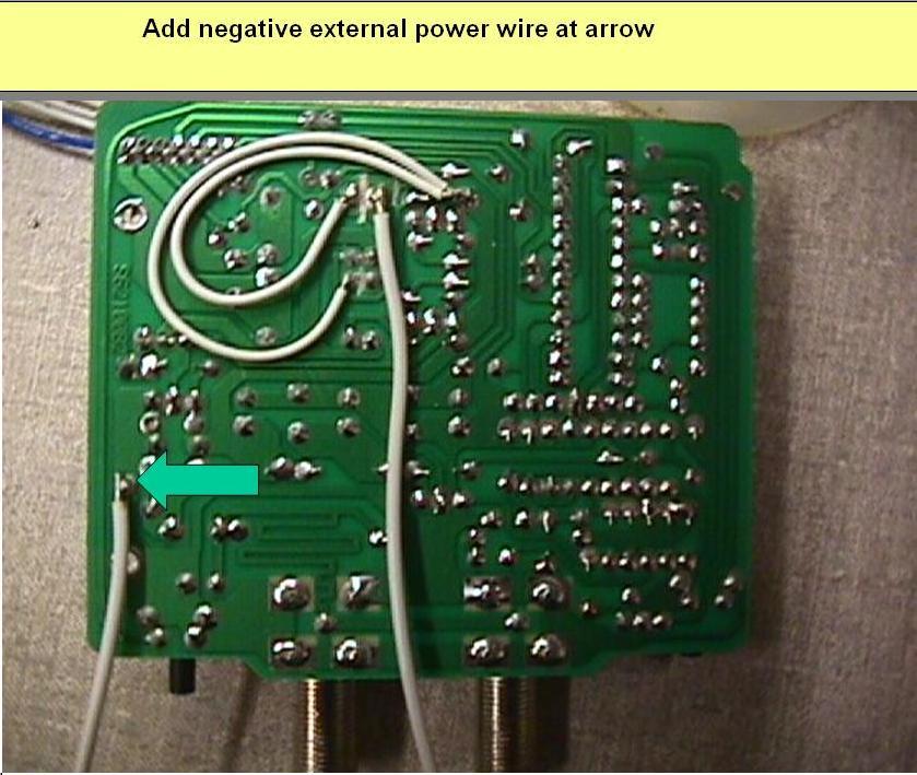

FYI, I've been using two SG2100's (both are the one button version)
with just DVB cards for a few years.
One with a Twinhan 1020, the other with an SS2 ver. 2.6c.
The motor the SS2 controls has been modified (Positioner Heart Surgery, as
recommended by Jerryt).
Have not had problems with overshooting positions (but I'm not using USALS).
recommended by Jerryt; see attached).
Like I said, you have to use an external power supply. I stand by my advice to use a FTA receiver to control his motor. :up The average FTA'er probably doesn't have the skills to mod his motor like shown in the file. I know I don't.
The motor used with the Twinhan is NOT modified and works fine!

I will agree with Stogie above, that the Heart Surgery fix is a little drastic for most FTA users.
I've looked at it, and while not difficult, does open up a whole new can of worms.
The least of which is how to get power into the motor through another waterproof connector.

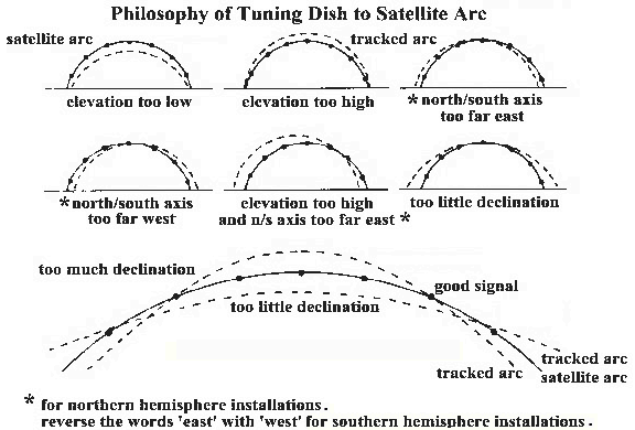

Well, there's still a possibility that your motor, pole, mounting brackets, or dish has taken a mechanical hit that you've overlooked.
It would be wise to re-examine all steps of the install, just as if it were entirely new.
The page in section eight of the STAB manual and a similar table in the GeoOrbit site (picture below) show what to do to align a motor.
Following those instructions to get back onto the arc, should get the job done.
Of course, if the motor is off center, that could kill ya. :(
