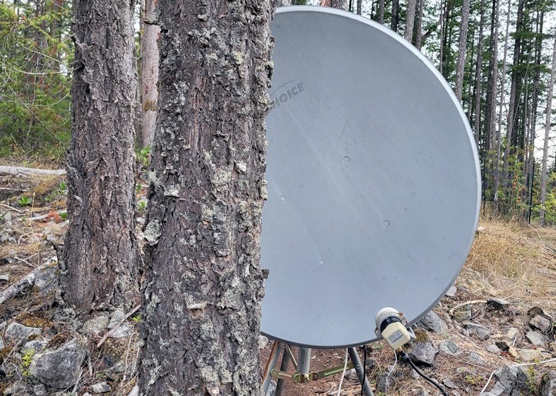

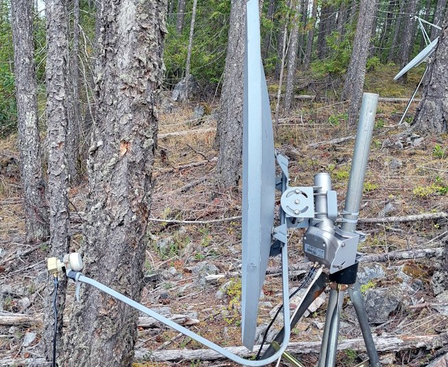

Today I noticed my new Stab HH120 could, in theory, rotate around to see 180E Ku. I don't need it to do this since I already have a fixed dish on that satellite. But I just had to try.
In the first photo, you can see when it's rotated to the correct azimuth, the LNB arm of the 41" dish is just shy of hitting an adjacent tree. You can see in the background in this photo the fixed 1.2m inverted dish precisely aimed at 180E and working fine to receive Tahiti Nui TV, France 24 plus radio channels.
180E is 63 degrees west of my due south azimuth. The Stab can handle that using USALS which is so accurate that I can move from 150W to 72.7W using USALS and catch all satellites on the arc. I stopped using diseqc commands since the USALS is more accurate.

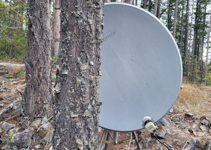

The photo below shows the adjacent tree "shadowing" the dish just a little!
Bottom line is I checked for 180E, 177W, 159.4W, 150W. Nothing found except for 69 data tps on 150W. I think the trees in front of the dish are what blocked the signal from 180E. Oh well...back to using the fixed dish.

Elevation to 180E ftom here is 12.7 degrees. The mounting bracket is an issue. Also this means the offset dish would be aimed physically down by over 10 degrees and the dish lip would hit my tripod leg support and be restricted from freely moving in azimuth.
So I inverted the mounting bracket and dish. Now the dish is physically aimed upward at offset angle (24.6 degrees) plus elevation (12.7) degrees for 37.3 degrees. I can reach the LNB for adjustment using a short 2-step ladder.
