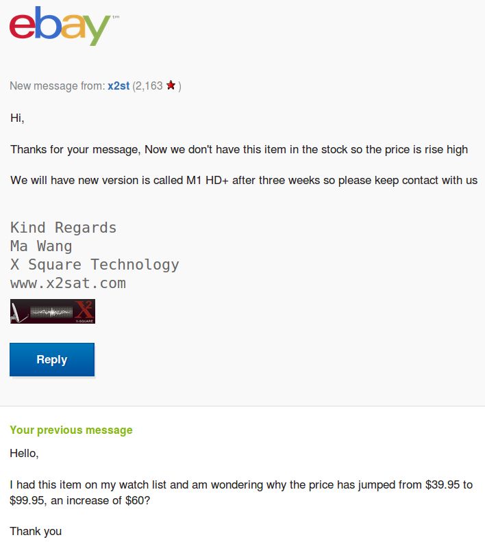

Being a little PO'ed at this I contacted X2 via eBay yesterday to see what they would say regarding why the price had gone up so high. I figured I would not get a reply. I checked my messages this morning and I actually did get one the same day. Here is what they said:
View attachment 119259 (Thumbnailed - Click to enlarge)
Two weeks ago they said they would be releasing a pc editor for the M1HD and now the receiver isn't available and they are coming out with a new one? o_O It's up to $199.95 on eBay now so I'm guessing they really don't want anyone to buy one yet it says only 91% have sold. I won't hold my breath but I'm hoping they at least still come out with the editor. :(
