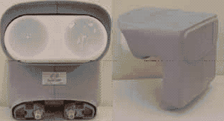

Just one thing I noticed, you say "500 with a Dual Pro LNB". Are there two LNBs or just one with two eyes? If you're using two dual DP lnbs, make sure you place the diplexer after the DP21 switch. If you're using a DP Twin or DPP Twin it doesn't matter since those lnbs have a switch built in. Look at the pictures below, the first one is a DP Dual lnb and you'll need two of those for 119 and 110. The second one is a DP Twin lnb.

Thank you. I have a twin DPP. It has worked, but I do notice acquiring sat signal alot now and not all the channels fromt he std. cable com across very well.
