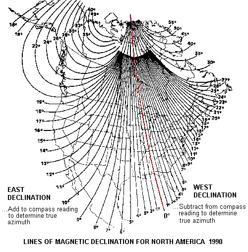

DEC = the magnetic declination so you can properly read your heading compass to aim the dish. (see attached) and I see that as more than +3.1° that you were told. Closer to like +8°

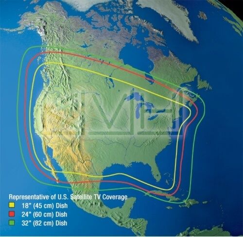

You could have a dish the size of the space shuttle, but if the signal you want isn't "falling on you" then you have nothing for the dish to gather. If there is some small signal, you could try it, but the larger (higher gain) the dish, the better; like 36" or more. DirecTV has been tightening their footprints for their USA services. You will read the occasional post saying "I get it great", but that is followed by you spending insane amounts of money for a big maybe; and then that poster will never be able to physically assist you. Just be very wary; of wasting money on maybes, when you can easily get some legit area service too. Good luck!

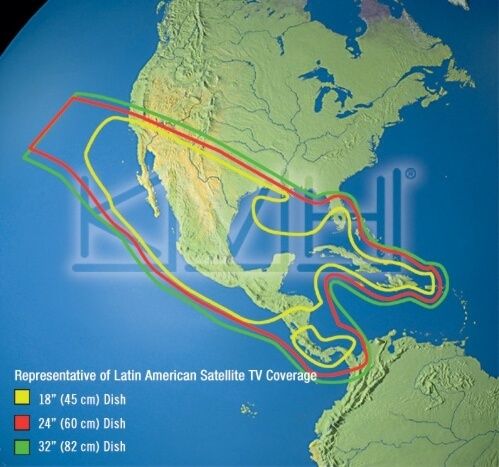

These maps are not scientific, but a best guess. (see attached) #1 DBS USA - #2 SKY Mexico
Maybe check into legit Latin America services:
http://www.directvla.com/
OR
http://www.sky.com.mx/
P.S. Have you called DirecTV and asked them if they can point you in the right direction for your 2nd home's service?
Well I think you are right, the footprint doesnt hit me. I guess my next option is the slingbox by slingmedia, I just dont know how good the picture is in fullscreen mode. If any one has any information on this product or any other ideas about the satelite. Thank you harper 1, you have been a great help, I wouldnt have been able to rule out direct tv without the footprint map. I wish I would have had this information before I decided to go with the dish over the slingbox, now here I am two months later no farther than when I started. Keith
