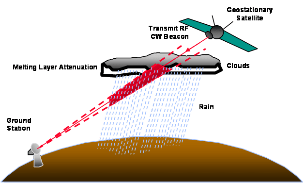

Now imagine that storm is directly over the dish. The path of the signal would go through less clouds and rain than it is in this picture.
