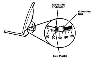

And of course make sure the dish elevation is set to the "Elevation Indicator" at the edge of the mechanism as in the attached image. Not what you estimate is the center of the "Elevation Nut."
A common mistake many make ...
