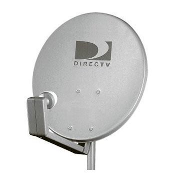

Would a D12 receiver pick up DirecTV satellites using an existing in-use HughesNet dish utilizing a -3.5db 2-way splitter?
No, it won't work through a cable splitter.
It will work off the dish though.
If the LNB has 2 ports, the dish is capable of handling 2 receivers.
If you need more, then you will need a mutiswitch.
The location previously had both data and video back when it was DirecDuo. I'll have to check to see whether there are two coax lines coming down from the roof.
I missed something, is it a big oval hughesnet internet dish or is it one of the old direct tv 18" dishes that said Hughes on it.
Two completely different dishes.
One will work and the other will not.
It's actually almost rectangular with the short edges rounded. It's over 3 feet tall.
If it looks like this but with "Hughes" written on it, it will work
If it does not then it probably won't
