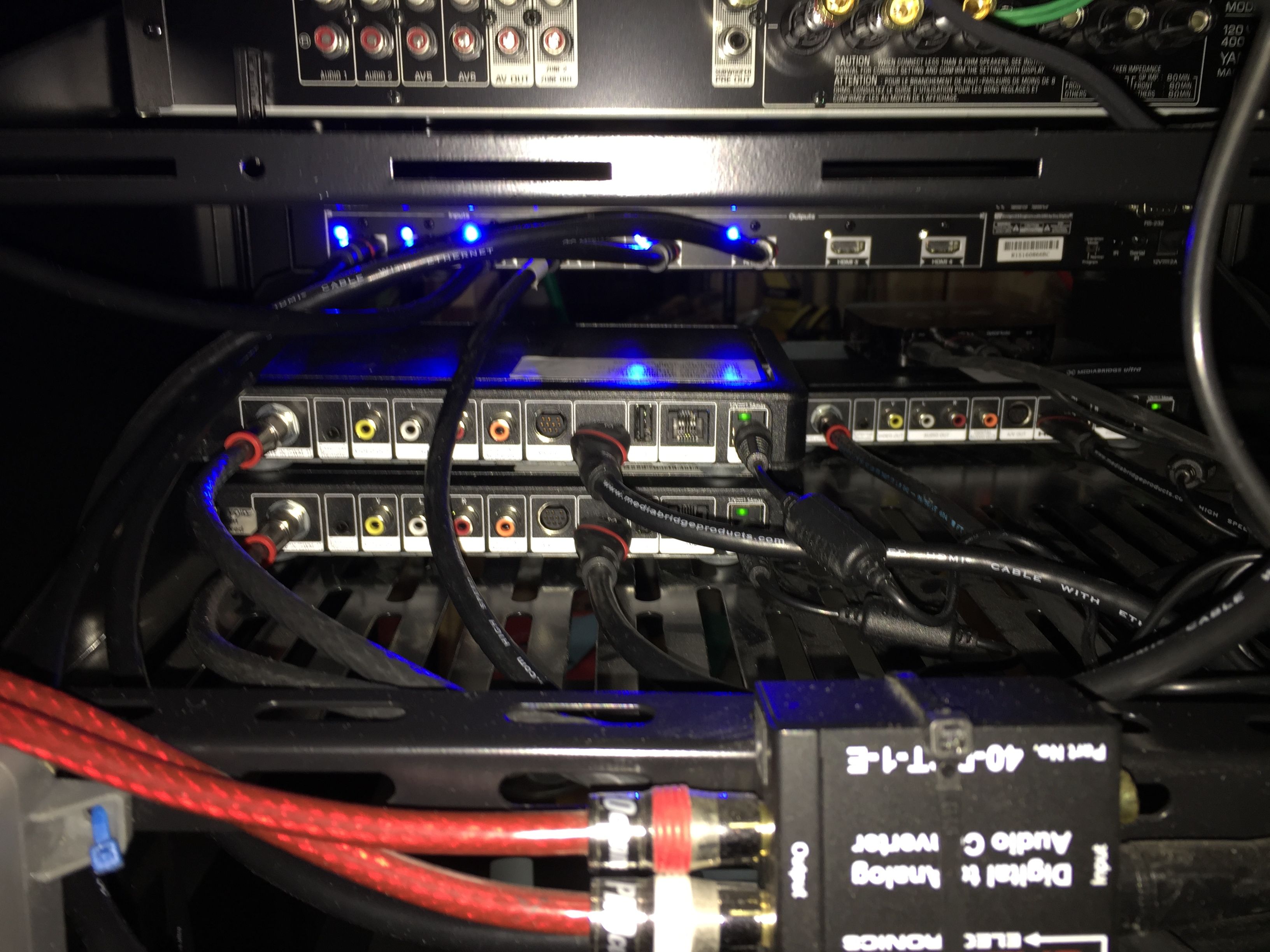

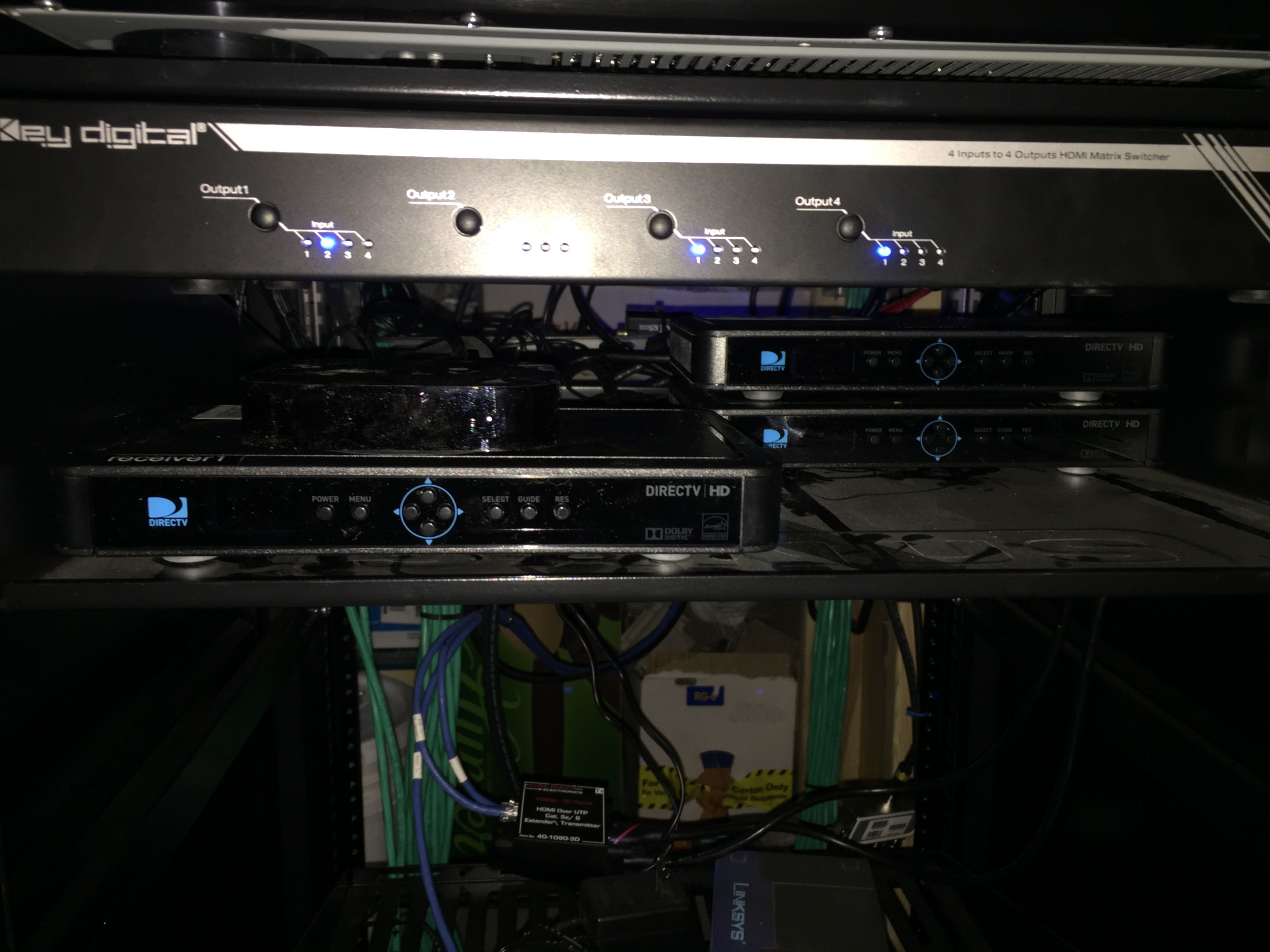

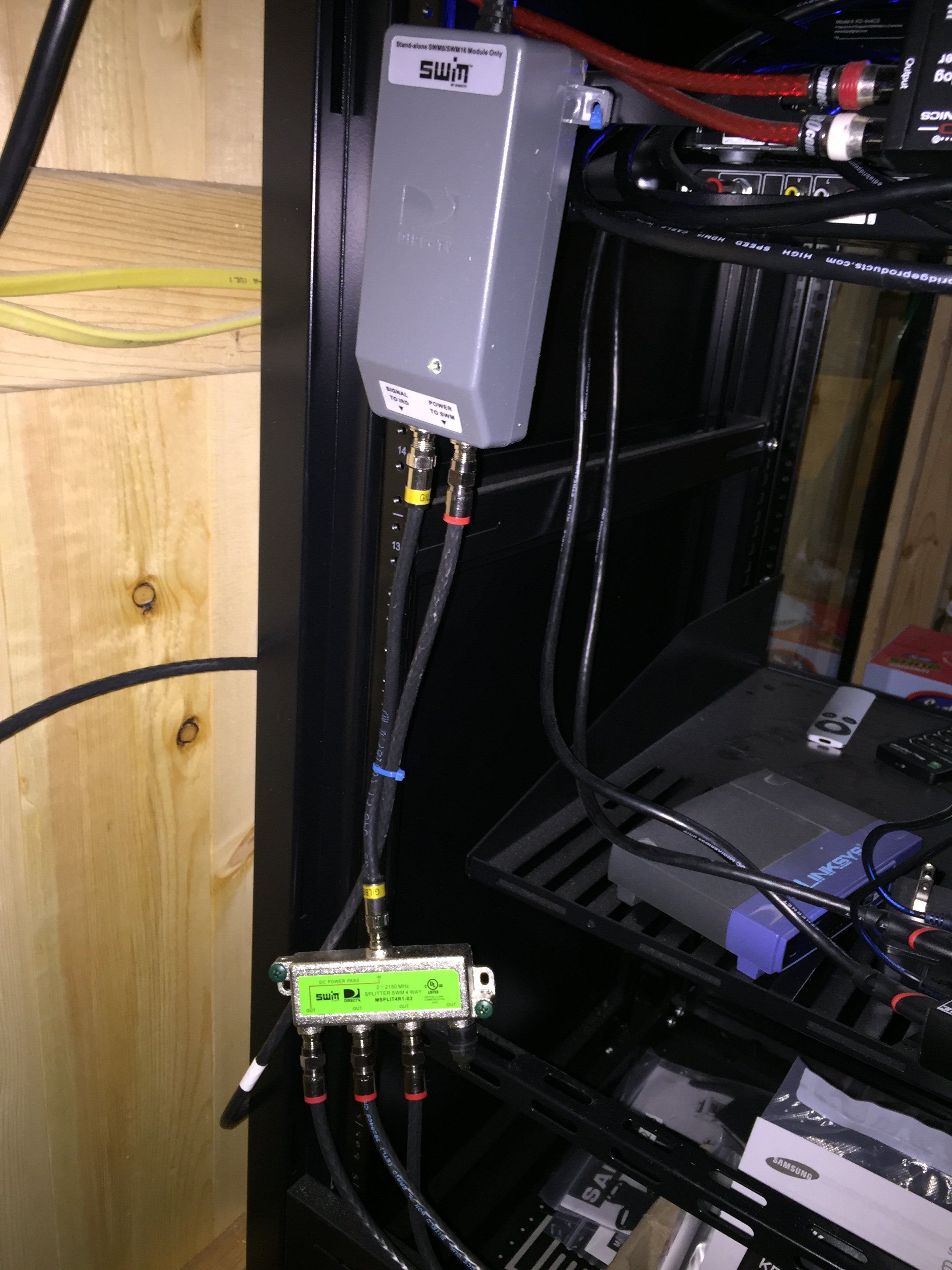

Here's my install. Hopefully it's sub par. Can anyone tell me why I can't get the remotes that came with my H25's to work in RF mode? They are model #Rc66RX. Thanks.
just for kicks and grins, if your router is down there (i see a linksys, only reason i mention it) you can install a broadband deca in that last spot on the splitter and use your smartphone as the remote too.
