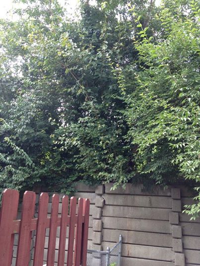

Here is my backyard facing Southeastish isn't the LOS more Southwest for both D* and E*?

Your azimuth would generally be ssw, specifically it's 211° magnetic. I agree with the recommendations to download one of the satellite finder apps. I have SatelliteAR and find it to be reasonably accurate.

Since the elevation there for DIRECTV is 41 degrees, having a setback from the top of the hedge of about 1.3*(height of the hedge - the height of the pole) should get you where you need to be with a little room for growth. It may be tight.

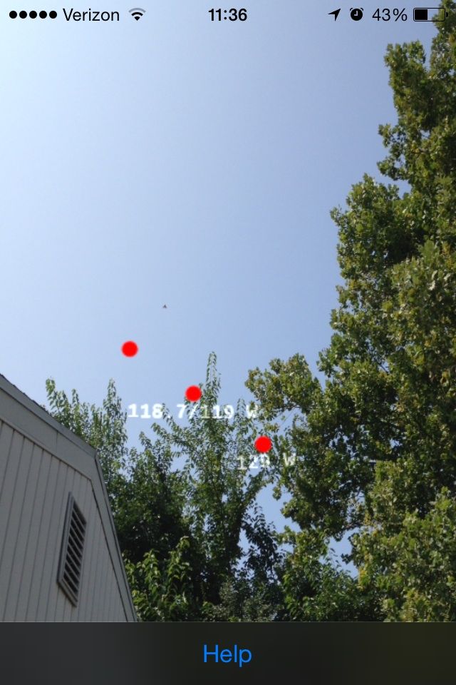

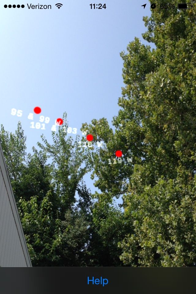

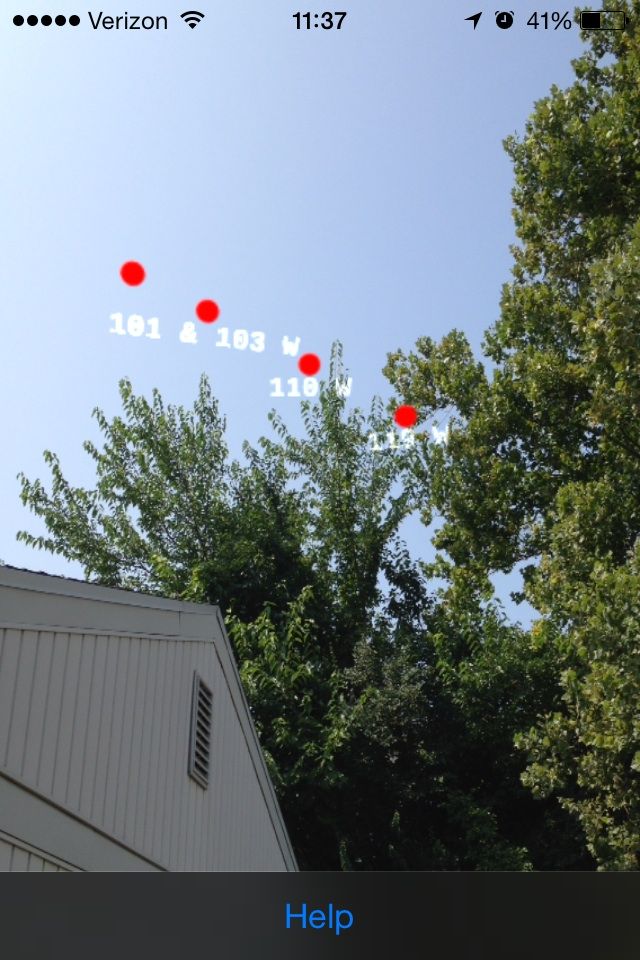

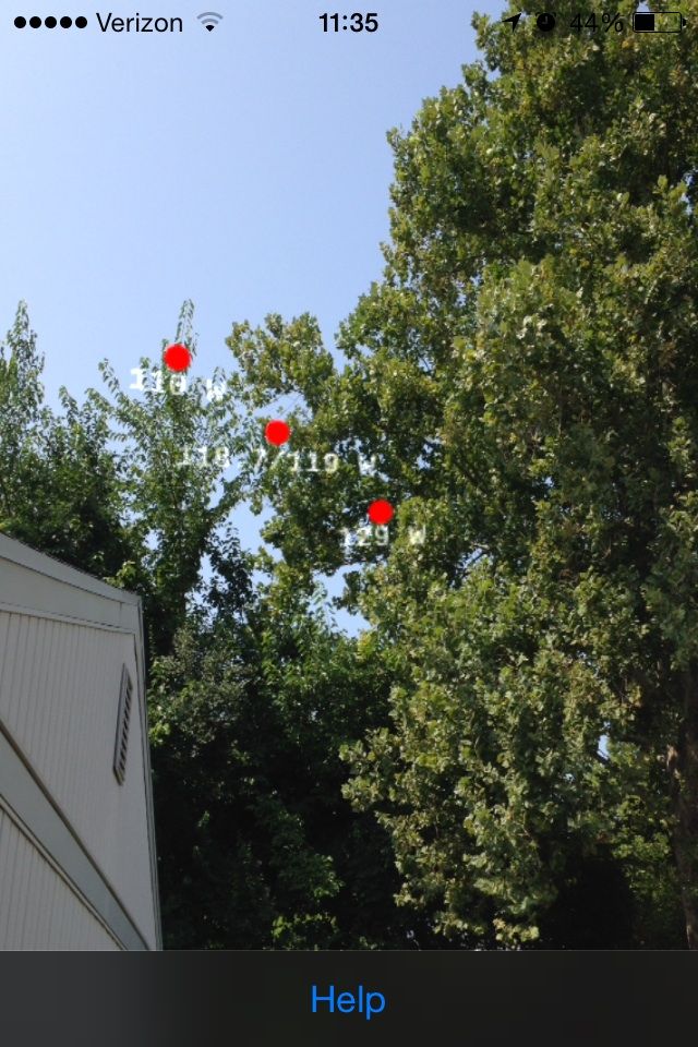

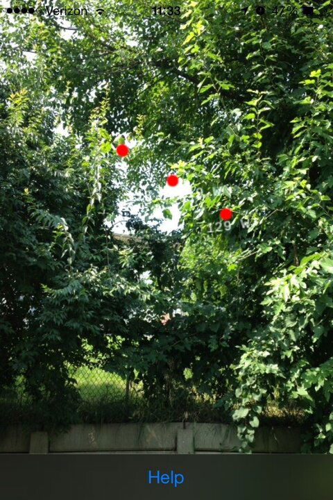

Thanks guys! I ordered a second opinion yesterday for Directv. I also downloaded the SAToolz for D* and E* and took some pics with it outside on the side of the house and in the backyard to show the best positions I could find to get the sats. I'm 6 foot tall and I tried going on a knee to get close to how the dish would sit.

Since your area has the local sd channels on 119, you will likely need to use a 3lnb, since it looks like 119 is out of your los. You may need to have an independent installer rather than one from Directv if they won't use a 3lnb in your area.
Reactions: Broe67
Jerseyfla, you are in the same type of situation I was, when I had mine installed. I ended up having my installer place it up on the garage, since that was the only place to get above the trees in the neighbors yard behind my house. You may have to go up higher, and over some, to get a better shot of 119.
Have you talked to base maintenance about maybe trimming that tree that is just cutting off 119. They may do it if they are not overloaded with other duties that week. It is maybe taking 4' off of that tree to the right, and maybe 2' on the one in front.
