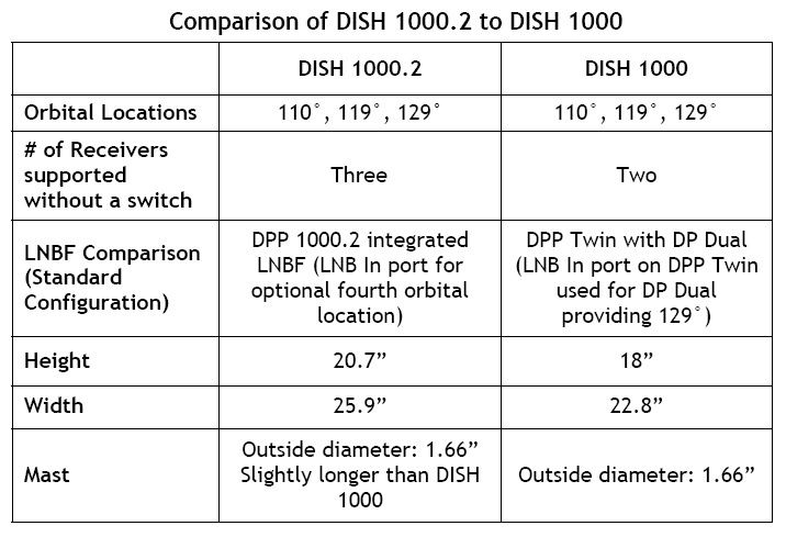

We were using the same reflector for the 1000 and the 1000.2. The only difference was the arms were different. We havent done many of the 1000's since we got a lot of .2's. That was interesting that the sizes of the reflectors show different between the 1000 and the 1000.2
Updated 6-17-07, corrected size of Dish 1000.2
The reflector on the 1000.2 they put up as a replacement for my 1000 was definitely not the same as the reflector on the 1000. The installer and I checked it out closely. The 1000.2 is a little larger and I get much better signal strength, especially on 129.

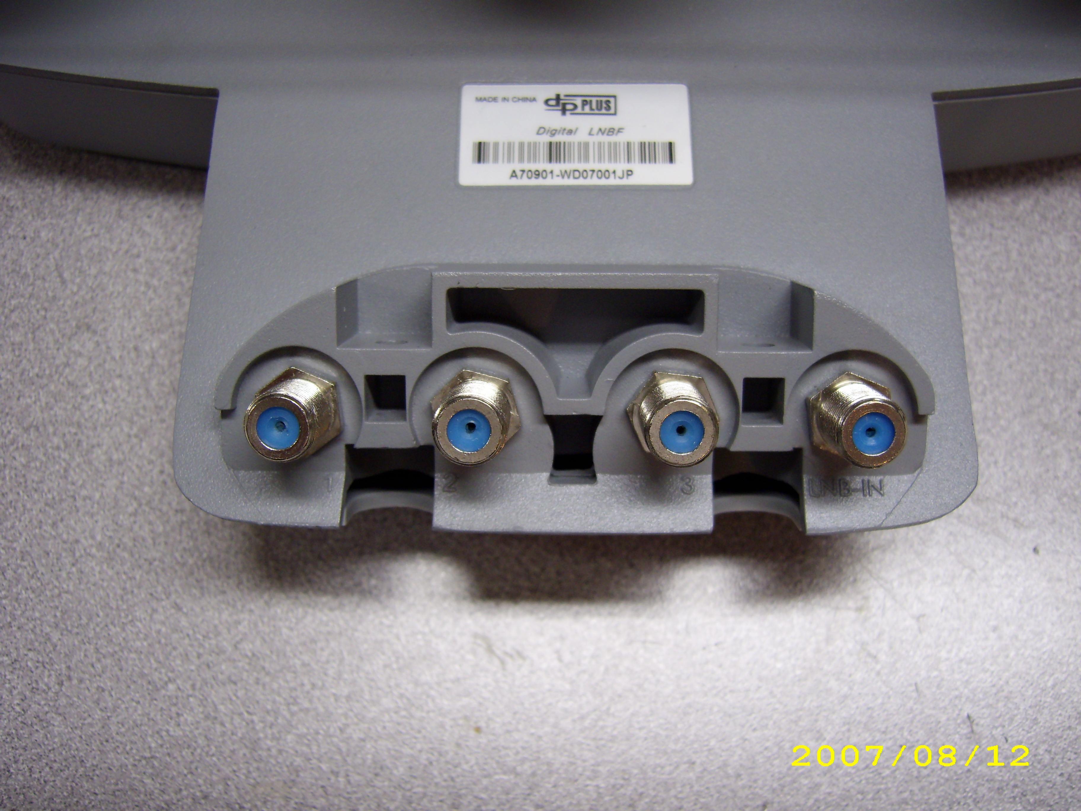

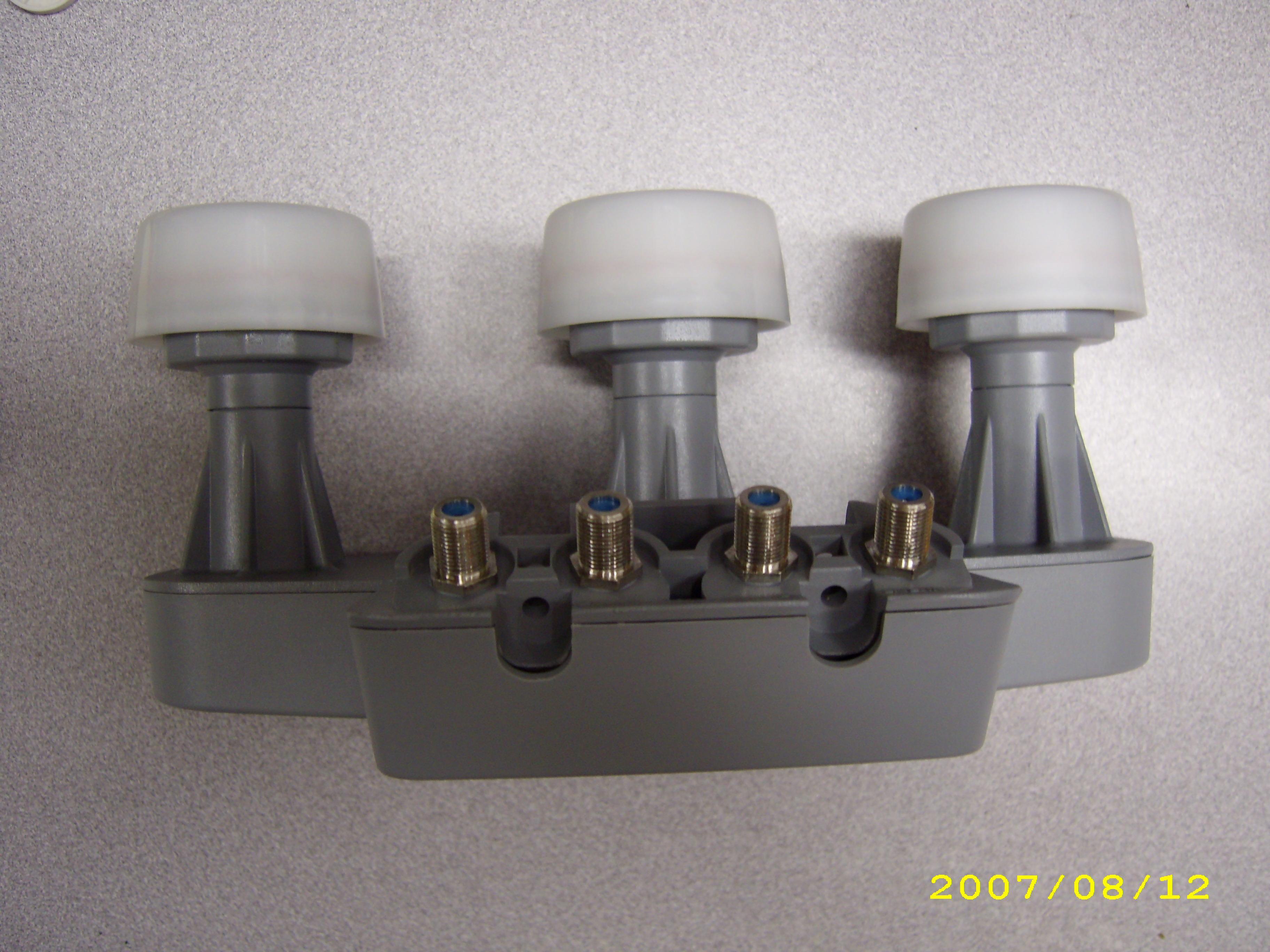

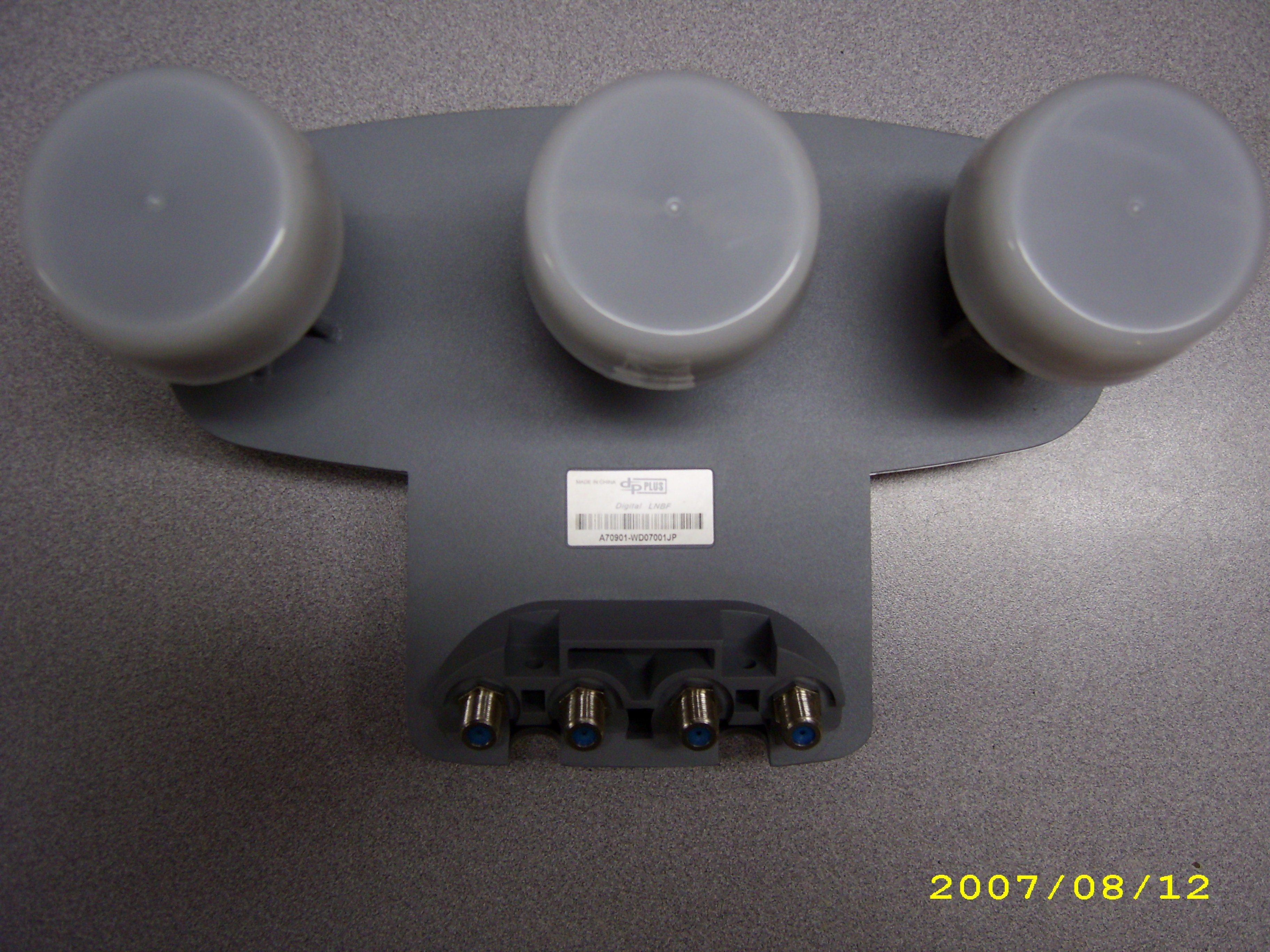

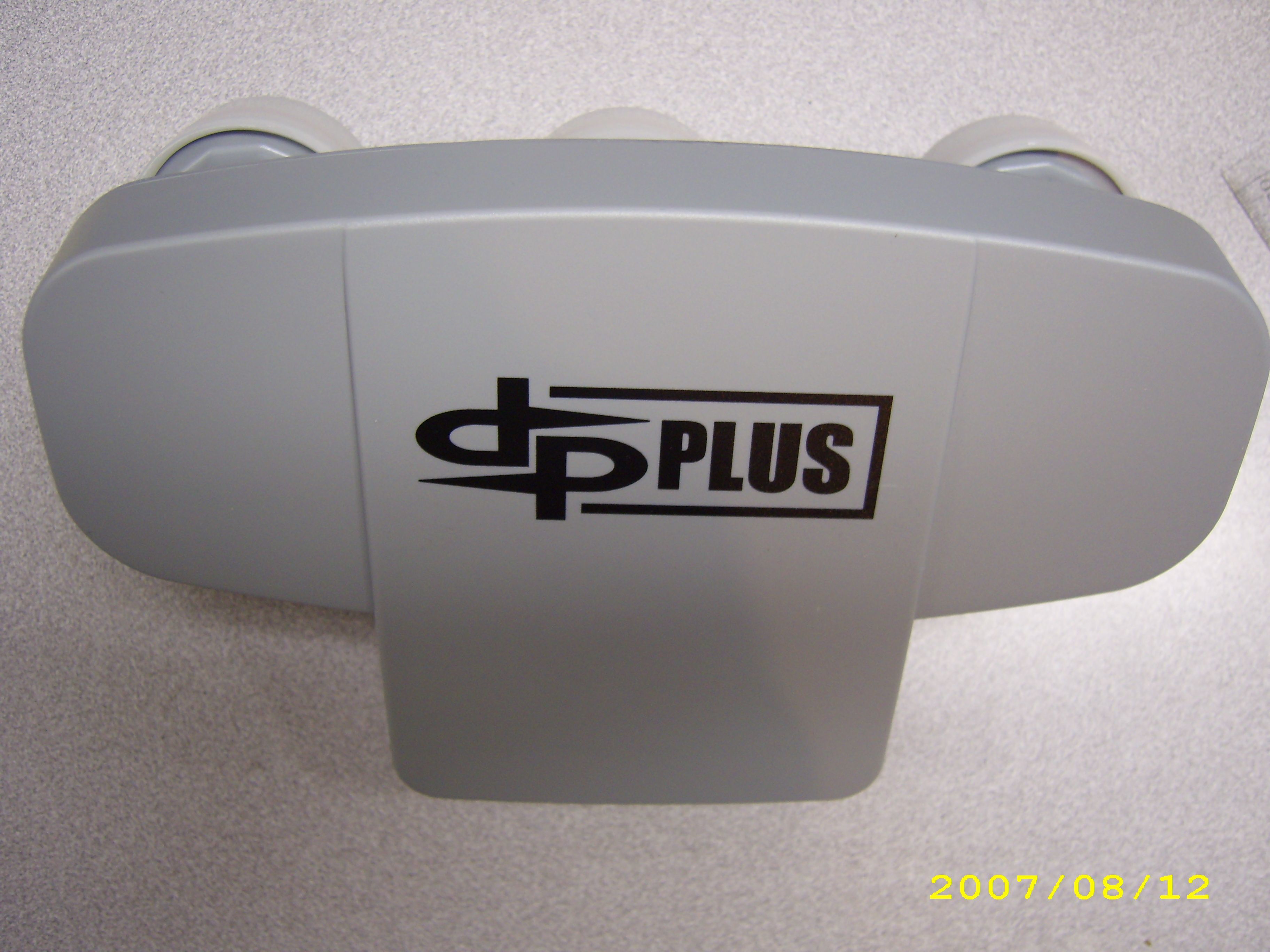

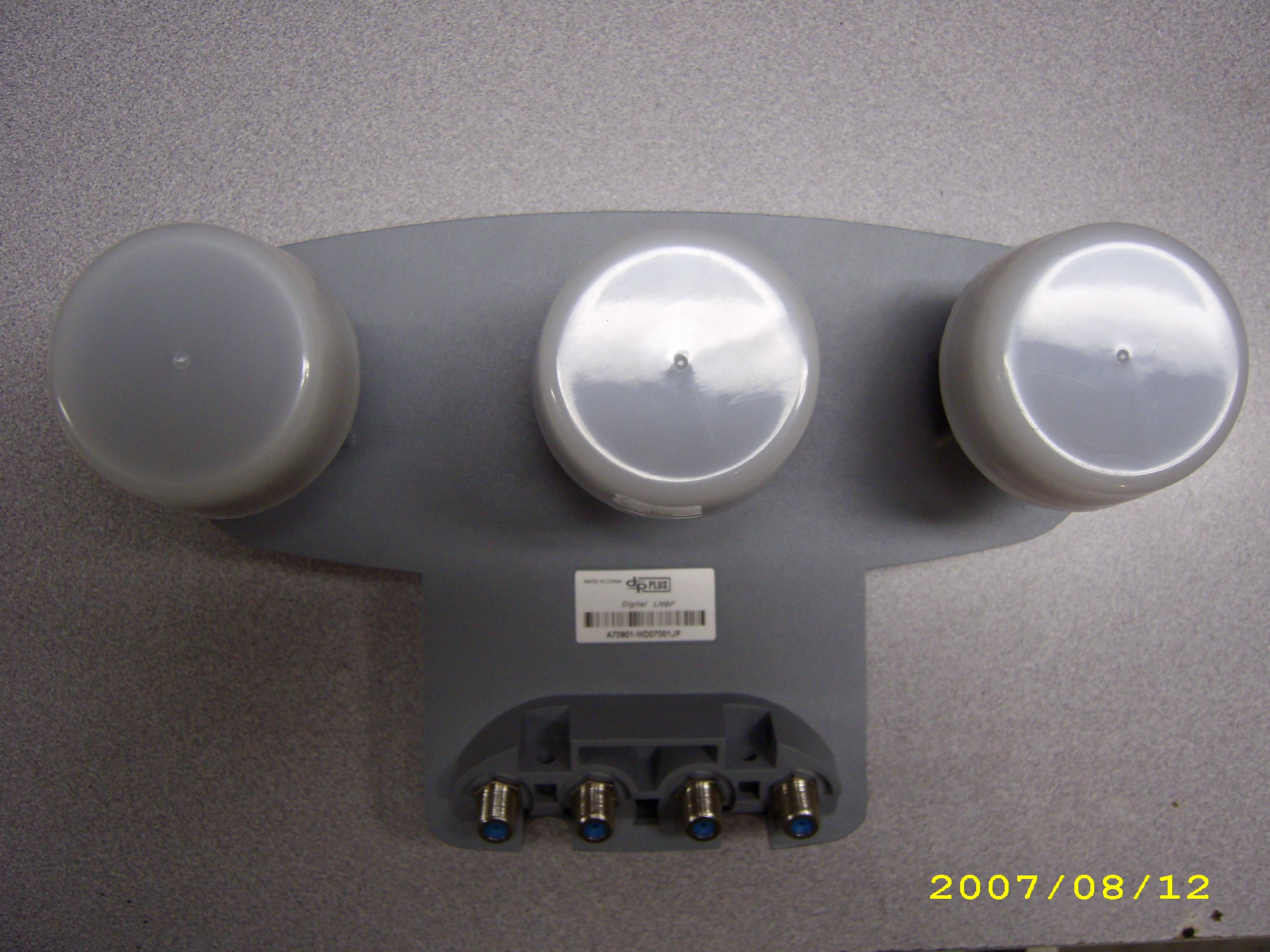

Pictures of Dish 1000.2 triple LNBF.
