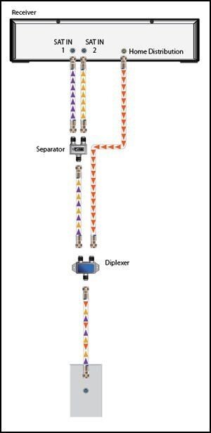

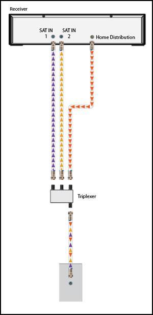

Here are some simple diagrams of how the diplexer + separator and the triplexer work and are commonly used. Note that the triplexer is just a combination separator/diplexer all-in-one :-
Diplexer | Triplexer

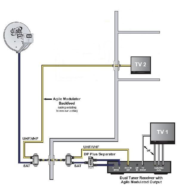

There are diplexers on each end of the single coax line, as shown in the following simplified diagram :-
