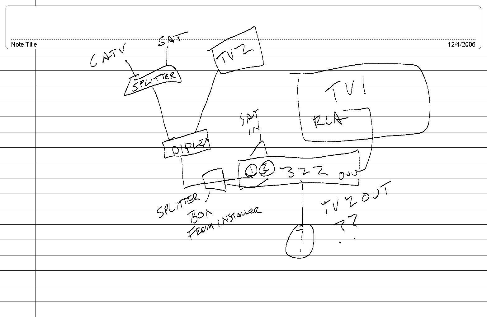

ok I couldn't wait till tomorrow so I tried it out and ended up fubaring everything. Here is a pic of how I have everything now, I have a tablet so hope you can read my writing... and 2 minute scribble. feel free to tell me how bad i screwed up and what needs added where.
heh... good try. let me work on something for you.
This diagram requires a seperate CATV line coming in to the room of the 322 but this would work.

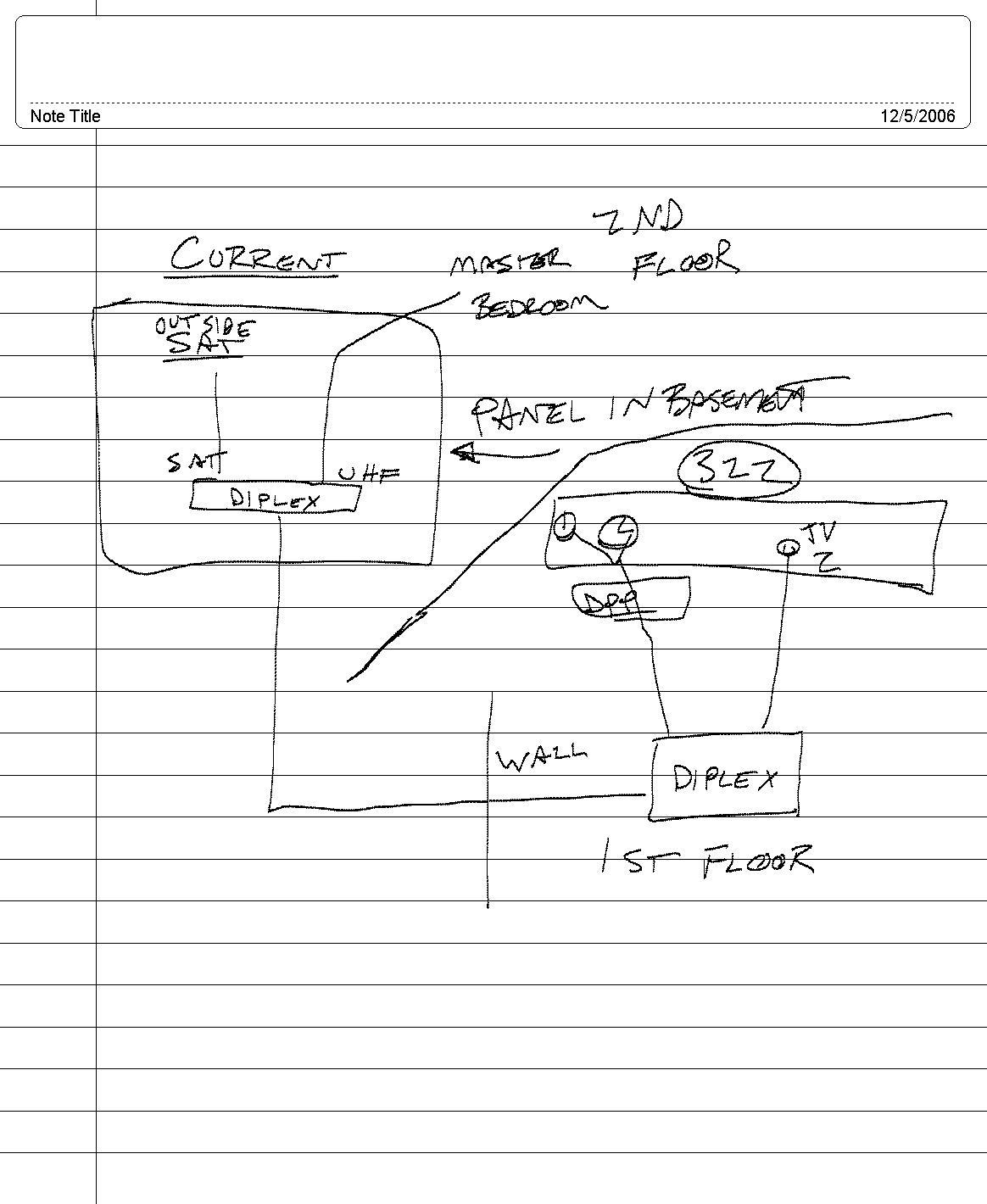

after looking there is no way that I can do a seperate run for catv in the room where the 322 is. My house has a dist. center in the basement where the catv and sat come in, along with phone and other stuff... it appears that all the RG6 has been stapled and there is no way to go over and up a story to run another cable without tearing out a ceiling from the basement to the 1st floor. So is there a way you can modify that diagram to show for one cable. My house isn't but about 4 years old, and I know all the cabling is rated 2GHz+ RG6. Right now with the catv they way it is at the dist center is the cable comes into a 6 way splitter with home runs going to each outlet, three stories in all. So the sat is using two of those runs, one for the living room (322 location) and one for the master bedroom, third floor.
Here is a little better picture of how the installer did it, I finally got it figured back out...

That looks correct for the current setup. If you want just one room to have locals you could hook up a splitter between the 2nd bedroom and the diplexor in the basement and hook the catv and the TV2 output on the diplexor to that switch then hook it up to the cable already going to the 2nd room. For both to have cable I'm not sure how that would be implemented. It would take some testing. possible having 2 splitters at the basement diplexor. one splitter to send the catv signal to the living room and one to send the catv signal and tv2 signal to the 2nd room. and hook up a cable between the two splitters to keep the tv2 signal going. However, I'm not sure if this would work. I will have to sketch this out on my white board here at work.
Here is what I came up. This is extremely suseptable to intermod so I don't know if this would work 100%. Try it out if you have the splitters. You might be able to get some free splitters from the cable co.

i'll have to try that... one TV (TV2/bedroom) is the only one I'm really concerned about getting the catv on. last night i was playing around and managed to get catv up there, but lost the sat, tried playing with the modulator switching between air and cable, probably just did it wrong. I'll try your diagram!!
quick question... is a splitter and combiner the same thing? or are there splitters that are just splitters, not combiners...
finally.... I have got my catv and sat on TV2, thanks everyone for all their help. I believe my problem was that I wasn't using a "good enough" splitter. I bought one that goes up to 3GHz.
I do have one issue however... at first I used a simple set of rabbit ears and came off the back of the TV with the splitter and was able to pick up only my nearest local station (5 miles awy) and it looked great and the dish looked great (ch 73 modulator). However when I have the catv hooked up with the splitter in the basement where the catv comes in and the dish comes in, the catv looks great (ch 2-13), but the sat (ch73) is snowy. Any advice? Can I put an amplifer on, I also have a little, I guess attenuater that the installer left me, but I don't know what it's for.
The attenuator decreases the signal output from your TV2 out. Make sure that is disconnected when using splitters or running longer runs. You may need to hook up a amplifier behind your 622 but the 622 I believe already puts out like 25db of signal so that should be plenty for up to 100' of rg-6.
