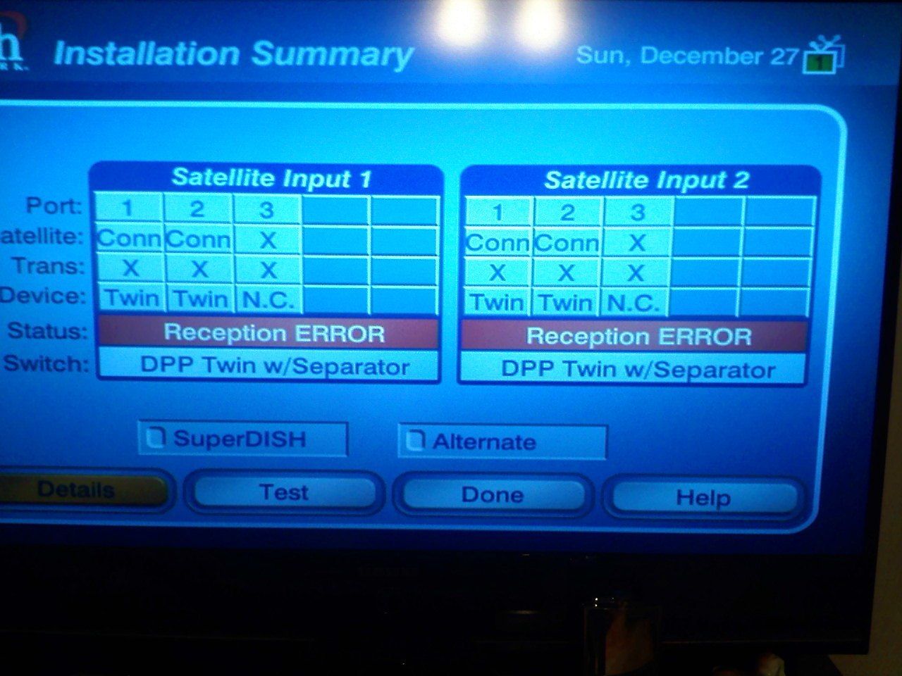

i am having trouble with 3 dish 500 DP lnb. i can't get any of them to work. can the switches be checked without the lnb mounted to the dish on this type. here is what my screen on my tv looks like when i do a check switch. all three do the same thing. i hope someone can help me.
rodney

It looks like one of the LNB's has gone bad. before you call in disconnect the sat lines coming in ahd run the chk switch again to clear the matrix. Then hook it back up and run it again and see if it comes back the same. If it does you are missing the 3rd LNB which most likely be bad LNB or maybe bad switch. Could it be the 3rd LNB has gotten disconnected some how?
thanks sir, but i don't have anything hooked to it but the back of the reciever, nothing on the sat in. it's funny how all three can be bad, but i guess that is what you get when you buy for fleaby.
how can i point the dish when the box want read the switch so i can adjust it, shouldn't i be able to do a check switch without the dish pointed at the satellite.
Call a professional.. Chances of 3 bad LNBs are slim.. Dish MUST be pointed correctly for the switch test to give you anything. POINT the dish correctly First.
