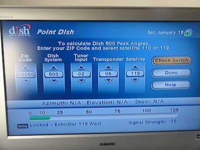

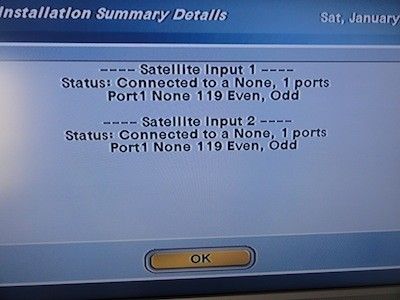

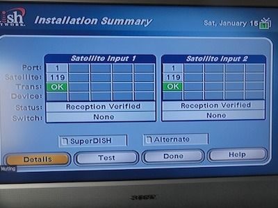

Might not be the techs fault. Do u get all the channels or r u missing some. Rake a pic of the check switch screen for me. Just hit menu 6-1-1. Then hit select on check switch and take the pic of that screen
Here are a few screen shots. The signal isn't strong at this location, but it works! Has been this way before and after EPG problem. HTH

My guess is your signal strength is too low on TP 7. It's significantly weaker than TP 6 that you are showing there. If your signal strength is that low on TP 6 then there is a chance you are not picking up TP 7. What is your signal strength on TP 7? TP 7 has the 9 day guide. Also, what about TP 18 & 19?
It happened late this afternoon ( 1/16 )! The signal strengths all improved... and I hadn't been anywhere near the dish. While I know many of these are marginal, what is amazing is the improvement from trs I hadn't received before. I'm a novice when it comes to satellite reception, I thought these changes might indicate that DishTV had been doing some 'tinkering' with their transponders, much like last summer when we saw big changes in signal strength here (mostly weaker) as they moved footprints north of the border.
