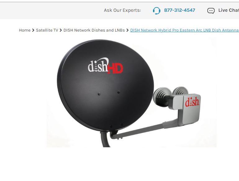

I purchased a "Dish Network Hybrid Pro Eastern Arc LNB Dish Antenna (DISH1000.3-EA" from solid signal which is for 61.5E and 72.7E satellites.
When I go to "MyDish" to get aiming numbers, they do not list a 1000.3EA as an option. They only list 1000.2 or 1000.4?
When I go to "DishPointer", they only list a 1000.4 (61.5W, 72.7W, 77W) which I believe is a misprint as it should be "61.5E, 72.7E,77E"
The numbers are different between the sites which I assume is because Dishpointer is more precise as they zero down to an address and not just zip code like MyDish.
My question is, what numbers would I use for my setup since they do not list my dish on either site?

Because it's not 1000.3. It's 1000.2.
Give me a couple minutes and I'll give you the exact settings for that dish. And BTW, I'm from Buffalo!
The dish is down near Cuba, NY 14739 zip code. Are the settings you gave me the same for that zip code then?
GO BILLS!!
Yeah, those same settings will work.

The "1000.3" is a designation that Solid Signal seems to have invented to differentiate the 1000.2 WA and the 1000.2 EA setups. The dishes are identical except for the LNB. The 1000.4 also has both WA and EA LNB's available. The 61.5 W, etc. is correct for the western hemisphere sats.

Actually, west is correct since (almost?) all geo sats for the western hemisphere :D are west of the prime meridian.
