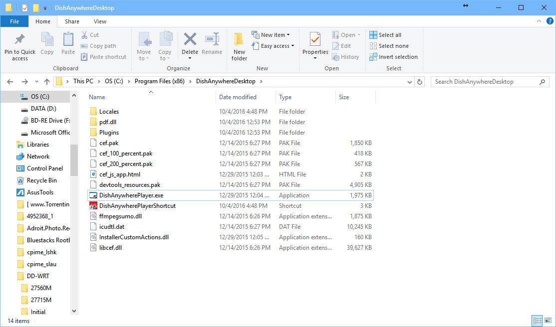

Still have not seen the updated version of the player yet but I've managed to recreate the problem even without rebooting as basically I have to quit the Desktop player in the system tray. Then goto the folder C:\Program Files (x86)\DishAnywhereDesktop and set the Compatibility on DishAnywherePlayer.exe and have it set to Run As Administrator which will allow the Player to work correctly as watch Live on dishanywhere.com will run the player on it's own. If I take the Run as Administrator setting off after quitting the Player, then it will end up with the not enough storage space again so it seems like the issue is related to permissions.
I noticed the DishAnywherePlayer.exe icon has the UAC symbol but it seems that when I try to manually run DishAnywherePlayer.exe, it runs without prompting for UAC. Setting it to run under Windows 7 or Windows 8 Compatiblity mode does not prompt for UAC either. Running it under Windows XP (Service Pack 3) compatibility mode does prompt for UAC. It seems like the error is not there as long as UAC mode is prompted when DIshAnywherePlayer.exe is launched and works successfully which is the reason why Run as Administrator works.
Tony S, are you seeing the UAC Prompt when DishAnywherePlayer.exe launches? Since if a .exe has the UAC shield as part of the icon, it's supposed to ask for UAC.

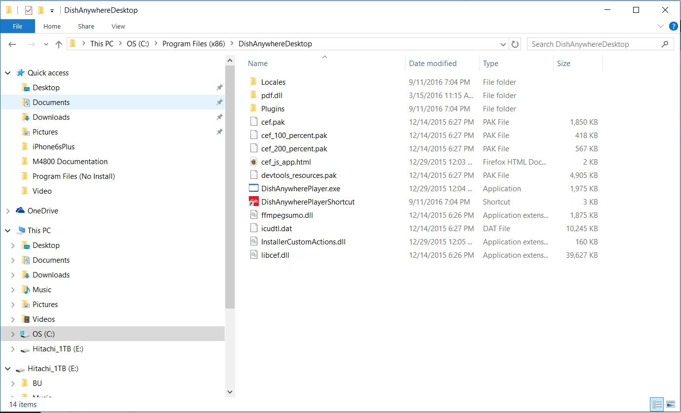

No, I never see any UAC prompts, and I do not have a UAC symbol on my DishAnywherePlayer icon. Also, I never had to select Run as Administrator in order to get Dish Anywhere to work correctly. However, the account that normally I log in with does have administrator privileges.
I am using a Administrator account but the DishAnywherePlayer.exe file in the folder has the UAC icon for whatever reason and Run as Administrator seems to fix the problem. The UAC symbol is not on the DisAnywherePlayer icon. Browse to the folder C:\Program Files (x86)\DishAnywhereDesktop and then look at the DishAnywherePlayer.exe file's icon, does yours have a UAC symbol? I've uninstalled and reinstalled and each time, the .exe file has the UAC symbol. Also, it seems like every time Dish Anywhere player works, if I don't quit it, my screen will not go to sleep. Even if you login with a Administrator account, binaries/executables will still run in standard mode and not elevated mode. Those files with the UAC icon will always prompt for UAC unless you disabled UAC then it always run in standard mode and require prompting to elevated mode. That's why when you have any executable file and you right click on the file, it has a Run as Administrator option.
