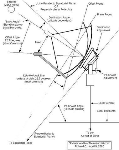

Got this diagram from the internet help me understand the concept of polar axis angle and look angle.
