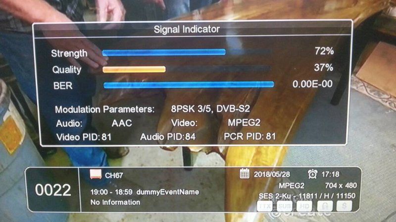

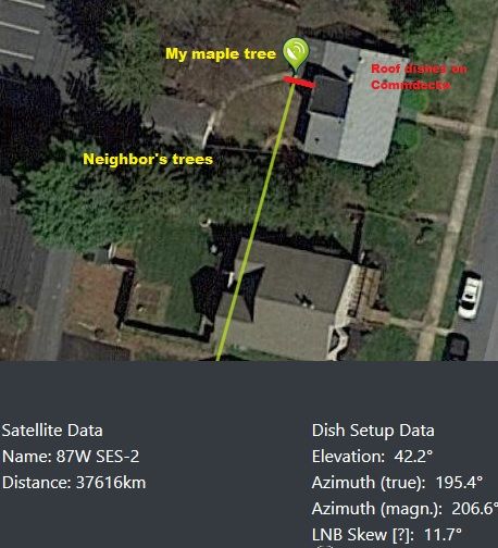

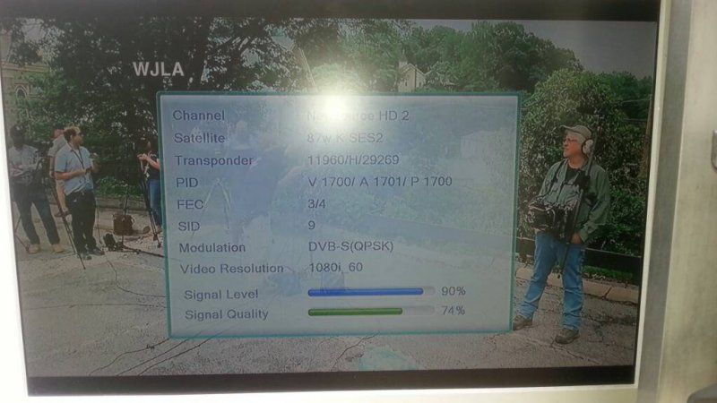

This morning, I removed the 76cm and it's now just the pole. I put a single LNB bracket on the 90cm (took off the geosatpro 4-degree bracket), and put in a geosatpro PLL LNB. It took me longer to get my little TV and MicroHD receiver up there, and get myself situated, than it did to get the MTA signals on 87W locked in. I switched over to the LPB signal, and it will not lock. All the fine-tuning in the world will not result in a stable signal--it jumps from 16% to 32%, and that's just not sufficient.
This was disappointing. I have an 85cm Zehnder at ground level aimed at 87W, and it gave the same results. I was hoping that a bigger dish would help, but it has made no appreciable effect.
I will admit to having a bit of envy. I read about some of you who pull in LPB on a 76cm, or get it just fine on a 90cm, and I cannot get it reliably. The MTA signals on 87W come in perfectly, but that LPB is elusive.
