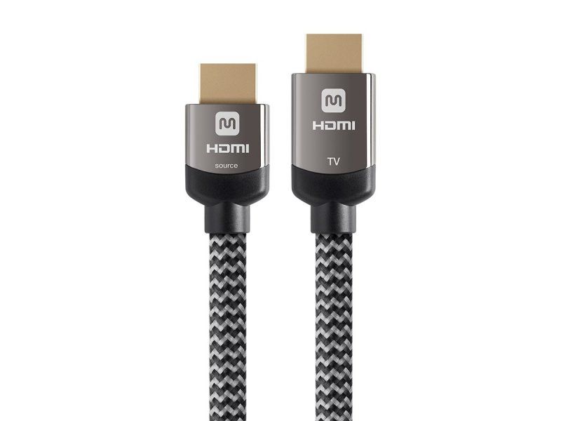

What is active HDMI cable?
Active, like this...
