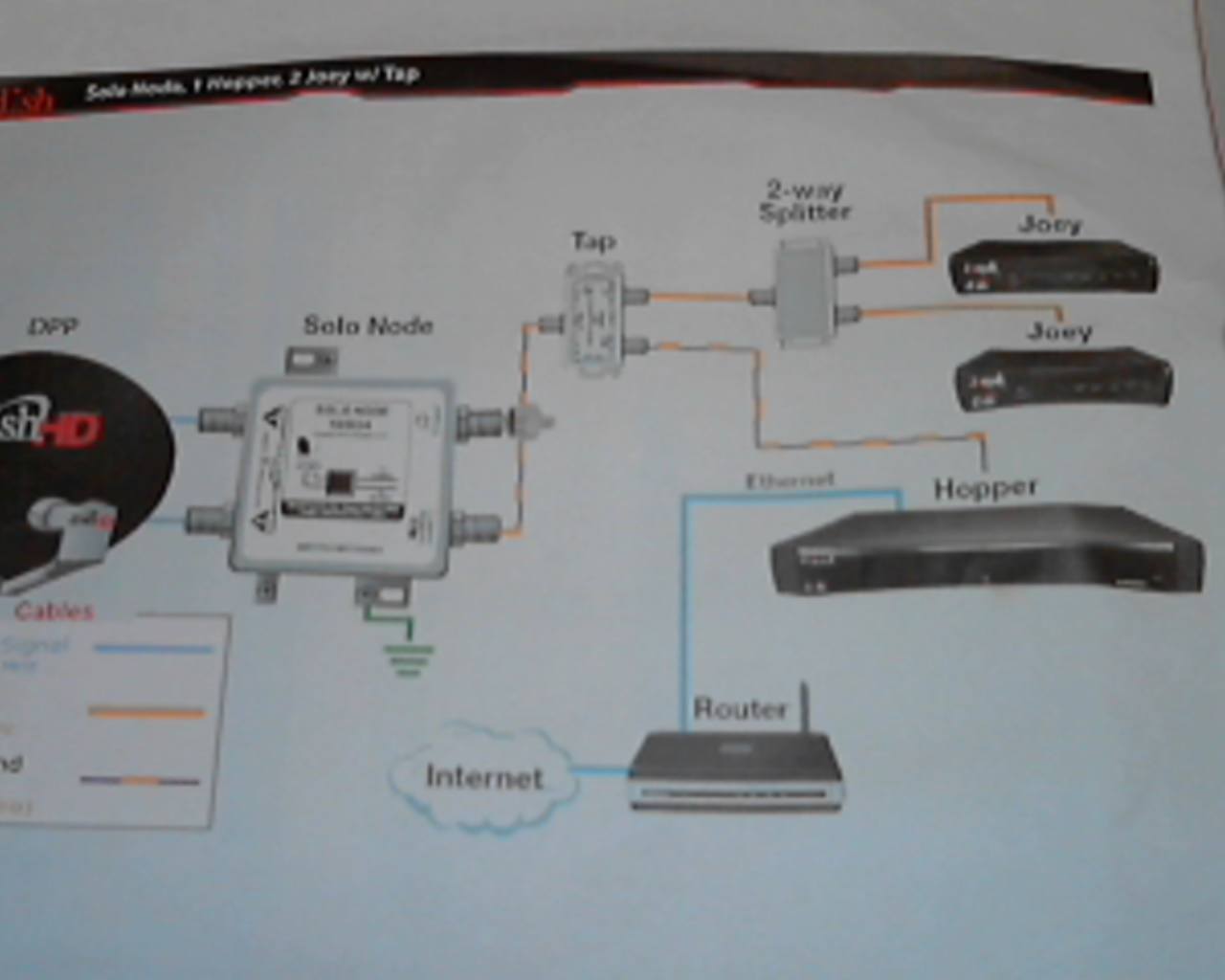

Ok so I was a tech at dish. for a single hopper all you need is two lines comming from the dish. they both install in a solo node. from their you will need a tap. this is the basic set-up one hopper with two joeys. from the tap you will need a 2 way splitter to run the joeys. This set-up is for a dish that is a DPP. I hope this helps. if you have any questions I also have the training guide to show you how the set-up works.

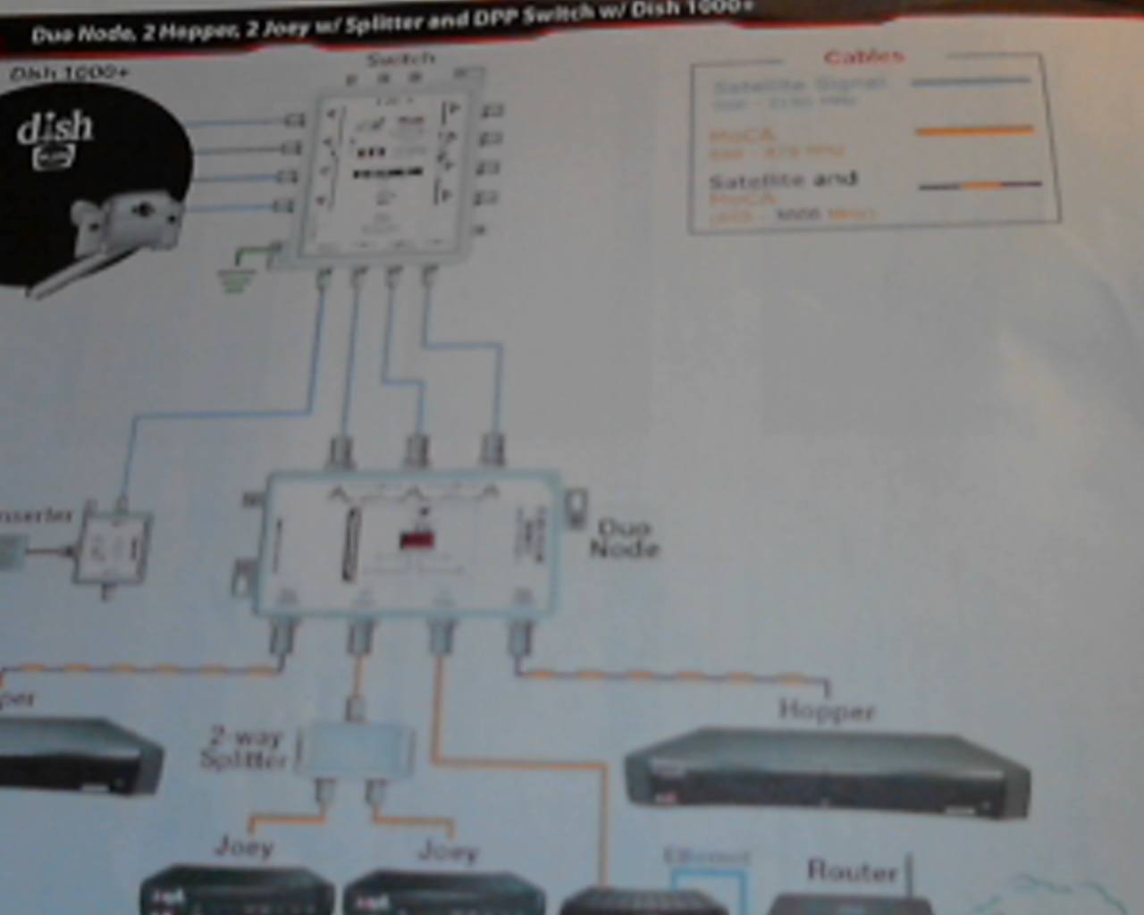

Can you send me a training guide for four Hoppers and one Joey and all can see each other from the source drop down menu and also looking at four satellites (1000+ Dish)
1 Hopper 2 joey set-up.
I was a tech at dish. The schematics for a dish pro plus is first you need to only use 3 gig cables or vextra cable that is what dish uses. Never use RG59 cable on a hopper system, it will work for awhile but then it completly stops working seen it happen first hand. You will need to run two cables from the LNB from port 1 and port 2 of the LNB. you run both cables from the dish to the Solo Node. You can install the hopper multiple ways, but the best way is to run two lines to the node in the sat. in feed then from their you use the main line not the client line. you then only need a Tap and a 2 way splitter. The tap is used from the node to the hopper. The other part of the tap is called then Client which is what you use to hook up the Joeys. from the tap you would hook up a 2-way splitter to hook the joeys up. Now the thing to remember is that the hopper needs to be hooked up first and complety downloaded before you hook up the joeys. I tell people the best way to understand the hopper system is think of the hopper as a computer server and the joeys are the clients communicating with the hopper. I hope I was ablee to help. I have schematics which Dish gave me that explains everything to you. I hope that helps.

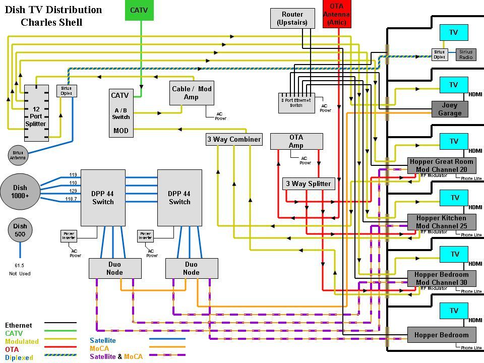

I use RG6 cable rated 3 gig everywhere. No RG59 cable, not even to TVs that do not have a STB. Yes, can you please attach your Hopper/Joey system schematics to your next post? Thanks for all your help.
4 hoppers requires two dishes
If you are hooking up 4 hoppers you would need 2 separate dishes or a switch. I would install 2 dishes because our switchs seems to have a lot of issues. They dont have a schematic for the 4 hopper system but I can look to see if I can find one with a switch and upload it for you send me your email.
No problem I have to find my book I think they gave me a schematic for more than two hoppers. If I find it I will send it to you
That's ok, I have seen them before unless you have real recent schematics. Here is my Dish Home wiring diagram. All Hoppers and Joey can see each other.
I just saw that same set up 10 room set up with 3 hoppers looks pretty close to the set up he had
