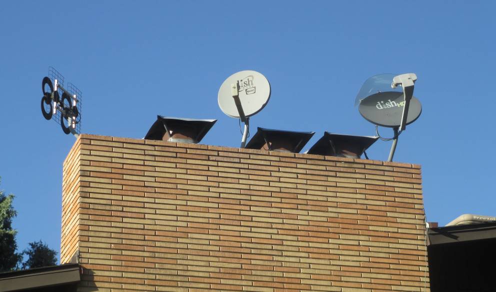

I love my two dish set up! Not 100% Rain/Snow Fade Free. But far better than a 1K2.

I put an umbrella above mine. Works like a brand new babe.
