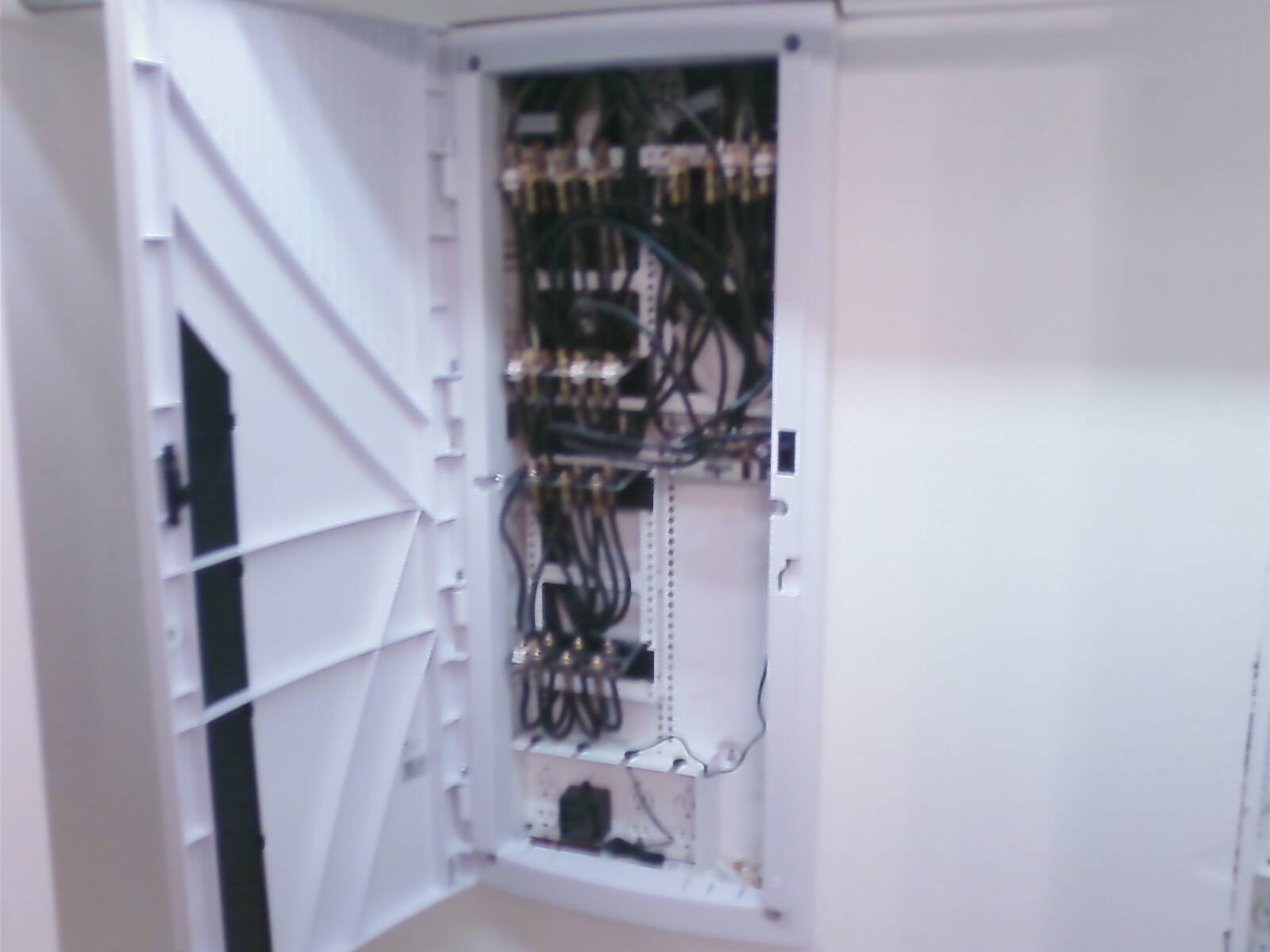

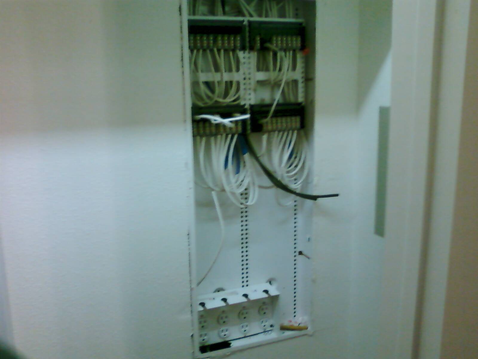

Here are some pics of 2 of my wiring cabinets. sorry they are a little blurry, but I distribute via rf and component video to 2 lcds and 4 tv's total. The main tv is connected via hdmi and I have a component video distribution cabinet in the next closet that sends the component out from the 722 to the other 2 lcds, but all the tv's are also connected via rg6 to the tv1 and tv 2 output of the 722. I normally run it in single mode unless kids or guests are here, then I switch to dual mode and have extra rf remote in each room.
I have been getting some interference from a new radio station the past month so I have used some of the cat 6 to send component video to the lcd in the master bedroom instead of the 5 rg6 cables that are also in the walls.
Wire is cheap to install in new construction so I usually go the overkill route, so I can deliver video by any means I want.
