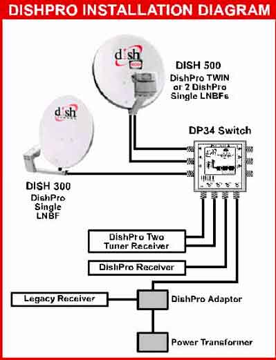

simple solution...
remove the cable from the 105 LNB that is in the switch and replace it with the 61.5 dish. Dish cleared off 105 of everything so your locals are probably on 110 right now
You dont need to use 105 anymore. Remove the DP21 switch and run the cable from the 61.5 dish into the port where the 105 cable was. Rerun check switch and you should be all set to go
otherwise hook the cable from 119 directly up (bypass the switches) and see if it shows a signal. If it doesn't then the dish got moved or the LNB went bad. Menu 6-1-1 lets you get into the install menu :)

I have moved the 61.5 to the 3/4 and rerun the switch test again noting from the 110 or 119 also direct conected first the 61.5 to make sure my conection did work and it did did the same for the other 2 and still nothing. I found an old analog meter and used with the following results.when set on the 61.5 it went to full scale with the db dial set at 2 on the other 2 had to move the dial to 1 to get a full reading. I just don't know if that is what it is supposed to do or not. Also when run the system info it keeps telling me no signal on any including the 61.5 yet I can receive about 14 channels several of which are foreign languages which I have not subscribed to. I have a dish 500 lnb left over from when I upgraded to get my locals a long time ago
so when you ran a cable from 61.5 to the receiver it gets signal but from 110 or 119 nothing?
honestly it sounds like the Dish got moved off kilter a little bit because it seems odd that BOTH 110 & 119 went bad when in a Superdish they're not molded together like a Twin LNB usually is.
On the D500 does the LNB say "DishPro" with a big DP? If so, you could use that
