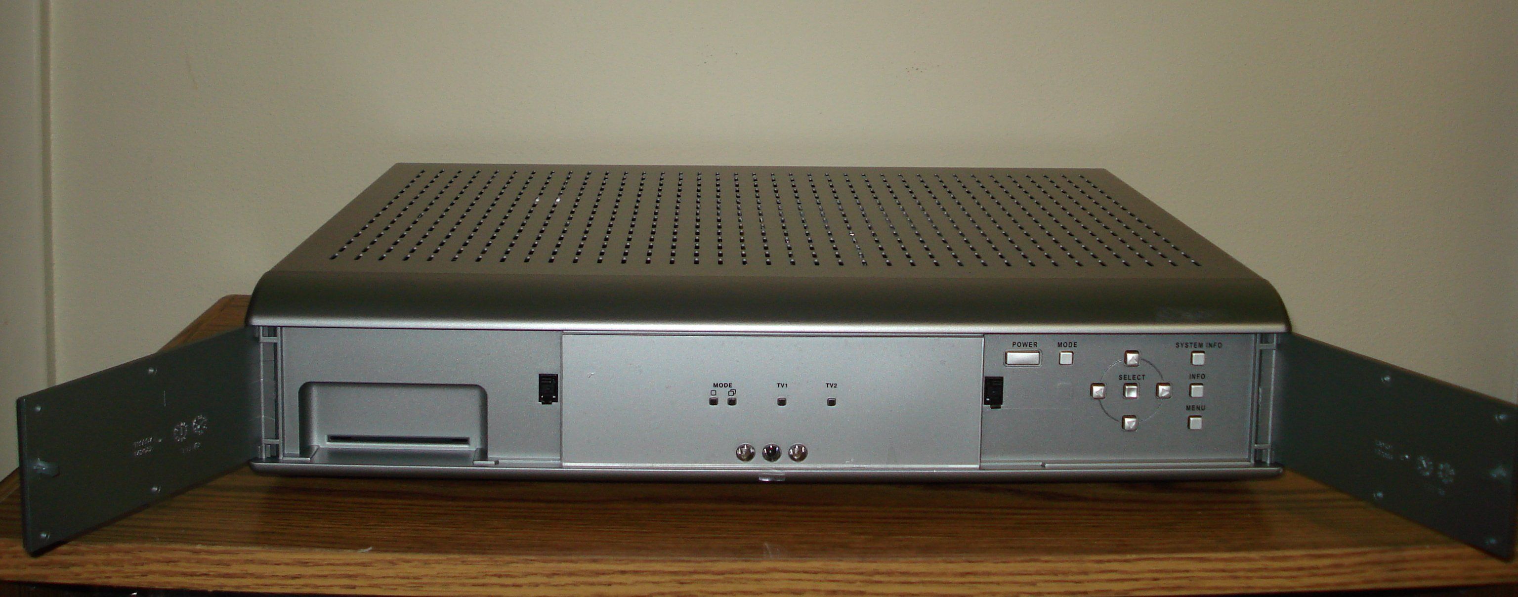

On the outside, the 222 looks similar to my ViP622 HD DVR. However, the most striking difference is the presence of a heavily ventilated top cover on the 222, while the 622 has a solid top cover. The exterior front panel of the 622 has a record LED for TV1 and TV2, whereas the 222 does not (as it is not a DVR... at least as of now). Behind the left door is the access card slot on both receivers. Behind the right door, the 622 has a front panel USB port among its controls, while the 222 does not.

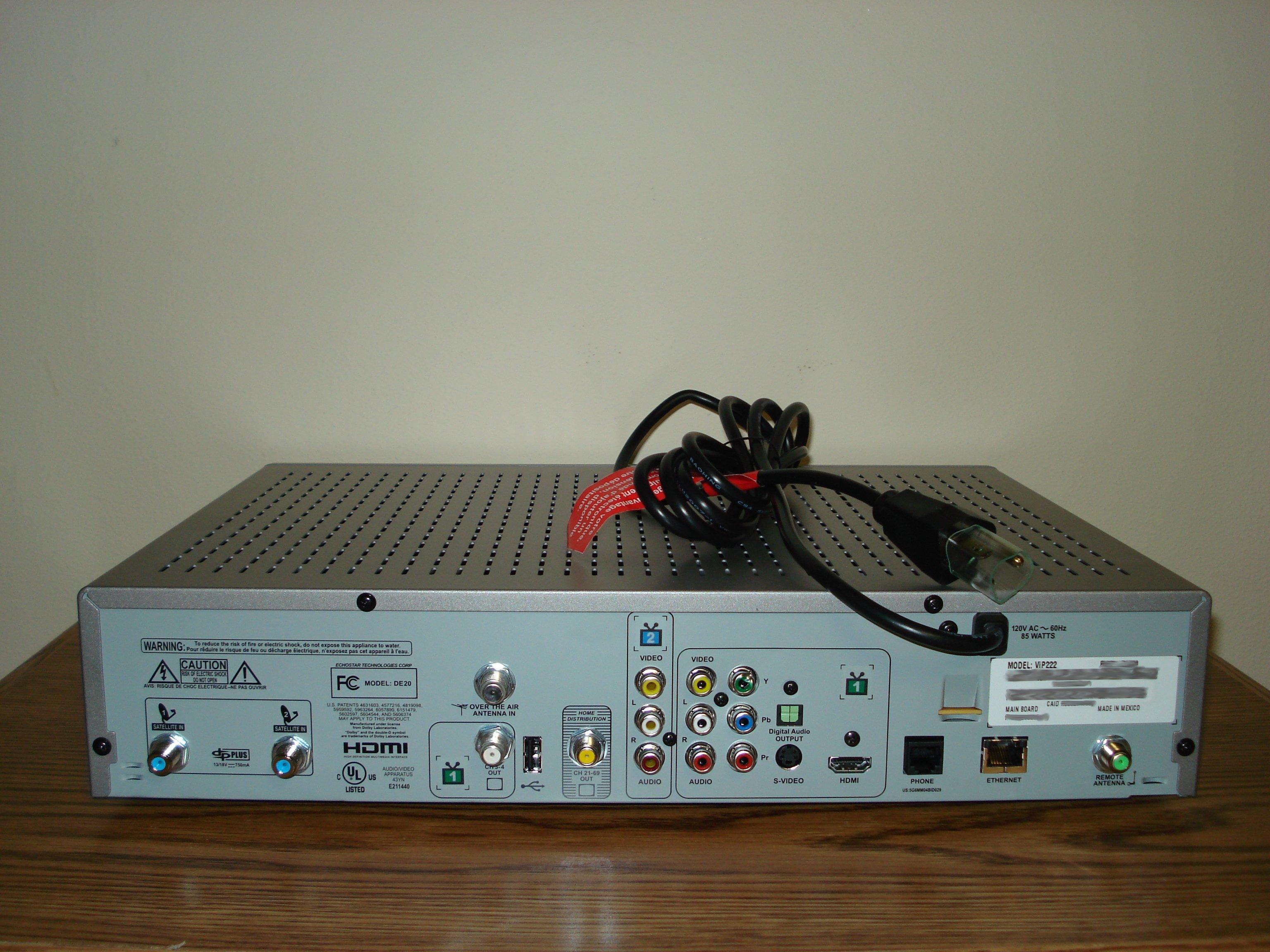

On the back panel, the two receivers are primarily the same. Some of the connections are in different places, but they both offer essentially the same collection of inputs and outputs. The only notable difference is that the 222 has an additional coax connection for TV1's output modulated to channel 3 or 4.
Images: (front) (back)

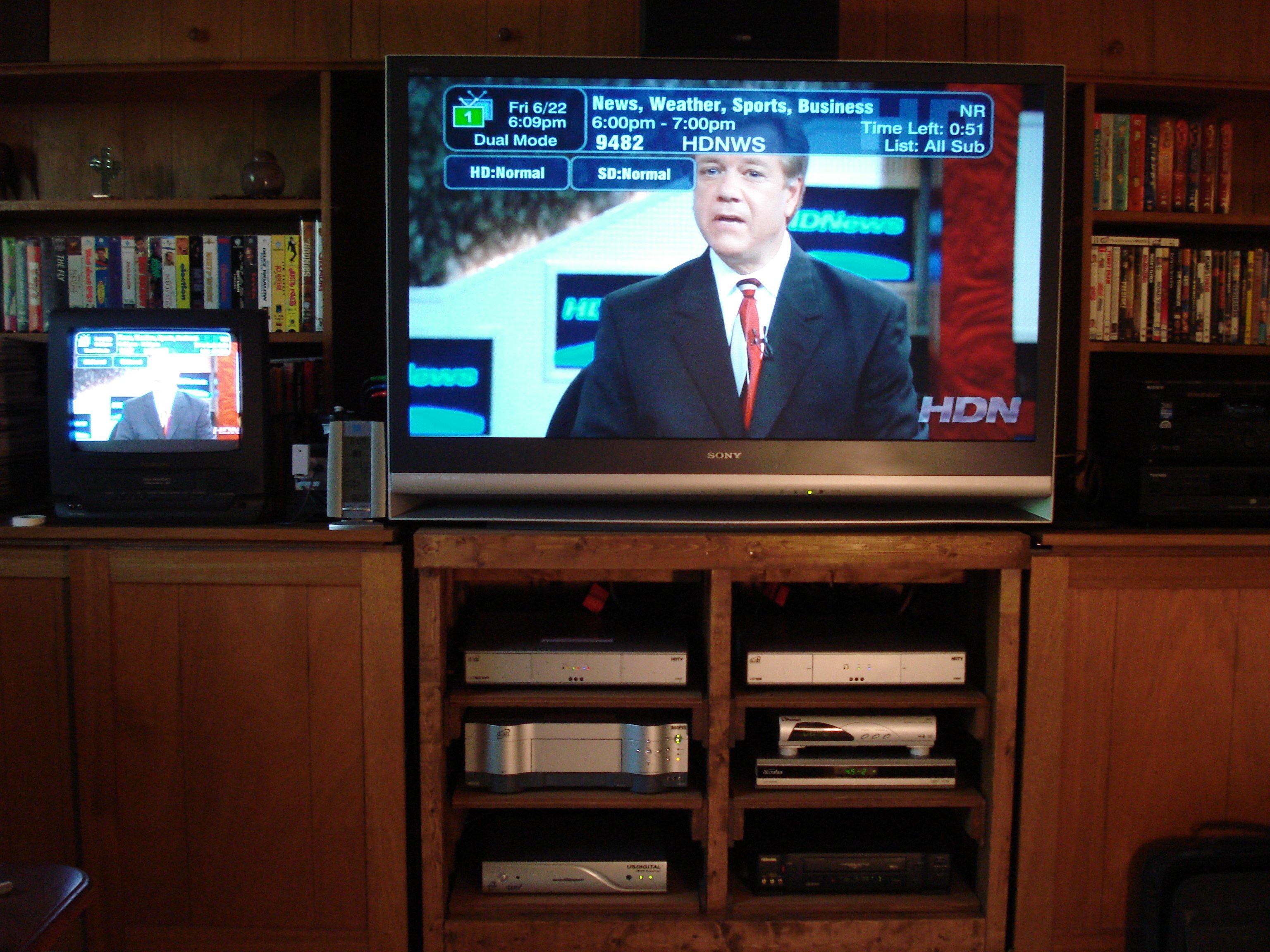

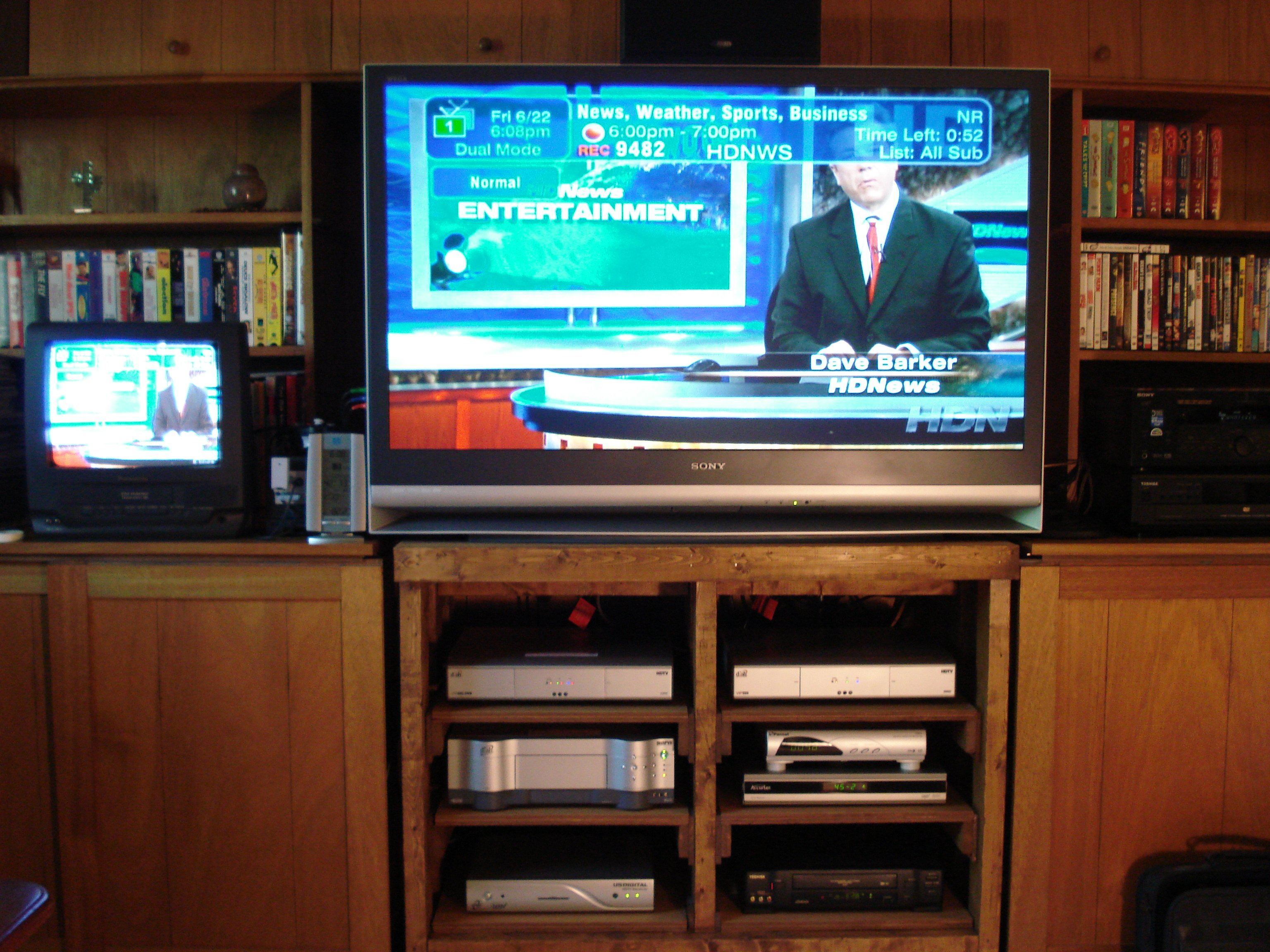

One nice functional improvement over the 622 is that the TV1 HD and SD outputs have independent format settings. On the 622, you can press the * button to cycle through the formats. The HD and SD outputs are set to the same format when doing so (and the SD output's 4:3 aspect ratio is not taken into account). However, on the 222, pressing * changes the output format of only the HD connections. Pressing Page Up has the same effect. The Page Down key, on the other hand, changes the format of the SD outputs (when viewing HD content). Unlike the 622, the 222 is aware of the 4:3 aspect ratio on its SD outputs.
Images: simultaneous display of HD & SD outputs: (222) (622)

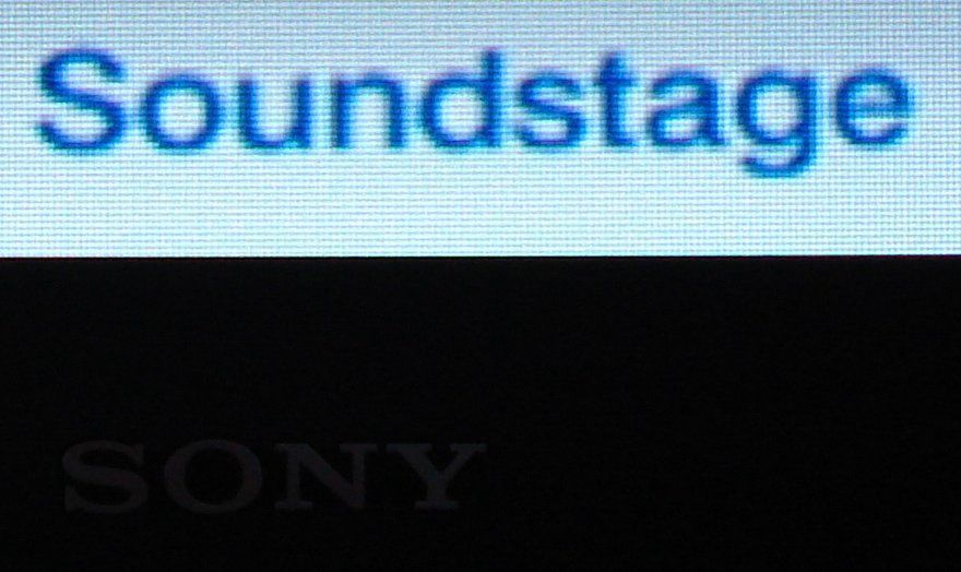

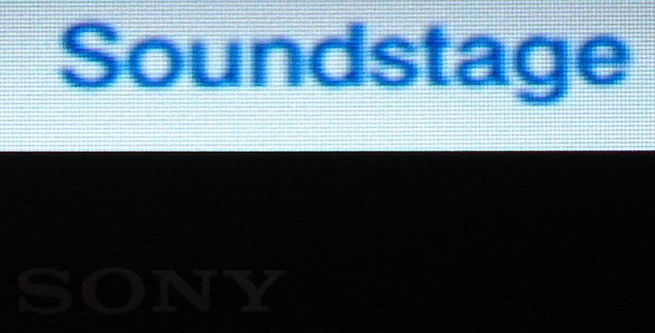

To evaluate the 222's HD picture quality, and for comparison with the 622, I tested using component and HDMI inputs on my Sony KDF-E50A10 50" LCD HDTV. After connecting the 222 via HDMI and the 622 via component, I then swapped connections and compared the results. The 222 actually has a slightly sharper image than the 622 in both cases. As a result, HD programming on the 622 appears a bit softer.
The difference in sharpness was a little more noticeable in the displays generated locally by the receivers--namely the guide, menus, and other on-screen displays. The guide on the 622 looks somewhat fuzzy, while the 222 guide display is quite sharp. Again, this is true "across the board" with my TV, with each receiver connected via HDMI and connected via component. And the result is the same regardless of the resolution, 720p vs. 1080i.
Images: close-up of guide text (222) (622)
