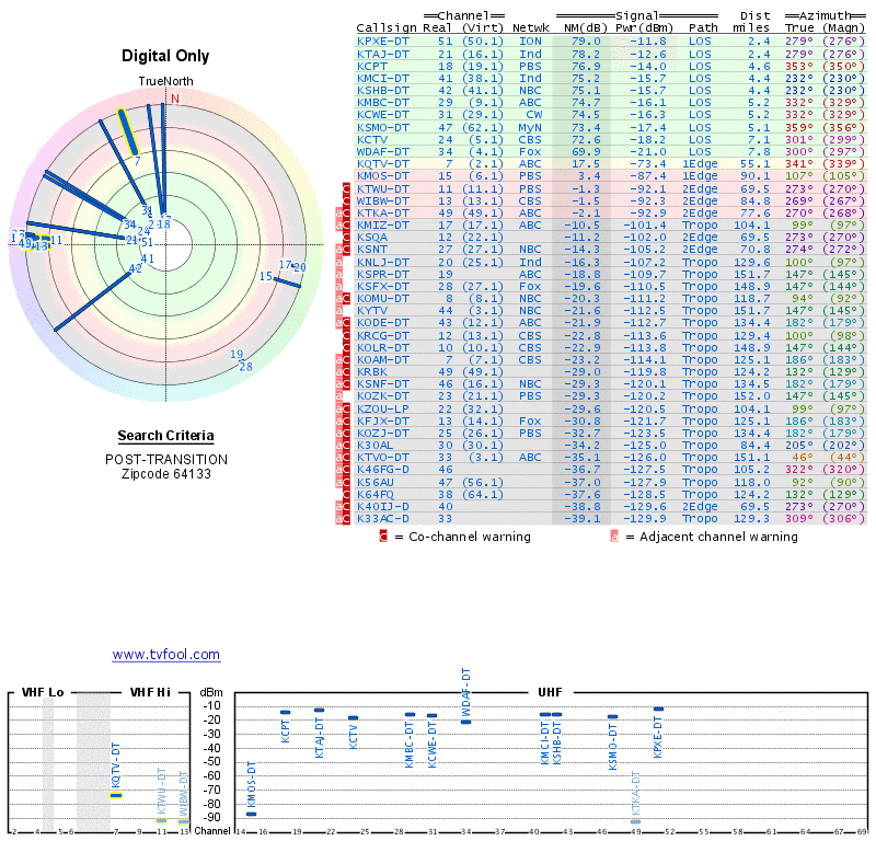

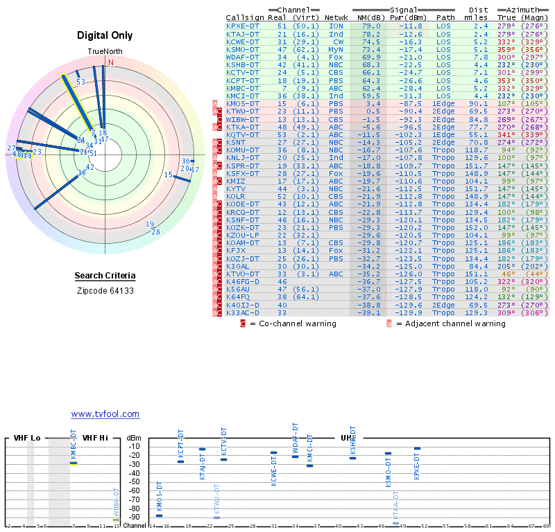

I have a pretty early-production 722 attached to a homebuilt clone of an Antennas Direct DB4 in the attic. According to TVFool.com, channels 34 and 42 are pretty close in distance and power output, but my 722 gets 100% signal from 34 most of the time, while 42 is pretty shaky at barely over 70%. If there's any wind at all, 42 will drop to 68% or lower, and the 722 puts up a message that the signal has been lost. More annoying than broken NBC OTA recordings (which is why I use the Sat HD feed) is that the "lost signal (OTA)" message gets wrongly interpreted as a "lost signal (129W)" message, interrupting WHATEVER I'm watching, live OR from the DVR.
Hopefully, when channel 42 shuts off the analog signal, the power will go up significantly, from 68.3/-22.5 to 75.1/-15.7, or am I reading the chart wrong? I'm not waiting for the FCC, though; I'm ordering a 722K as soon as I can. Plus, it comes with the spiffy 21.0 remote! :D
