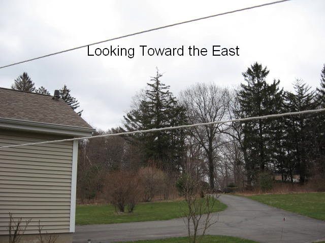

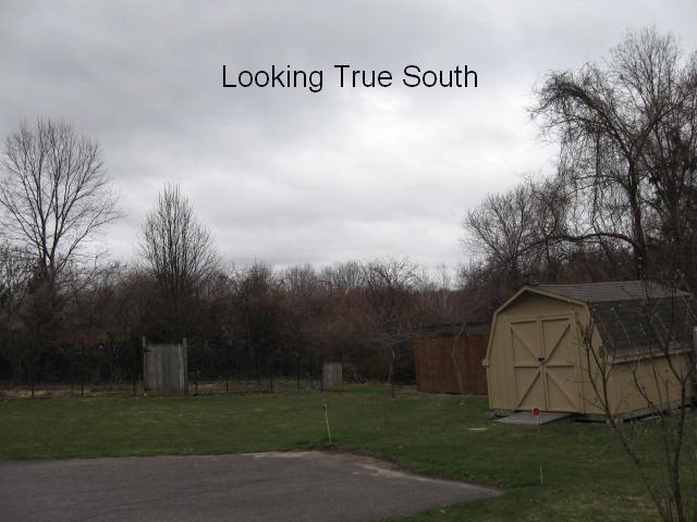

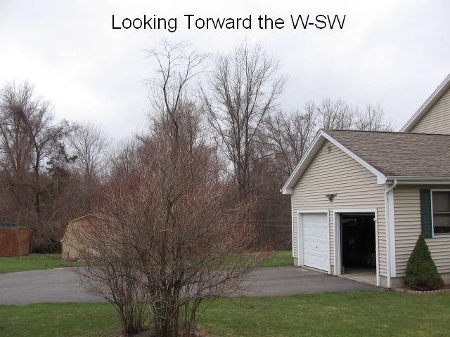

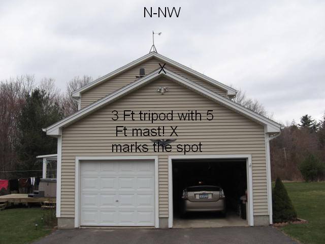

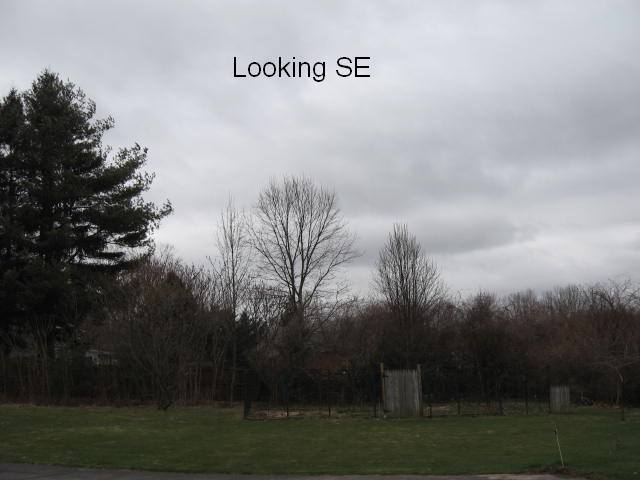

This is where im planning on putting my 36" disk for my new SatHawk receiver which is on order.Let me know what you think about the location and if i may have any problems with the satellites.I dont wish to go up on the roof of the main house so i think the location i picked is best choice i can think of.The pic i took of True south was just under where the disk will go.
Update!! The dish will be motorized.

If you place it somewhere on the ground it will be easier to get to to make adjustments.
Perhaps if you do a temp mast on the driveway and work out any issues, then move it on the roof.
Are you going to use a motor?

Hi StanleyJohn and the group, I love the pictures. Looks like it may work for you but I would advise checking a few things. First it looks like you may be located in CT so your elevation is going to be quite low. I would recommend making a simple soda straw inclinometer and check the clearance over the trees. Make a list of the satellites you are most interesting in receiving and get the elevation and azimuth for each and then check from the proposed dish mounting location and make sure nothing is in the way. Perhaps a lower poll/ground mounted dish could get most of the satellites. A second poll/ground mounted dish could be set on the other side of the yard to receive the other end of the arc. Your roof looks like it has too much pitch to be able to safely work from it so the dish would have to be worked on from a ladder. And with the snow you get up there it sure would be worth the effort to try and see if any low ground spots could work. If the roof spot is the only workable spot and you are comfortable on a ladder I would say go for it. Later, DC
Thanks for the info DC! I just made a home made elevation view finder with a protractor,some string a straw and weight and i took some measurements and it looks good i think!.I was alittle worried that maybe i would have a problem getting AMC9 for RTV and it looks good.If you look at my true south picture follow middle of the closest shed straight up beyond the top of the pic about 1" and thats where it should be.worst case was my closest tall tree and a sat would need to be less than 48 deg for a problem.My average take was around 25 degrees of no blockage with my best area being plus and minus 20 deg from true south where in can get around 10 to 15 without bloakage.These readings would be not as good but still ok at ground level but why risk missing a few satellites.The garage roof may look alittle steep but really isnt a problem unless something breaks down in the winter.Im really new at this but am a quick learner!i really dont know whats what yet for satellites up the sky but hoping to have fun finding out.PS i wonder how the canadians do it with so much of canada with lots of trees and much father north than we are.
