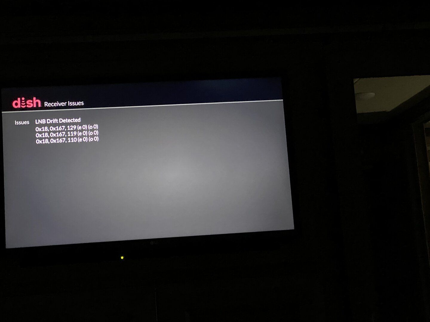

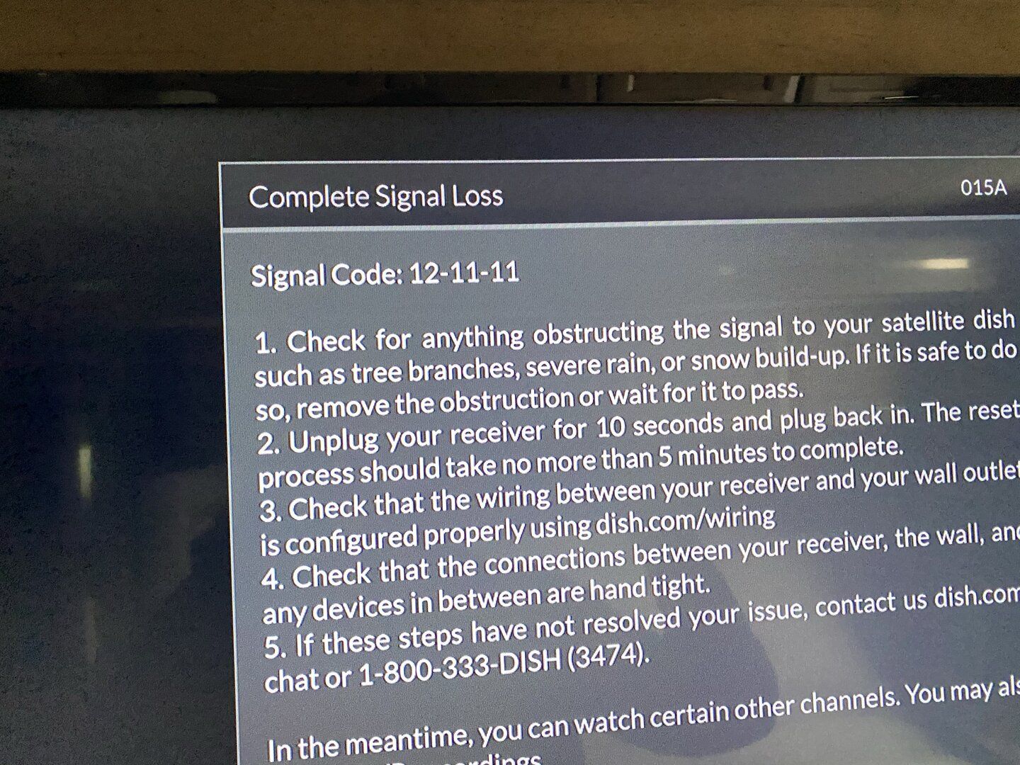

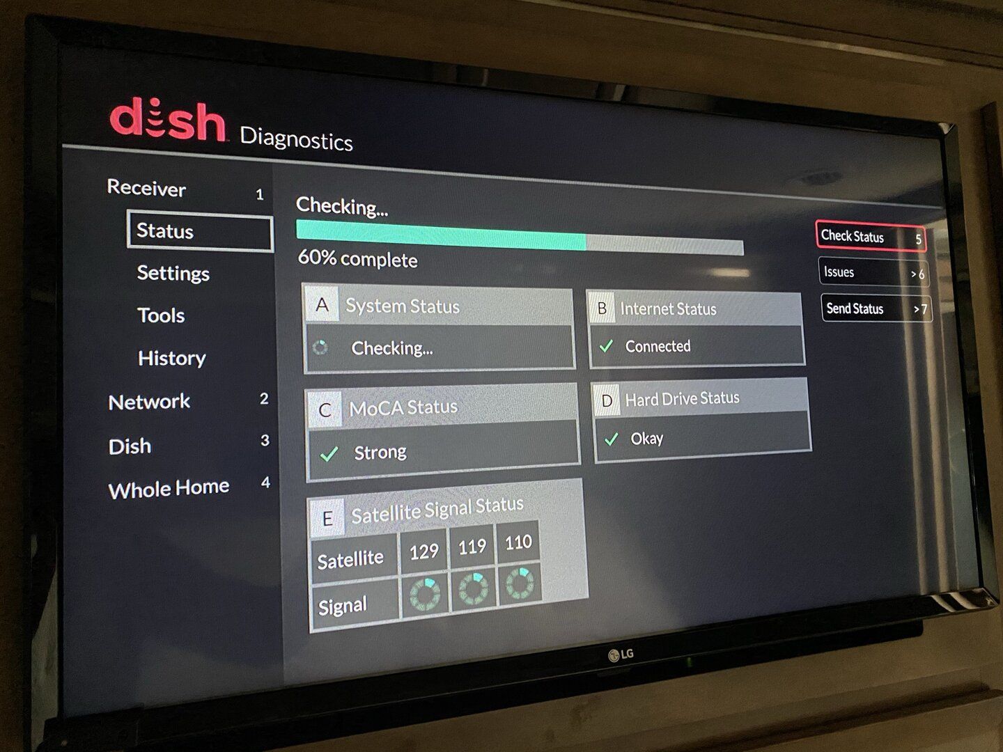

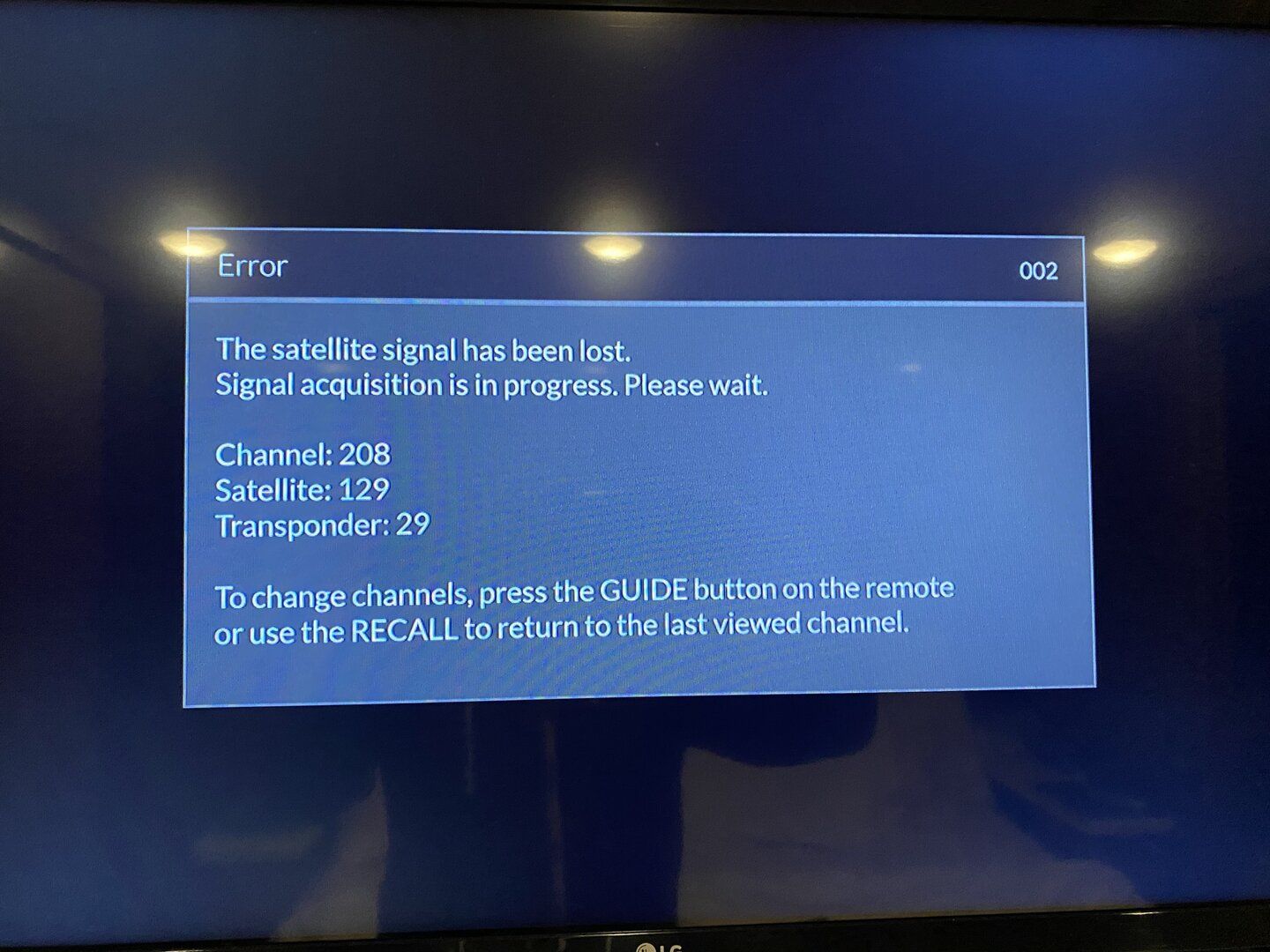

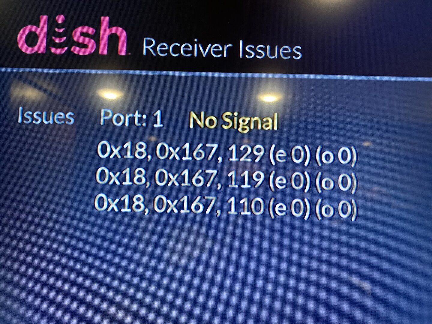

If anyone has any thought on the original post and if swapping those two parts mentioned would be good or work would love to hear. Do you think this is the best solution? In addition to some HD channels not working, I get a lot of these types of errors until I reboot the Hopper after we power up everything.
Thanks and much appreciated!
