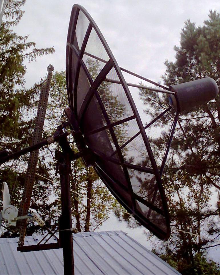

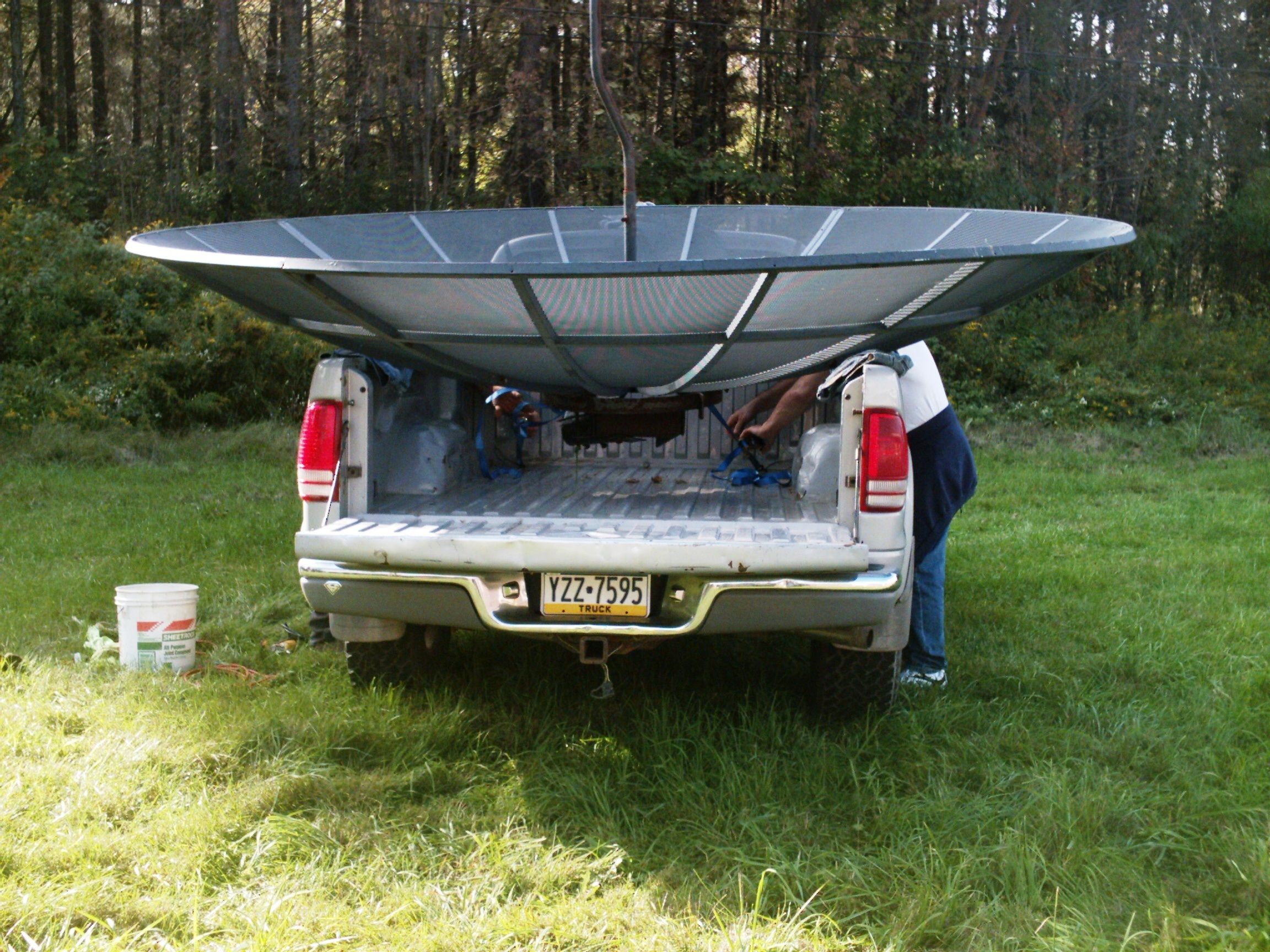

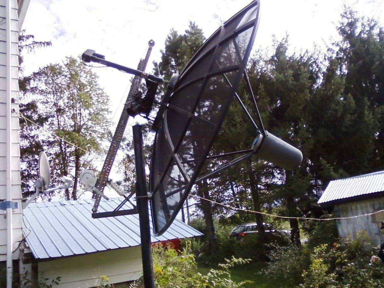

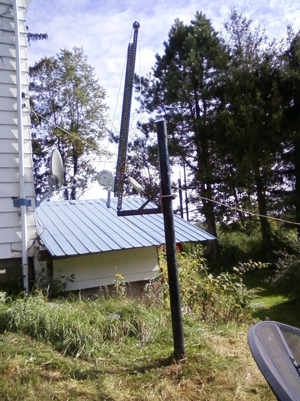

I followed directions from post 3 . Tvro's lifter is a marvelous thing, it made this job extremely simple.
This is not the 22 ft tall dish, but it was last- yesterdays- Saturday acquisition. good practice run for the big one.
Its funny, i seem to have fallen backwards into BUDS this month. I have to go get a monster fibreglass dish roughy 12 ft and the 22 ft tall 10fter one still. this dish is only 8ft unimesh, i think, well 92 incher
The weight of the dishlifter is a consideration. Got heavy on me.

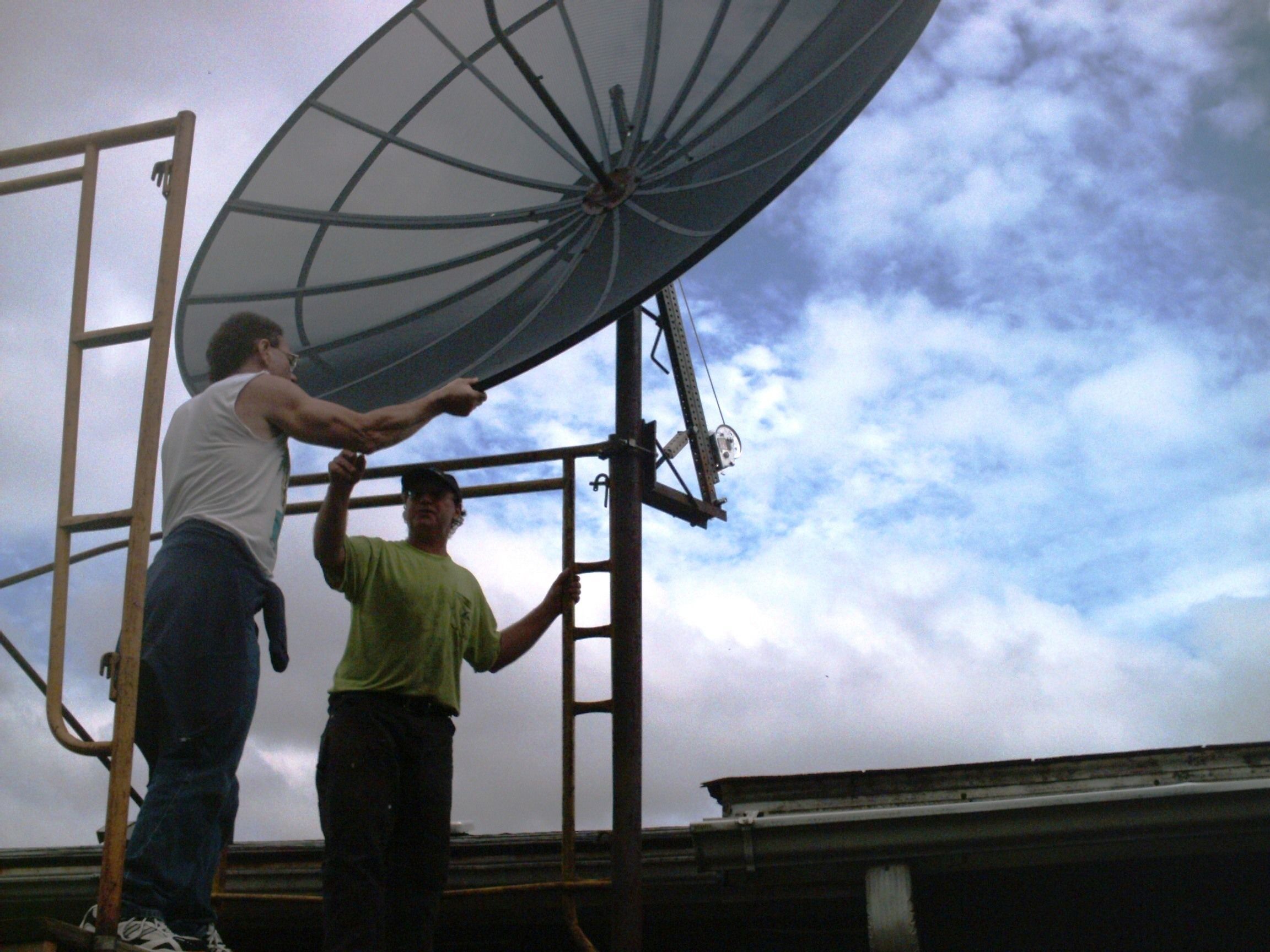

In order to connect the cable to the dish, i actually climbed up the dishlifter itself to connect the cable as high on the dish mount as i could.
I have pics although they were not as clear as i wanted, they do show the various sequential positions. I omitted the one that made me look like a monkey.
it was fun!! Although some lady who had a bit much to drink did wreck her car right after driving past me...:eek: Cops had to come to get her cause she wouldnt leave her car without her cellphone...

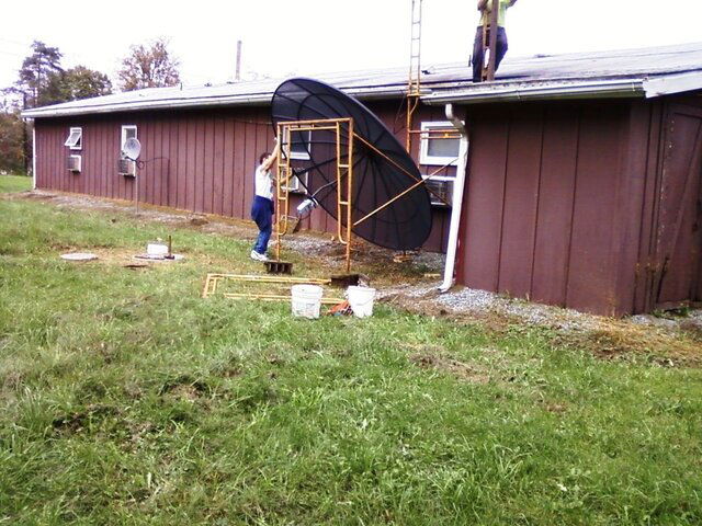

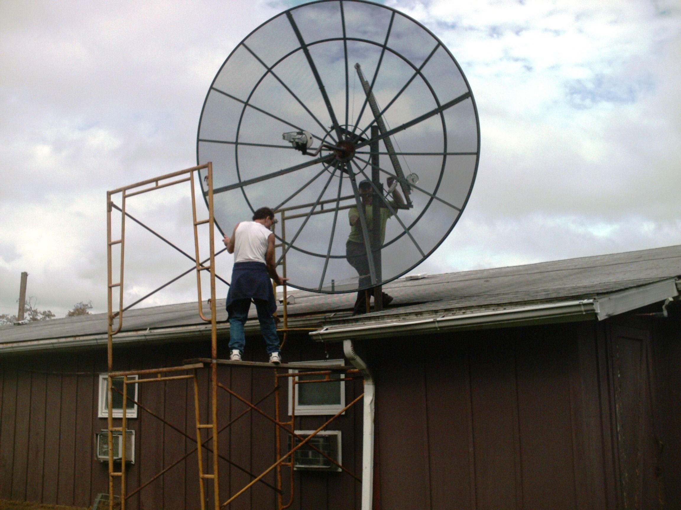

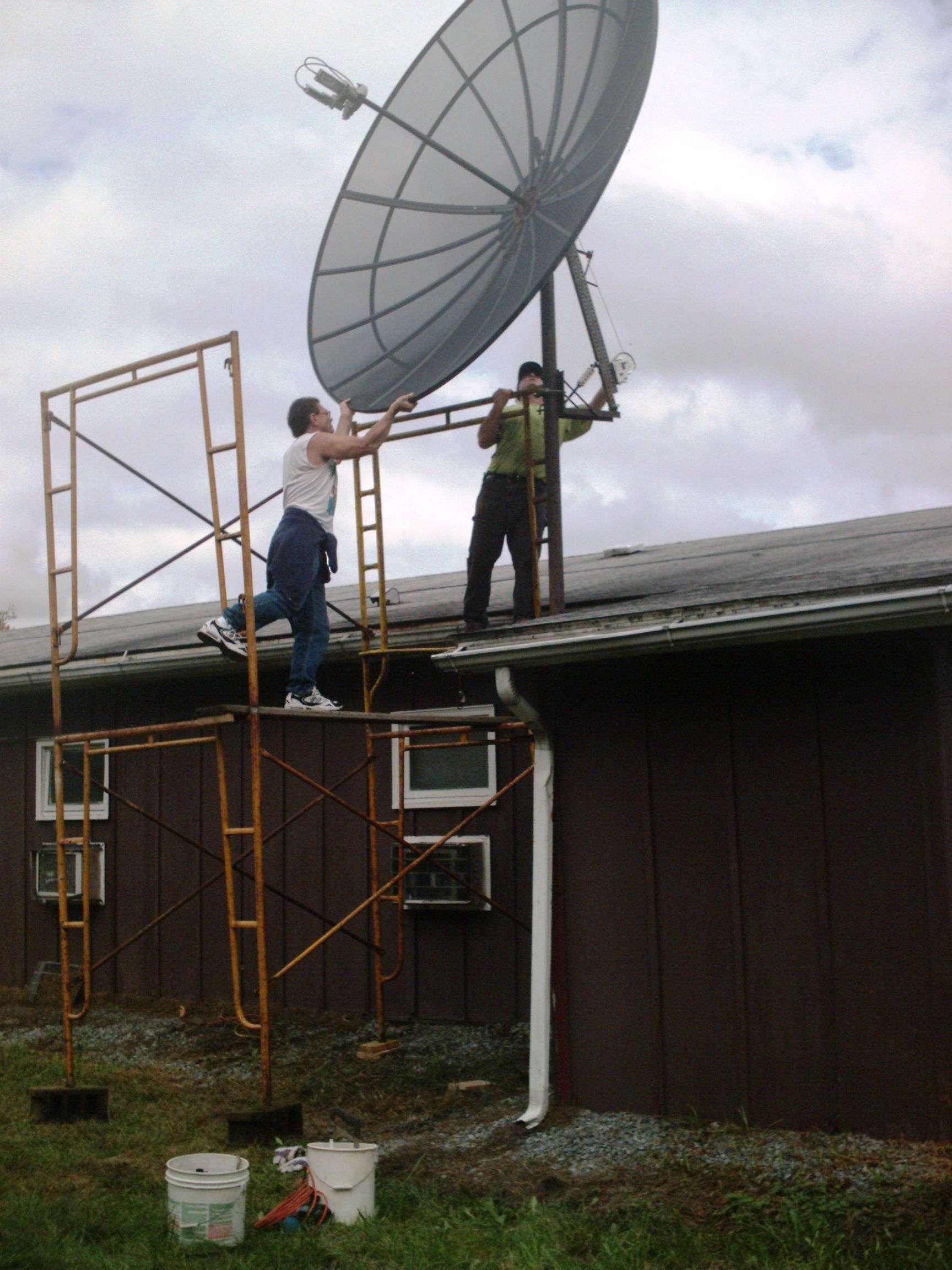

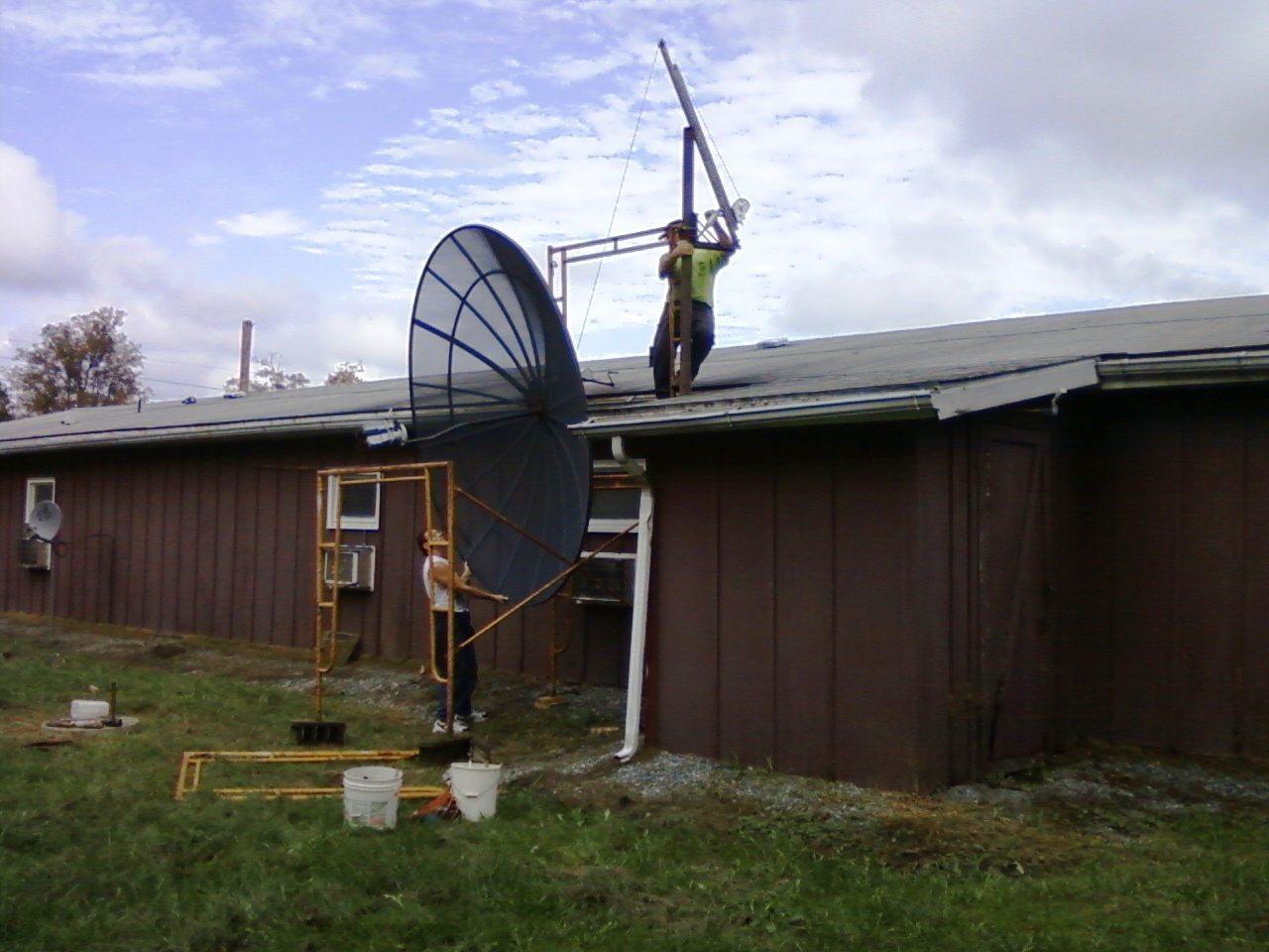

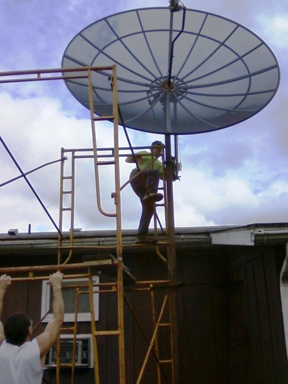

Turns out the dish was not 20ft up but still higher then i preferred. Was still tricky even with scaffolding as the owner did not want me to stand on his roof. I have sort of step by step pics. Dishlifter paid for itself today (all $20)
I am not doing anything like that again.
TVRO, you are a better man then I!
I used an assistant for the project! I have a large solid to get still, but is low to the ground. the pole that the solid is on looks like its about 10" around, huge , LOL!

Looks good glad the lifter worked for you on the higher ones like that i would set up a 24 ft extension ladder behind the dish tie it to pole if it was not near a roof to stand on the problem always was getting the lifter up ladder and bolted around pole push it up mount so it was high enough to do the lift. Once it was set up the lift was fairly easy as long as you had a helper to guide dish down.
