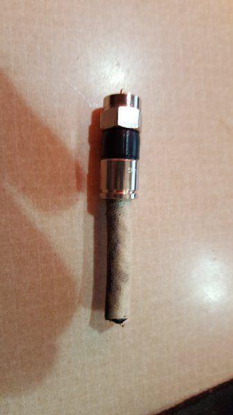

HI all, my cousin was going to switch over from Dishnetwork to Suddenlink aka SuddenCrap for TV service and SuddenCrap worked fine for about 5 minutes then it just went to a black screen with some error code in which after 2hrs+ on the phone with them they finally figured out that their reciever wasnt properly set up with the programming package they ordered and that they could have a guy out the next day to fix it and well that never happened not even a phone call saying they couldnt make it. Now they say it wont happen untill 2 days after Thanksgiving which is now unacceptable because we have no TV. Their installer apparently didnt want to install a new coax line going to the TV so he used the existing Dishnetwork line going to the TV. I can see where he cut one of the Dishnetwork lines so he could tap into the line going to the tv. The reciever is a Dishnetwork VIP 211Z, the dish on the roof is a Dishnetowrk HD dish with 3 LNB`s. with only 1 TV hooked up. My cousin cant really afford to pay a Dishnetwork installer $100 to come out and fix it so I`m trying to figure what the Suddenlink installer changed on the Dishnetwork line that according to Suddenlink`s customer service they dont touch other company`s lines or equipment. Any help would be greatly appreciated. Also took a few pics of what I`m working with if that will help.

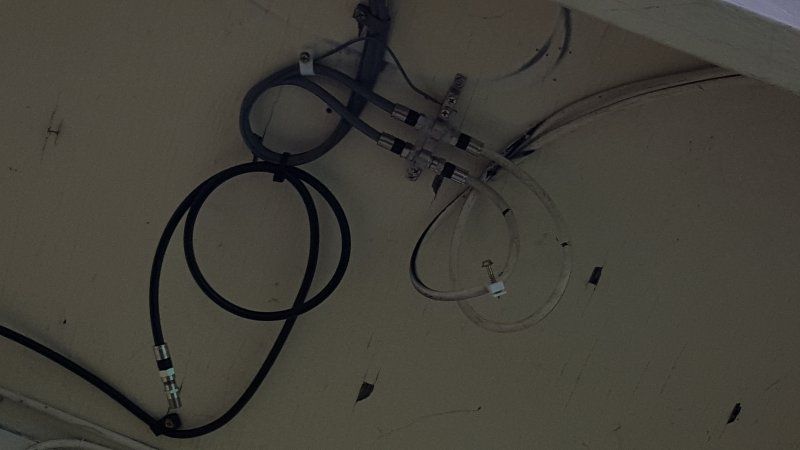

The only picture that matters (of the multiple posts of each picture) is the one that shows the grounding block. It almost looks as though someone has already hooked up the dish and left the Suddenlink cable hanging.
If the configuration no longer looks like the picture, you would just need to make it look like the picture by connecting the painted cables to the ground block. It looks like siamese cables coming from the dish go in on the left side and the painted cables carry the signal into the house. The only reason I can think of for whacking the cable is so that you can't reach the ground block to reconnect. This is considered vandalism in many jurisdictions.
2 lines are coming from the dish, they both do the same thing. Connect the line going to the TV to one of the lines coming from the Dish at the ground block, if it'll still reach
Thanks for the replys guys. My cousin got lucky with Dishnetwork their going to send a guy out today to fix what Suddenlink screwed up for free. According to Suddenlink their installers dont touch any lines or equipment that other providers have installed which in our case was a total load of crap, I told the support lady with Suddenlink thats not the case here. Their installer didnt want to move or ask us to move a refrigerator in the garage to run a new line to their box through the wall. The pic of the cut line was one of the two lines that the Suddenlink installer cut. I know for a fact that it was hooked up because a few months ago Dish sent a guy out to realign the dish and put new connections on because it was losing signal intermittently he also said that he shot some silicone over the connections because the old ones looked corroded. The cut line had silicone on it before I disconnected it. I tried hooking one line back up but it did nothing no signal to the Dish reciever didnt think of trying the other line at the time.

Well it only took the Dish guy about 3 minutes to figure it out. It turns out that I did get it hooked back up correctly but the picture on the TV showed the no sat signal screen and when you try to exit it it wouldnt do anything. He noticed that the lights on the Dish remote werent lighting up when you pushed a button, the batteries were dead. Once new batteries were put in he exited the Dish screen and the TV went straight to a college basketball game. I really wish we could get a different internet provider here and avoid Sudden Link like the plague. Unfortunately where we live its either Sudden Link or satelite which is pricey.
