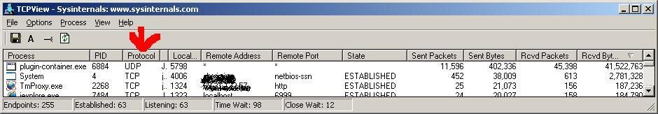

The stream is definately UDP when I connect from the office using firefox.

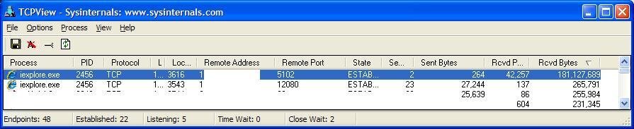

Well it got even *more* interesting.. Firefox for me did UDP ... But IE is does TCP
iexplore.exe 2456 TCP X.va.comcast.net. 3396 X 5102 ESTABLISHED 2 264 22,114 93,985,489
also IE works with DishOnline for me to start DVR events ... Live TV is all that I could get to display regularly in Firefox.
IE ...

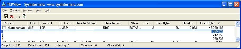

AHhhhh .. but then after I stopped IE, started FF ... It came up as TCP again ... so ... *it* couldn't do UDP the second time .. defaulted back to TCP which is the more reliable protocol
FF
