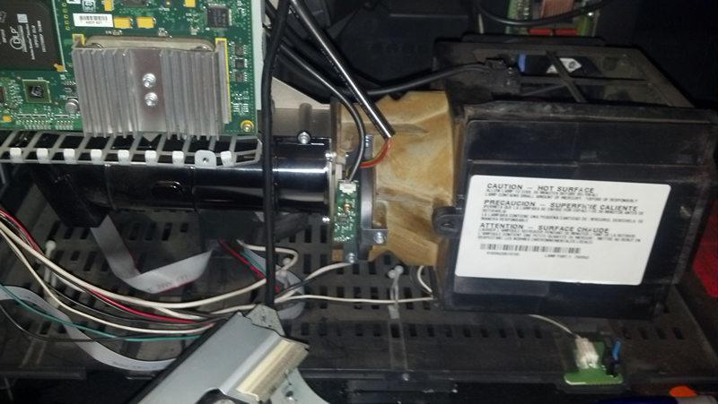

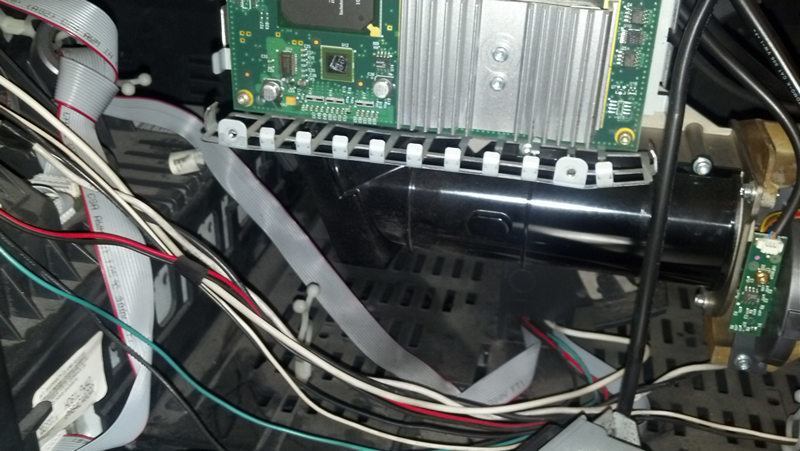

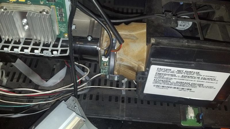

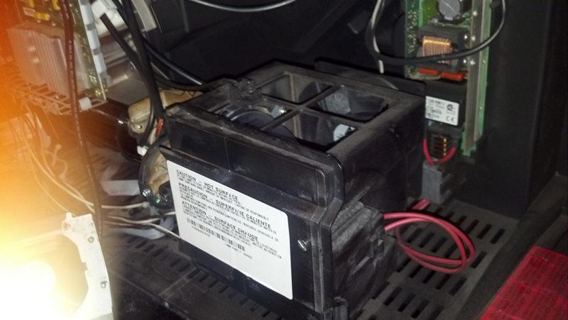

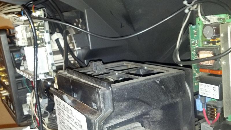

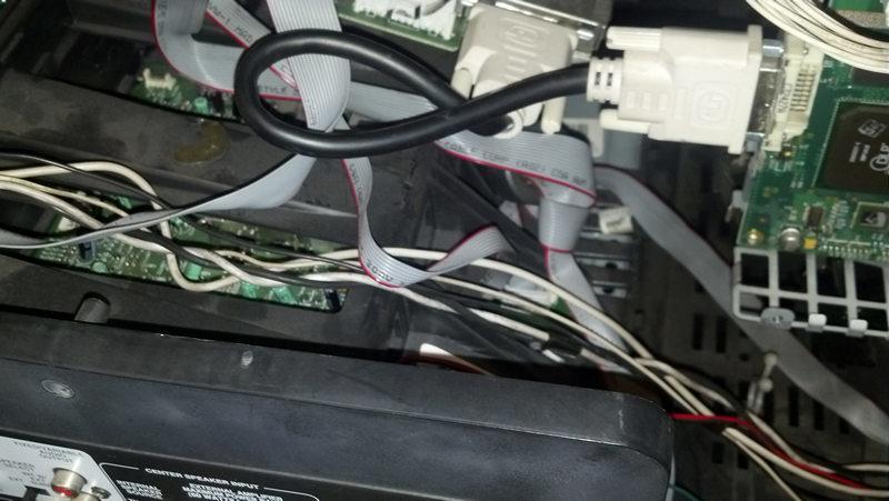

Well I took it apart to clean it and it was dirty, but when I put the light back in and turned it on i noticed neither of the fans, the one below the DLP chip and the one in the lamp enclosure, were turning on. Don't think its the power supply as the color wheel was spinning. I did a search and some said if the fan is dead the lamp wont turn on. The lamp did not look dead, the other times it died the filament broke or was black, the lamp looks fine, plus it has not been used in awhile. The last time i tried to turn it on I got a picture but after about a minute it went black, and the picture kept coming on and off. That was around the Superbowl. This time the lamp never turned on and the power button blinked 5times and then it turned it self off. Anyway, I will think about investing more money into this thing, i found the fan online for $7 at one place and $20 at another, did not check the shipping cost. The lamp has come way down in price, i saw most places had it for about $70. I just don't want to put more money into it if its something else that is wrong, like the light engine. That was replaced once before by BB.

looking more at the inside, i think its a design issue with the tv itself. I mean they have the fan blowing the hot air out of the lamp right into the inside of the tv instead of through the sides where the vents are. no wonder it always overheats. Anyway, I tried to take the fan out but the whole enclosure is screwed in tight and could not get it out, the easiest way would be to just remove the box where it attaches the light gun but the screws for it and fan are in the back and hard to reach, got my torx screw in there but could not loosen it. Just taken the model number of the fan to a local shop and see if they have it, and then get a friend that does tv repair to take a shot at it.
