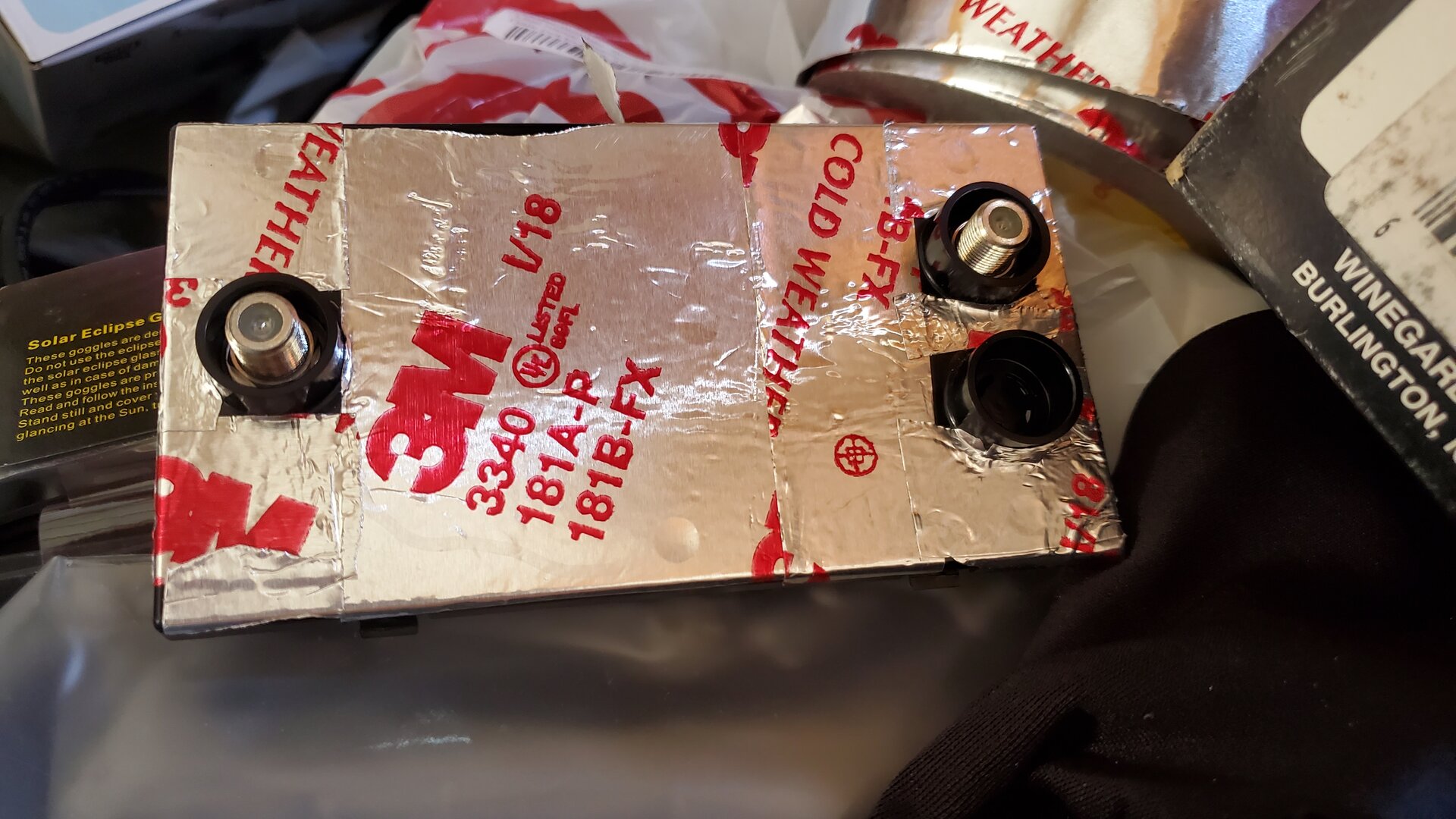

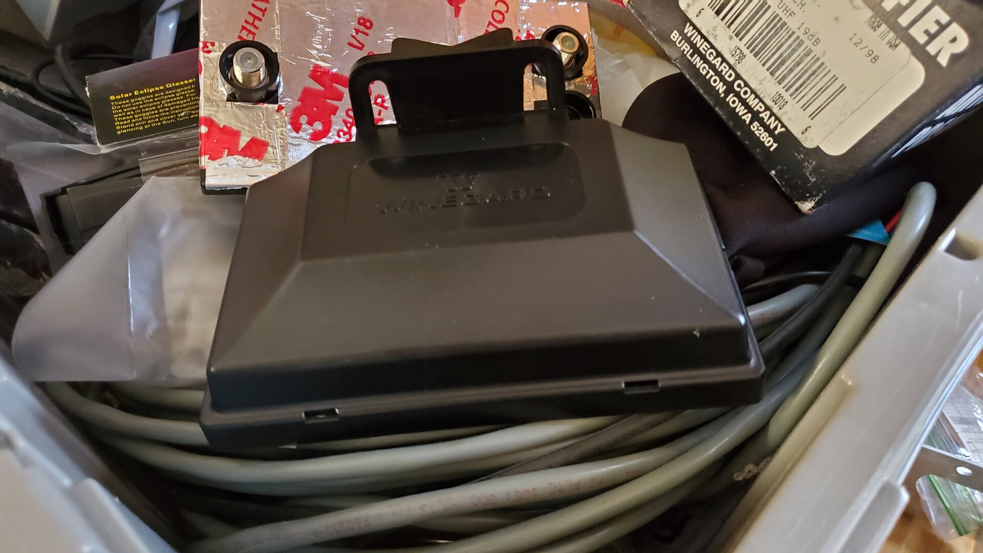

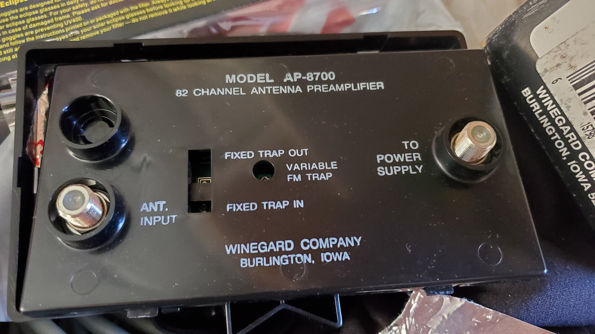

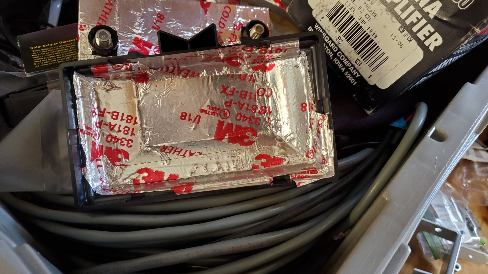

I'm glad that Televes is available for us OTA peeps now. I had been using older Winegards that had not let me down but definitely were designed for a different time. I even used HVAC foil tape to "shield" one Winegard AP-8700 preamp
