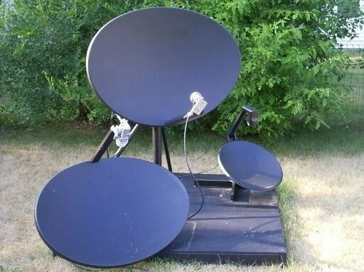

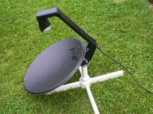

That may help, but would have to go on top of the chimney maybe, the extra few feet in height may also help !
It will also reduce the wind load, this can be as bad as rain fade sometimes on a roof!
